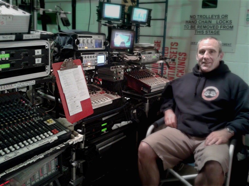

Wow,i am so honoured at this warm welcome to your community Jeff and the kind words by the members who have posted.
The film truly was a labour of love.Extremely challenging yet from the outset the challenge was inspiring.
I am busy on location on The Counselor,shooting 4 cameras but i will try and write some more posts soon about Les Miserables but for now i thought you guys would enjoy this picture.This picture does not include any of the protools/music dept rig and just features the Production Sound equipment we used every day on Les Miserables.
Posted Image

Tonight's sound dream is to figure the how and why of all this image represents.

O M G (as the young people text) --- what an incredible line up of equipment, multiple carts, so many things to do everyday...
and you're smiling, I think!

No computers in sight! (Yay!)

Seeing Simon amongst all his gear for Les Miserables made me think back to all the gear we had on the UK end of Heavens Gate.
Seven thousand watts of playback, An induction loop that was half a mile long with fifty five earpieces and fifteen radio mics, and this was in the early 80's.

"London Calling", I'll be there for that film if it ever gets made.
@ Simon, as impressive as all the gear is, I am most impressed that you are dressed like a SoCal sound mixer.
