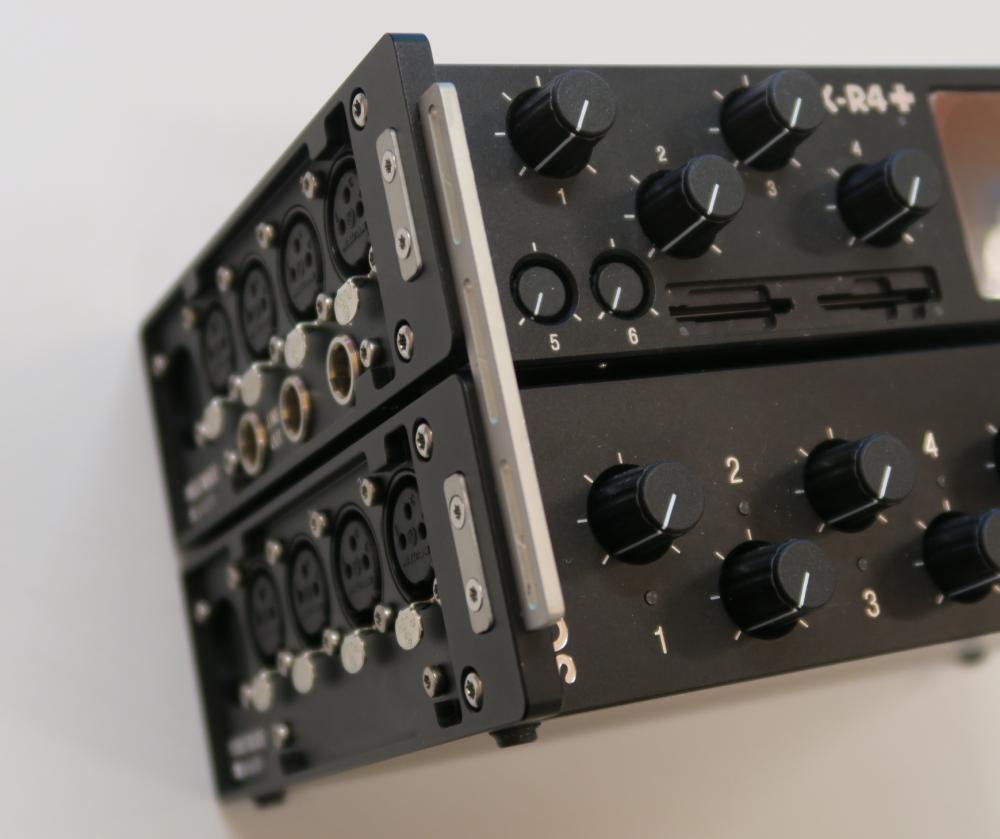

Hello to all,
Here, a simple way to attach the SONOSAX SX-R4+ with the AD8+ or the RC8+. This set is available now.

The brackets look dead cool. Any chance to make them in black?
v3 soft is excellent. nice limiters - thankyou for these ;-)

Does it have to be steel? Aluminum, anodized will do the job well, maybe with steel threaded inserts for the screws! After all, it is not to hold up a huge weight, considering the mass of these units being put together...
