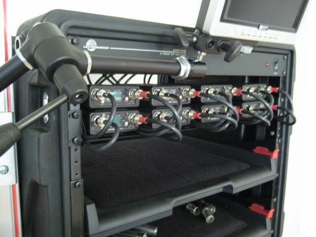

Is there a way to combine 2 x Lectro rack mount units (UMC200 or UMCWB) for use with a single pair of antennas?
Alternatively I suppose the Six Pack would be an alternative..
Also I have seen a few UMC16B rackmount multicouplers going.. if I can creatively mount my receivers on the cart  that would enable up to 8 x 411.. would be quite a big and chunky setup though! See Paul Graffs rig from some years back below..
And Thanks Jonathan ML for those figures on the filters!

Hey Robert, thanks for your thoughts.. I impulsively just bought a Lectro UMC16A (block 21/22) off of the auction site. Will add 2 more 411's and stick with this for a while I think. It might be a bit bulky by modern standards but performance should be great and I keeps most of my system unchanged for now. Now to save for the PSC Solice mini!
