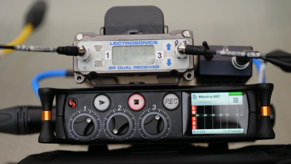

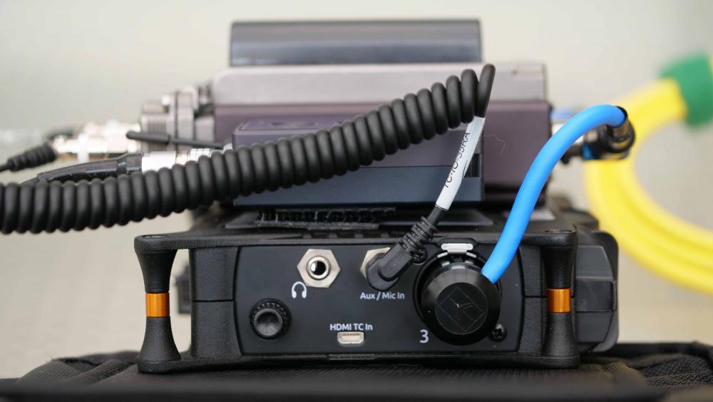

MixPre 3 setup
I got the MixPre 3 for small jobs and wanted a fixed setup.
An SRb with battery sled is attached to the top via the 1/4 inch MixPre3 screw. The leads have Remote Audio right angle XLRs going into the MixPre 3 inputs 1 and 3 and Lectro Ratpac right angle TA3s coming out of the SRb. Input 2 is used for boom or other wired mic. An Ambient NanoLockit is velcroed next to the SRb. The whole thing fits neatly into a ThinkTank Wireless bag that fits on my belt. Works pretty well on a couple of jobs I have done.

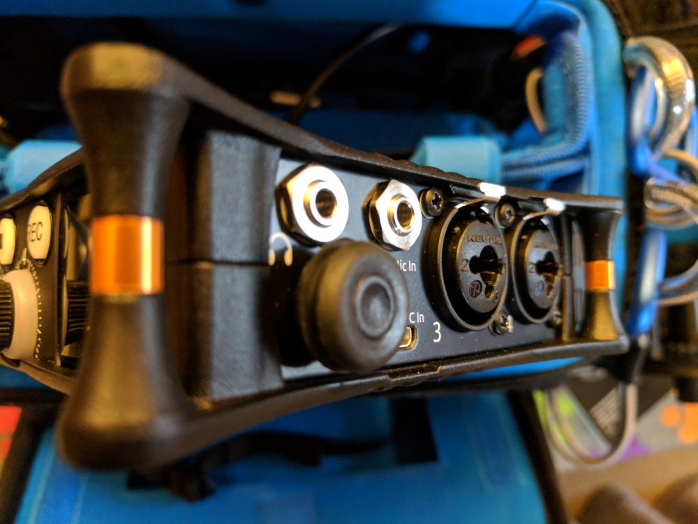

From the "I can't believe it took me this long to think of this" department:
Found a rubber grommet that fits the encoder shaft- now I can turn the encoder with one finger. There's enough clearance underneath to push the encoder in.

Hi Allen,
Thanks for your rubber grommet tip - very cool. Will hit Home Depot to get one for my MixPre 10T.
Nice!
Do you remember the size of the grommet that fits?
-Mike
Share this post
Link to post
Share on other sites
3 minutes ago, Mobilemike said:
Nice!
-Mike
Looks roughly like a 1/4" inner diameter. I really should buy those digital calipers…

MixPre 3 setup
Very nice!
Share this post

MixPre 3 setup
Very nice! Gotta say I'm tempted to pick one up myself for an ultra light rig...
