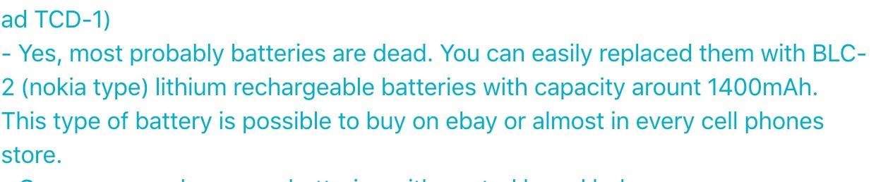

A kind member sent me this excerpt from communication to Betso about the identical problem. I had a look behind the label, and yes the advice is correct, that these are cell phone batteries that must be 1400 mah. I only found stock on these batteries in Europe. The also have to soldered to the PC board. The Betso is generally a solid product, but (i) it is a firmware mistake to have the unit default to needing the built-in batteries to work before accepting ext power, (ii) not having an easily replaceable battery pack with a connector that they could sell that any normal tech person could switch out easily. Thanks to all responders you were amazing help in solving this.

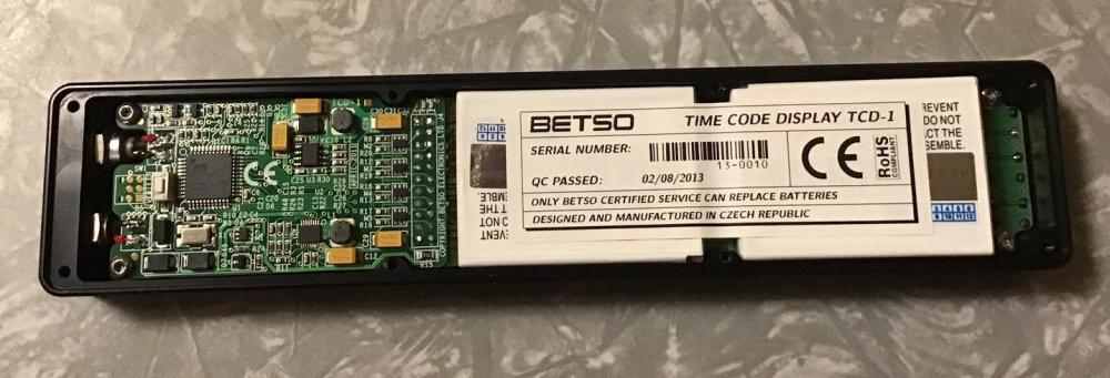

Thanks for the quick response. That was my fear. I opened the unit and the battery back is not a common type to me. Have you replaced your own batteries in the past? RL
Hi all, Just received a new old-stock Betso TCD-1. Attached it to a fresh vmount lithium battery and provided it with TC from time code buddy minitrx+. When I try to turn it on, it simply states battery low and turns off. https://www.dropbox.com/s/9dxfkjhj05837y3/IMG_0018.MOV?dl=0 I cannot get into the menus to change any setting and the internal battery is not charging. Anyone have any experience with this problem? Thanks Richard Disclaimer for the usual suspects, yes I have read the manual, yes I tried calling the manufacturer (no answer), yes I have tried to google prior entries on this topic both on and outside the platform. Please spare everyone the repetition of any part of the RTFM liturgy here ..
