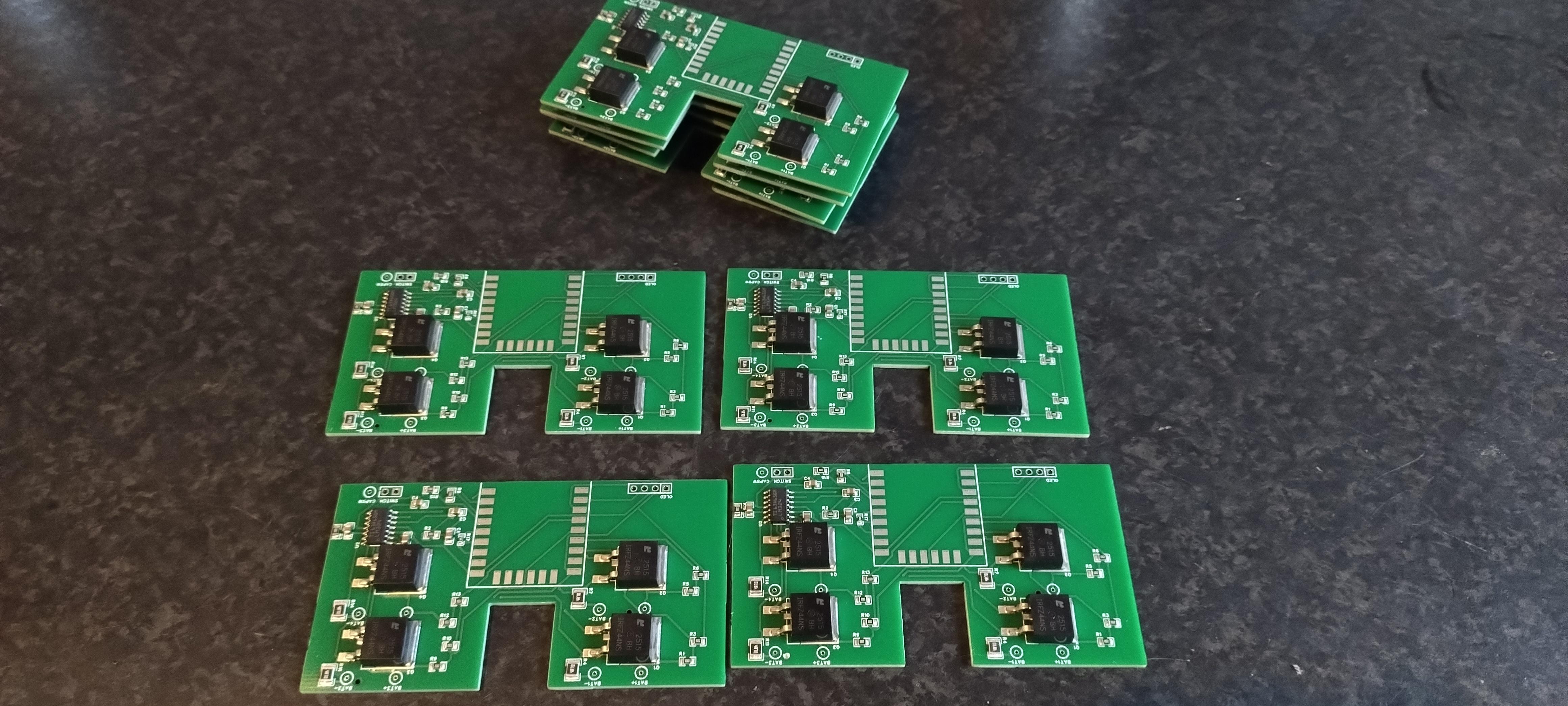

  1. Hi everyone!
    Jeeej got my first PCB's in for the Battery discharger! and ofcourse i made mistakes in the PCB design... i really hoped it would be perfect in one go.......(do i order 5 or order 10 for 1/3 more of the price......you know what i chose) The mistakes are not so much in the way it should work, just really dumb mistakes :) haha i chose the wrong mosfet... (dumbest mistake ever, almost the same one ) and i forgot a spot to ground... (could bodge that for now pretty easy thankfully) the mosfets i replaced in my prototype for the correct ones.. and there are some small things layout wise i want to see differently out of convenience. The PCB's have a clear spot where a microcontroller will be fitted to control all of it. and if the pcb is ok, i can change most settings by softtware update.
    Now i am playing around with where to put the screen and Switch or capacity switch. and some testing. seems to be 2-4% accurate between the 4 channels. doable.
    I will make a 4 channel Np50 version to begin with, and i am still looking for at least 1 person (preferred in Europe) that would like to test drive the prototype when it is working properly, i would love any input software based or arrangement wise, some things i cant change some things i can. and want to make it as good as i can within the boundaries of what i can make.
    Kind regards Joppe Peelen

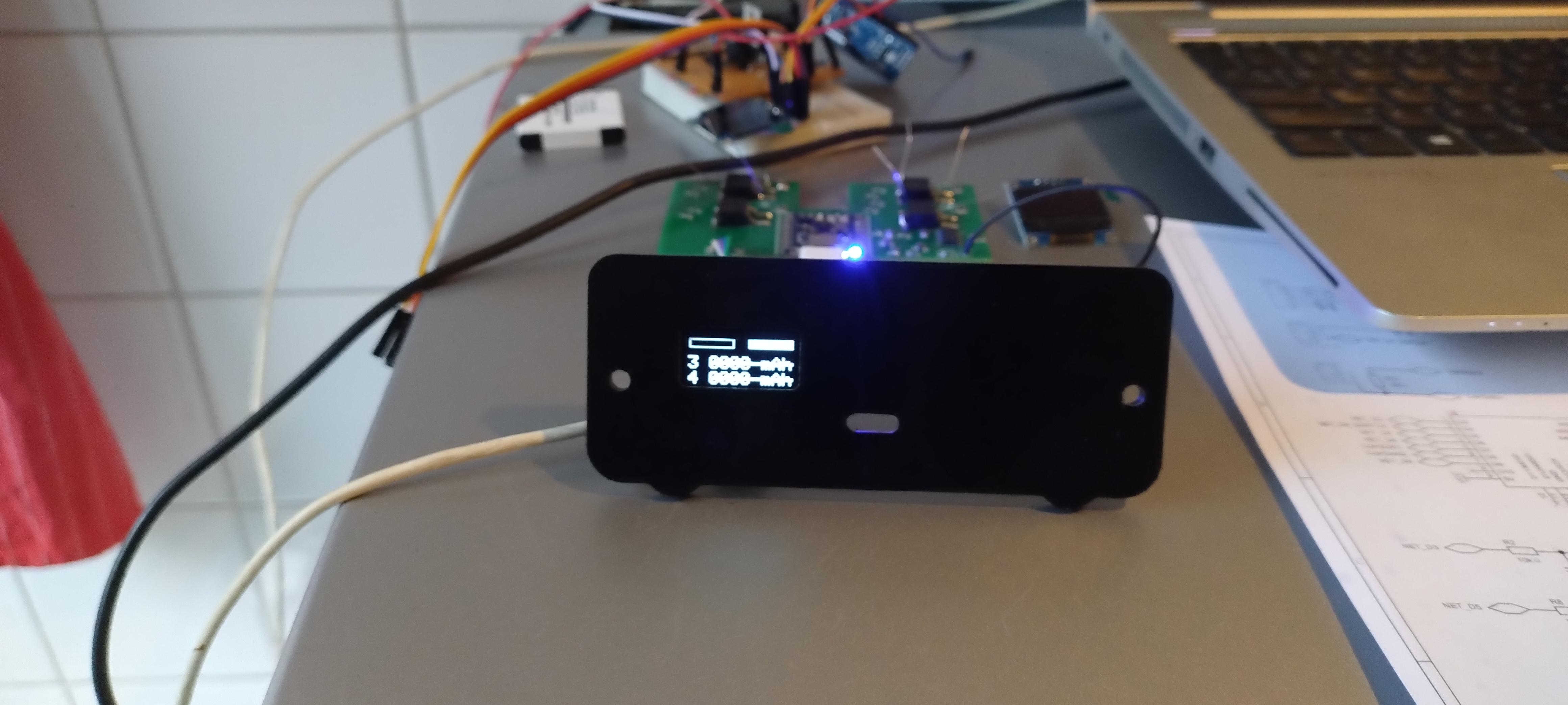

    Small update on my discharger, for those that are interested, and maybe if you got any ideas let me know !
    Well i am still in super prototype stage.... wires everywhere software not even near perfect. and still have a headache about how to put it all in a housing, while using as much parts i already make for my chargers. (if i can use parts i make anyways would be nice) so i decided to make it a 4 Bay discharger using the same layout as my chargers. so i can use the parts that will seat the batteries. the rest i would have to make custom.. but some is better then none :)
    It will be running on USB C (not the red high powered ones that can give 60 watts etc, i had one of those chargers and it does not work but pc/laptop and regular cheaper usb c chargers work fine. 500 mA like a regular USB1 port is enough to run it.
    It will (already does, but only 1 slot for prototyping) Discharge a battery with a load that represents the load the transmitter will do, this to get a better idea of what the useable capacity of the battery in question is.  MTP61 and the NP50 are close so they use the same current around 130-140mA (the transmitter that use them ), the BX used in the sounddevices need a higher current to get a more reliable reading (a heavier load will let the voltage dip more, and cut of earlier)
    The discharge will be a constant current load, just like the transmitter will be drawing a constant current if it wants to maintain its set mW of RF.  it then counts the current drawn over time until the cuttoff voltage is reached and it will show the final mAh capacity extracted from the battery.  i tested the accuracy and its around 99% accurate so far !
    it will have a storage setting beside the capacity test. so it will drain batteries down to 3.55 volt (with a set drain current of 200mAh, faster then the capacity test) and then bounce back to the ideal 3.7-3.8 volt storage voltage.
    Here a video of really..... prototype stage (although functional, but all in pieces) here a test with a capacity type of switch. placement would be somewhere else  (the hole in the front panel is where i wanted to see how the screen would look on this side, for now the screen is on top as you can see, but i put the switch where the screen was because the plastic is thin there (so it reacts like i want) it will be relocated to another place... just testing the switch and the timer so you do not screw up you 7 hour discharge session by accident.
    Video Capacity switch
    Im sure i will shuffle parts around to whatever place seems practical. one thing the screen on top is not practical :( costed me a week to try with different methods and well making it look nice...  is not possible :( wished i could....
    anyhow let me know if you have a good idea to implement maybe i can take a look at it?
