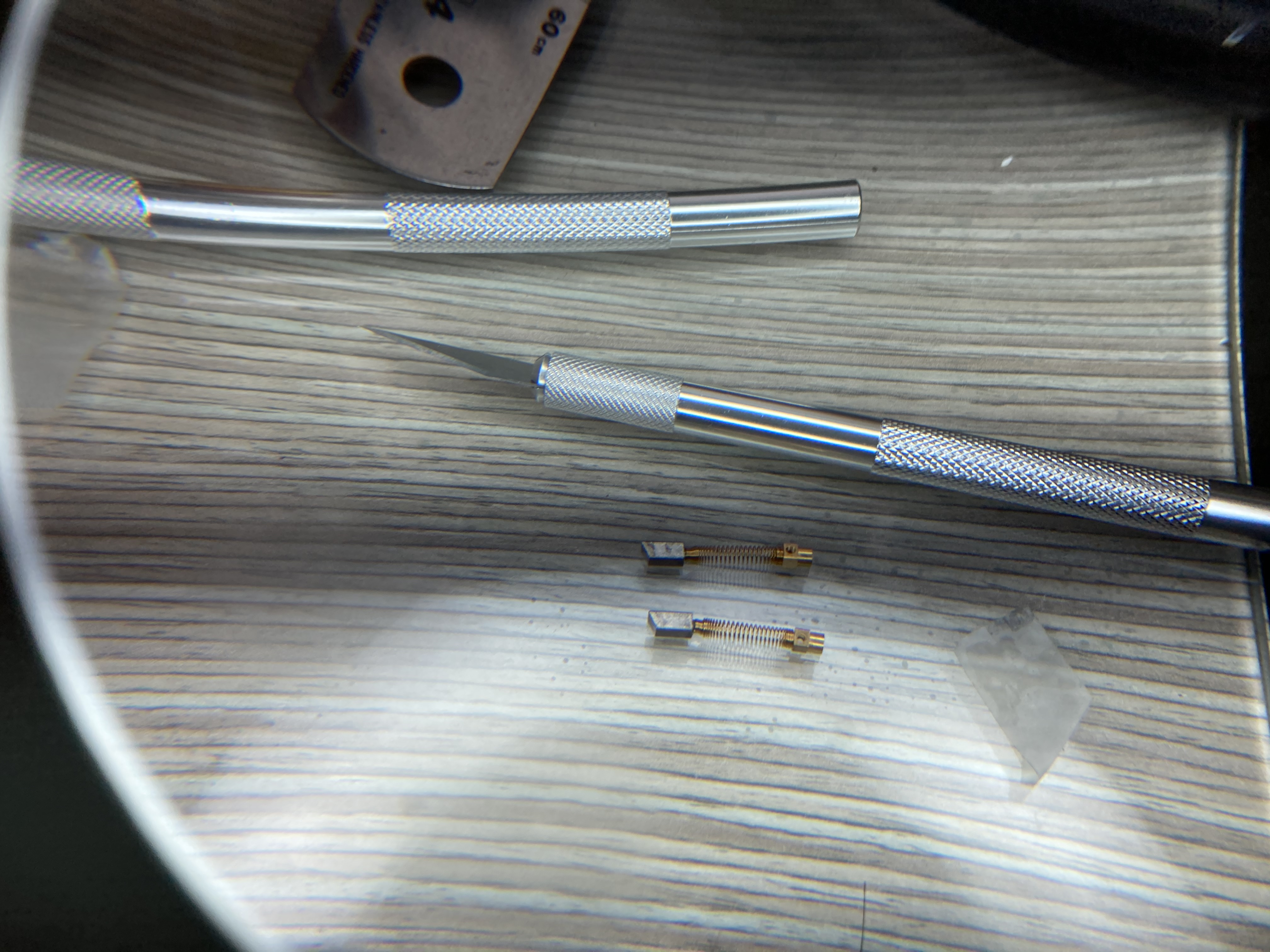

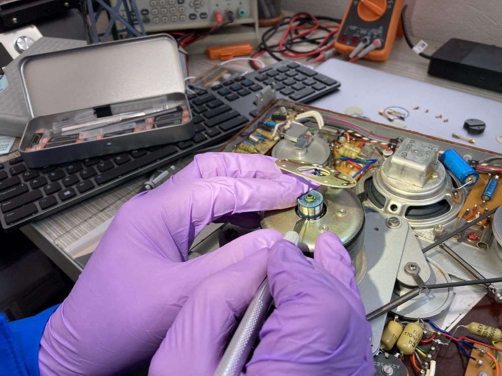

Hi guys, Long time since my las post, hope you all are doing fine in this weird times. Just to share my story, my Nagra III started to develop a rumbling sound in the motor, I was shocked when I was reading all the process to replace the internal bearing, special tools and lots and lots of courage!! Then I just read the manual and I found an interesting section “Dirty Commutator “ so it was a simple process and without the brushes I can confirm it wasn’t the bearing..... I just proceed with the cleaning with deoxit and get rid off the brushes dust between commutator section with an exacto knife, in my case That was it!!! A beautiful silent 58 years old motor, lots of torque, full rewinding, etc. Just cleaning!! A humble advice, start with the easy one. And there’s she is, beautiful and silent with new reels this time. Gustavo

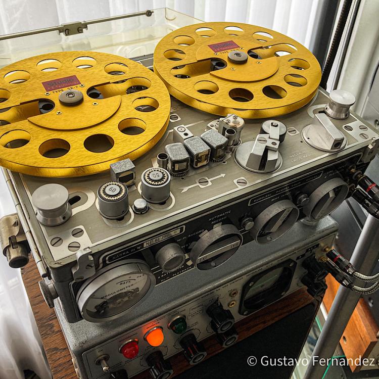

Hi guys, Long time since my last post, I got to say I really love my Nagra actually I'm using it very often and this is the final display show..... Regards, Gustavo

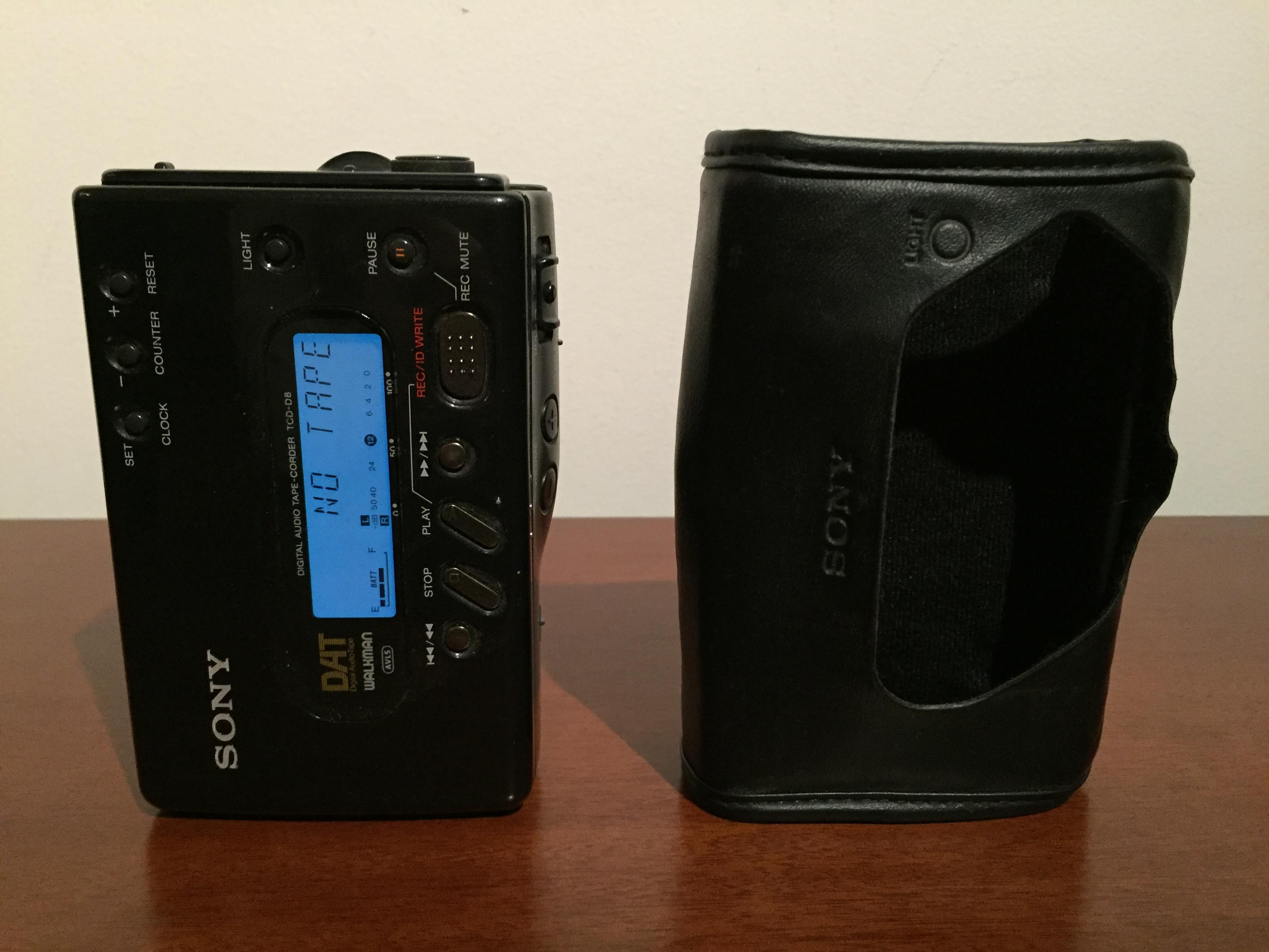

Thanks, actually this is the Sony TCM 600B, the pre cursor of the TPS L2, the same mechanism but the recording factor and mono, I do really love the evolution till the 90s when the Logic series appears, most beautiful and Japanese micro technology. And the great but delicate Sony TCD D8 Dat walkman....

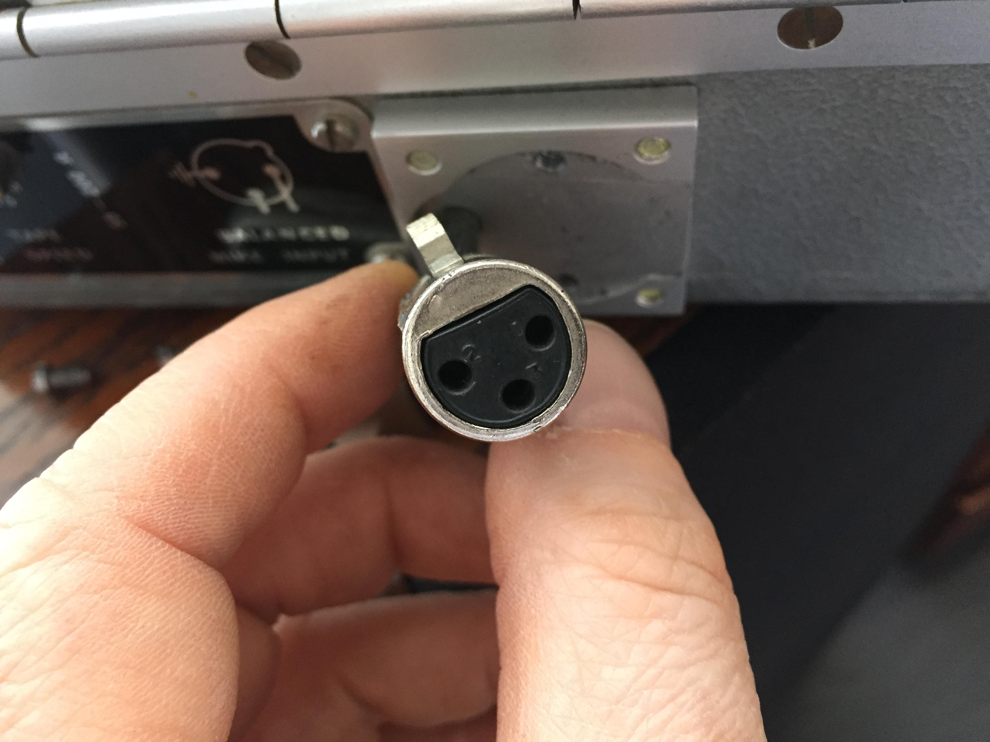

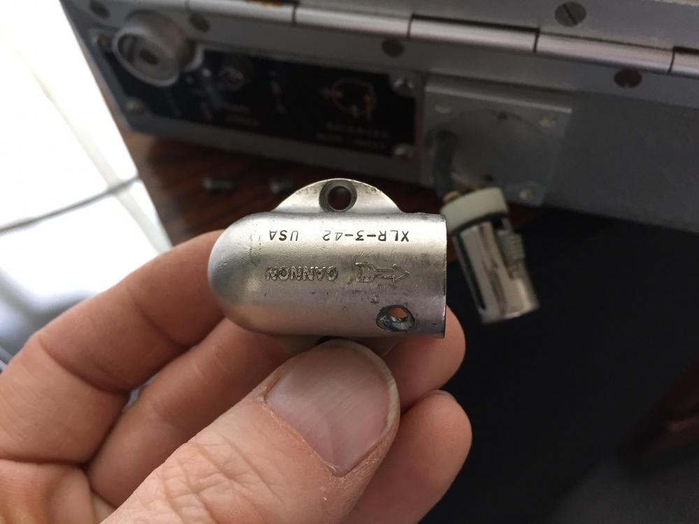

I was checking my Nagra III microphone connector, this one looks weird and its been altered?? Gustavo

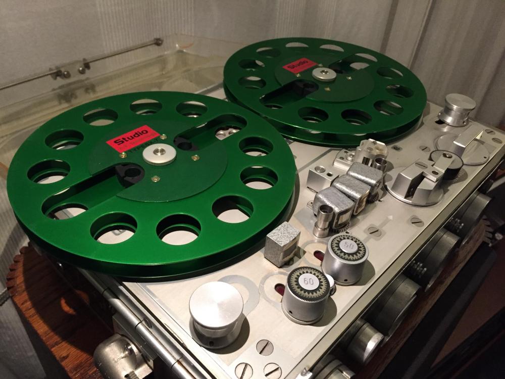

Hahahaha I hate that reel already as well, it's wearing plastic 7in and tomorrow arrives the 5in ones, next picture will be better.....promise!! Gustavo
