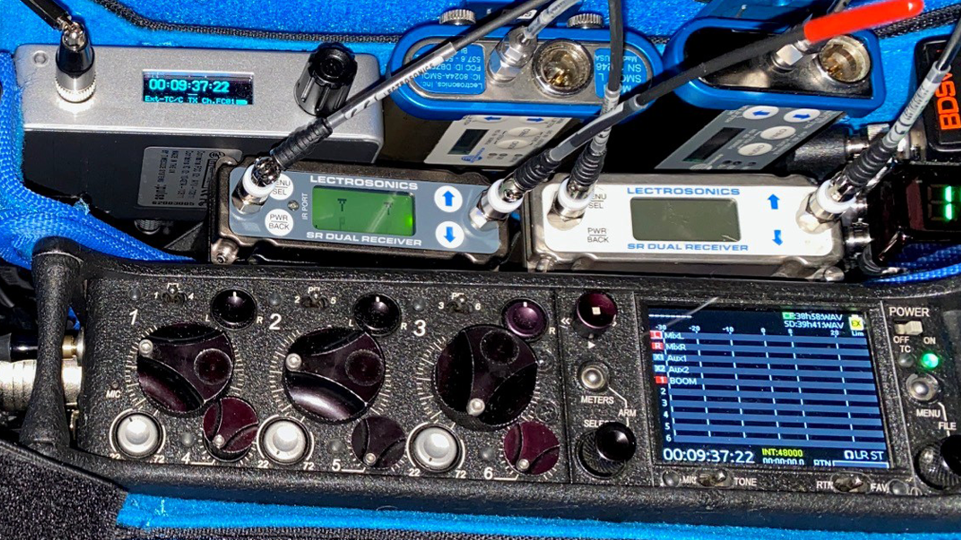

  5. Hello, I've searched this website but haven't found a solution to my issue. Sending 23.98 fps LTC timecode to a Pulse from SD633. The Pulse is connected to the AtomosX via RF signal. As you can see in the photos, all the units are synced perfectly. When I sync the video and audio in post it's off by 4 frames consistently throughout. I was wondering if there was a solution to this where it could be perfectly in sync when matched in post. Thanks!
