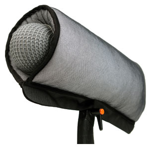

John Blankenship Posted February 10, 2012 Report Posted February 10, 2012 Also this: http://www.remoteaudio.com/rainman/ Quote
boomhead Posted February 10, 2012 Report Posted February 10, 2012 I've found the remote audio rainman to be not so great. try finding some Hogs Hair air filter material and build a cover in the same fashion as the rainman. this is the material FX use to dampen (pun intended) the sound of the rain on stage. wrap the zeppellin, make a cap for the back end and fasten it with small zip ties. once it is built you should be able to slide it on and off. use this on top of the windjammer. Quote

RadoStefanov Posted February 10, 2012 Author Report Posted February 10, 2012 Ideally I would get the rainman but it comes only for the WS-4 Rycote duck would not be sufficient for such extreme leakage while booming. Isn't there a fabric I can buy locally and just saw it together? On a different note I am happy that I would have the opportunity to test my DPA 4061 in extreme humidity... Quote

Philip Perkins Posted February 10, 2012 Report Posted February 10, 2012 Rainman worked fine for me. But you do need to be able to find some shelter once in awhile and wring it out. phil p Quote

syncsound Posted February 17, 2012 Report Posted February 17, 2012 +1 for the Rainman and MKH combo. Came through with flying colors during record rainfall for Portland, Oregon. Quote
Michael McQueen Posted February 17, 2012 Report Posted February 17, 2012 i just finished up a long shoot in some rainy conditions and i had good results with the remote audio rainman thingy. Quote
Jeff Wexler Posted February 17, 2012 Report Posted February 17, 2012 RemoteAudio RAINMAN - from RemoteAudio website: Protects the sound: The RAINMAN softens the impact of rain drops falling onto the boom microphone. Protects the microphone: The RAINMAN channels rain away from the microphone, along the outside of the "zeppelin" style windscreen. How does it sound? Like it's not even there. The RAINMAN is more acoustically transparent than traditional "furry" windshield covers Quote
RadoStefanov Posted February 17, 2012 Author Report Posted February 17, 2012 Jeff, I don't think they make RainMan for WS-2 rycote I ended up taking the MKH8040 in the tunnel and just try to setup the interviews where there is no "rain". What impressed me most was the fact that my DPAs and mkh8040 worked perfectly for 3 hours in 98F and almost 100% humidity. The DPAs/lectro SMQV and the mkh8060 worked perfectly next to high voltage cables and huge transformers as well as tight places. This was my wireless setup 2 smqv - talents, 1 HM - Boom, - " I was advised not to have hanging cables attached to my body" 2 LMa hops, 1 SRas Uni slot panasonic HPX300 " cable to camera was a safety concern as well" 1 Sennheiser G3 TX return on camera, 1 Sennheiser G3 RX Return in mixer. 1 Sennheiser IEM IFB for director. I HAD ZERO PROBLEMS even in very tight places thanks to IAS coordination. Can somebody teach me how to put a Petrol Perc poncho on a Petrol harness properly. I could not find the instructions. Quote
