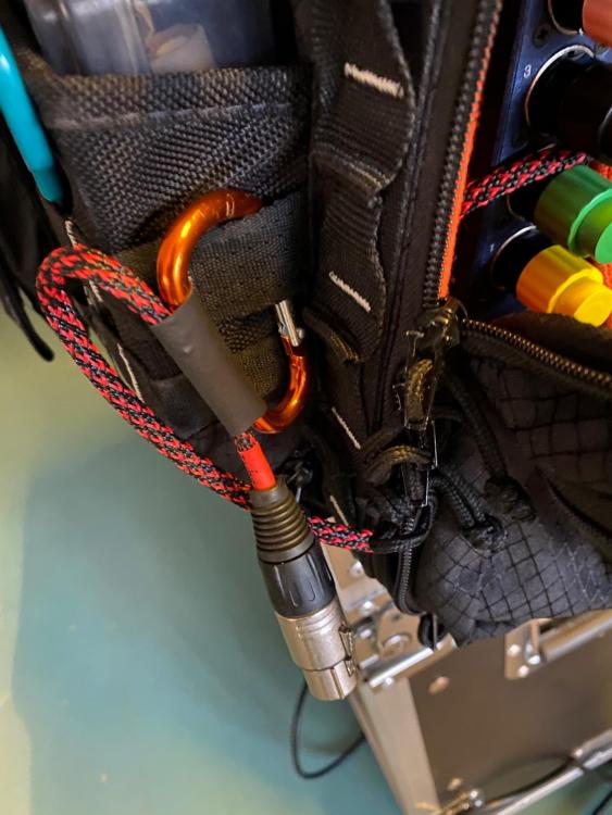

joi b Posted January 21, 2020 Report Share Posted January 21, 2020 Built this today, a mountable XLR boom connector for the front of my bag Quote Link to comment Share on other sites More sharing options...

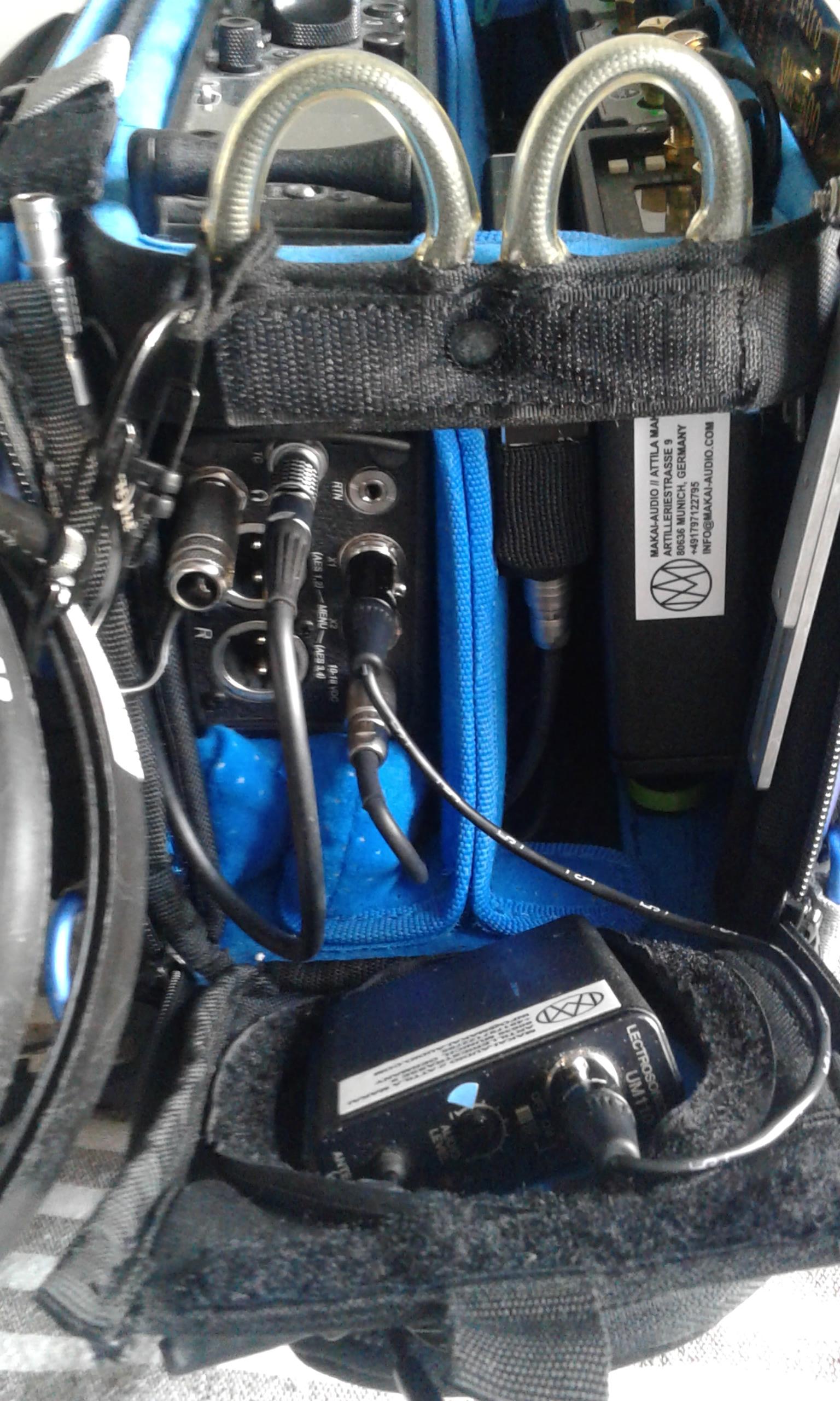

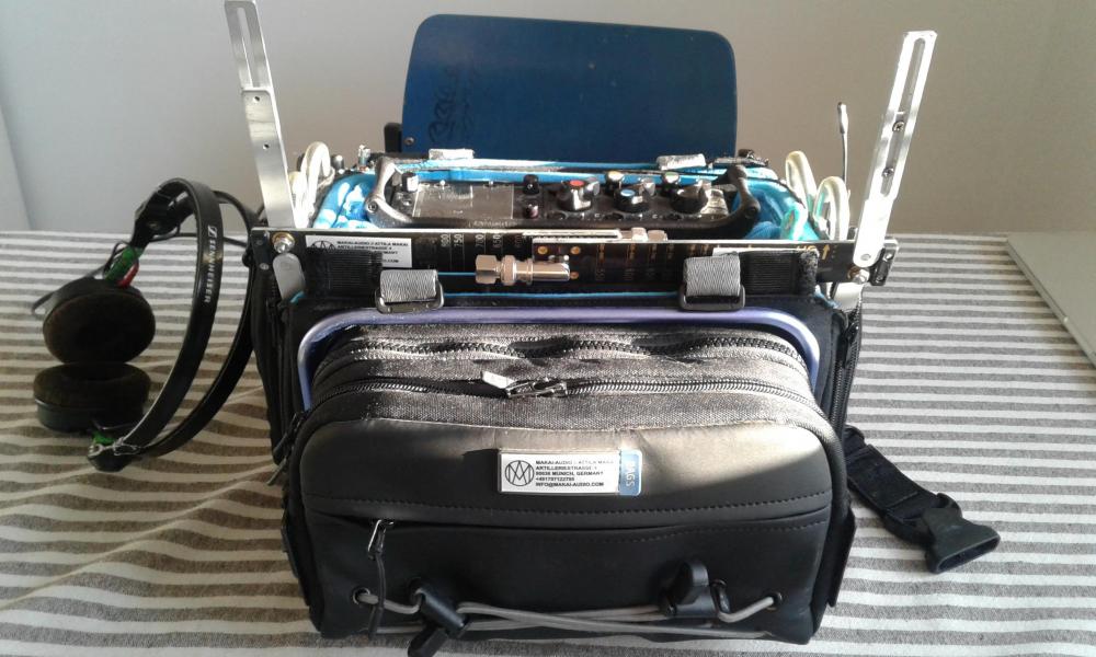

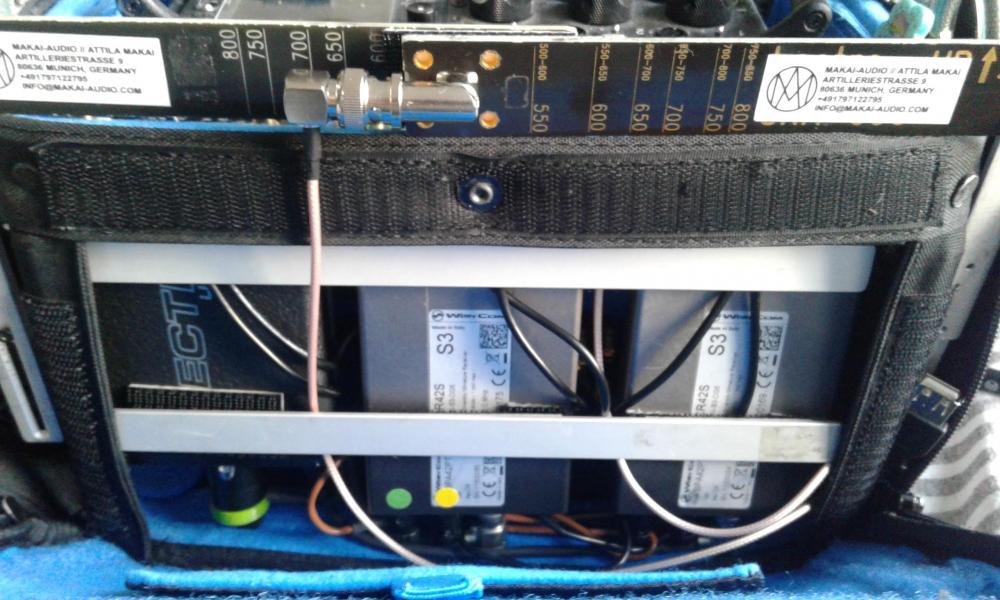

Attila Posted February 19, 2020 Report Share Posted February 19, 2020 Hi Folks. This is my bag mainly for commercials, documentary and interviews. But I also done a TV series on a cart and with sharks. 1 x Sound Devices 633 2 x Wisycom MCR 42S 1 x Lectrosonics UCR 201 for Boom (modified with SNA connectors for external antennas) 2 x Lectrosonics SNA600 (just stuck inside the spaces of the bag. I tried different things, but this is the easiest way and it´s fast removable) 1 x Powerdistribution from www.ops-shop.de 1 x Betagear Antenna Distribution (it´s from Ali Express and works fine with the Betagear Shark antennas! ) 1 x Sennheiser SK300 G3 for boom op or customers 1 x Lectrosonics UM110 for camera feed 1 x VMount battery 1 x Orca Bags OR-30 Quote Link to comment Share on other sites More sharing options...
IronFilm Posted February 20, 2020 Report Share Posted February 20, 2020 10 hours ago, Attila said: 2 x Wisycom MCR 42S 1 x Lectrosonics UCR 201 for Boom (modified with SNA connectors for external antennas) Nice wireless for the talent! Which makes me wonder why you're using a 201 for your boom? 10 hours ago, Attila said: 1 x Betagear Antenna Distribution (it´s from Ali Express and works fine with the Betagear Shark antennas! ) I'd love to read a review of both of these! Wonder if I should get those myself 10 hours ago, Attila said: 1 x VMount battery Whoa, hefty battery for a 633 kit! Or are you using one of those lightweight mini V Mount batteries? Quote Link to comment Share on other sites More sharing options...

Attila Posted February 20, 2020 Report Share Posted February 20, 2020 6 hours ago, IronFilm said: Nice wireless for the talent! Which makes me wonder why you're using a 201 for your boom? I'd love to read a review of both of these! Wonder if I should get those myself Whoa, hefty battery for a 633 kit! Or are you using one of those lightweight mini V Mount batteries? I´ve got the 201 block 24 for a long time and it never let me down and it´s my trusty old friend. (But when I have some extra cash I upgrade) I am using the Betagear Stuff for nearly one year. The antenna distribution looks same the the PSC one and is well build and I costs around 350€. The sharks (90€ for two!) are a little bit taller than the usual suspects but working great. They look very similar to the shure UA874 besides the paddle is different. With the antenna distribution and the sharks I have a really great range and no dropouts. When I ordered them I was sceptical, but I was to courious too! There´s a lot of crap on Alix Express, but a few things are great. Also great art the Leicozic Receivers for the clients. https://www.aliexpress.com/item/32750422632.html?spm=a2g0o.productlist.0.0.5e5d42a6WqzFzQ&algo_pvid=631508f9-2007-42d8-9932-81b74afcd8c2&algo_expid=631508f9-2007-42d8-9932-81b74afcd8c2-14&btsid=0b0a187915821902379692581ebf01&ws_ab_test=searchweb0_0,searchweb201602_,searchweb201603_ Well build and sounding good for 50€. I use the together with my Sennheiser SK300 (SNA antenna modified) I also can recommend al kind of cables and SNA antennes there. The prizes are good. I buying pro stuff and I am willing to spend money. But cables and antennas are definitifly way too expensive. My VMOUNT is the AXCOM U-SVLO-99-UD. It´s half the size of fat one. Two of these power the whole bag for one day. I decided for V-Mount because normally the camera department has them too. For emergency situations I can use their chargers or their batteries. Quote Link to comment Share on other sites More sharing options...
IronFilm Posted February 20, 2020 Report Share Posted February 20, 2020 2 hours ago, Attila said: I am using the Betagear Stuff for nearly one year. The antenna distribution looks same the the PSC one and is well build and I costs around 350€. The sharks (90€ for two!) are a little bit taller than the usual suspects but working great. They look very similar to the shure UA874 besides the paddle is different. With the antenna distribution and the sharks I have a really great range and no dropouts. That's good to hear! 2 hours ago, Attila said: When I ordered them I was sceptical, but I was to courious too! There´s a lot of crap on Alix Express, but a few things are great. Also great art the Leicozic Receivers for the clients. https://www.aliexpress.com/item/32750422632.html?spm=a2g0o.productlist.0.0.5e5d42a6WqzFzQ&algo_pvid=631508f9-2007-42d8-9932-81b74afcd8c2&algo_expid=631508f9-2007-42d8-9932-81b74afcd8c2-14&btsid=0b0a187915821902379692581ebf01&ws_ab_test=searchweb0_0,searchweb201602_,searchweb201603_ Well build and sounding good for 50€. I use the together with my Sennheiser SK300 (SNA antenna modified) I also can recommend al kind of cables and SNA antennes there. The prizes are good. I buying pro stuff and I am willing to spend money. But cables and antennas are definitifly way too expensive. Ah yes, I've been using Leicozic IEMs myself for the past half year! (although I feed them with a Sony wireless TX) 2 hours ago, Attila said: My VMOUNT is the AXCOM U-SVLO-99-UD. It´s half the size of fat one. Two of these power the whole bag for one day. I decided for V-Mount because normally the camera department has them too. For emergency situations I can use their chargers or their batteries. I use Sony BP-U60 batteries myself, which are also very very common. As they're what the Sony FS7 and other cameras use. Although I've never yet need to borrow anything from camera department. (is convenient for me though, as they also get used in my Sony PMW-F3) Quote Link to comment Share on other sites More sharing options...

Attila Posted March 5, 2020 Report Share Posted March 5, 2020 On 2/29/2020 at 6:37 PM, TimMey said: Nice bag Attila!! It looks like you have approx. 3 cm left under the 633. I wonder, if the OR-30 would be a good match to a Sound Devices 833 with two medium NPF (770) on the back?? It would add about 5-6 cm compared to the 633, but i don´t want the Recorder to stick out of the bag too much... Does anybody has experience with the depth of the 833 with NPF´s added on the back? Does anybody know if they will bring out a special bag for the 833? Or should i get the Stingray Small instead?? What do you think...? Thanks everybody. Best, Tim. Under the 633 there are aprox. 2 cm left. I ordered a 833 and I tell you if it fits when it´s here... Quote Link to comment Share on other sites More sharing options...
