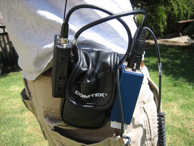

Brian Maier Posted June 27, 2007 Report Posted June 27, 2007 I have yet to find a director that wants to use the comtek pouch with the comtek, but it works great for a wireless boom. Quote
FSBELLA Posted June 30, 2007 Report Posted June 30, 2007 brian, just to clarify, the lectro bodypack goes in the comtek pouch? if so, way to utilize the "flaw" in the new pouch. no director, scripty or producer etc. is going to strap that sucker thru there belt loop. (the PR-216 has a 'snap-on clip") btw, I have around 30 of those comtek pouches. if anyobody wants one to use for there wireless boom, let me know. Frank@coffeysound.com Coffey Sound Rental Manager Quote

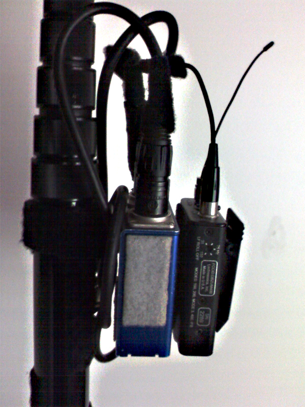

Sergio Sanmiguel Posted June 30, 2007 Report Posted June 30, 2007 I use Locking velcro to attach the Denecke Phantom power to the lectro transmitter and a portabrace cable strap (velco) to secure the rig to the boom pole... Quote
FSBELLA Posted June 30, 2007 Report Posted June 30, 2007 sergio, it looks a little cumbersome on the pole, it might get noisy. have you ever tried "wearing" the bodypack & 48v ps?? you might want to try the comtek pouch. email me your address. Quote
Sergio Sanmiguel Posted June 30, 2007 Report Posted June 30, 2007 sergio, it looks a little cumbersome on the pole, it might get noisy. have you ever tried "wearing" the bodypack & 48v ps?? you might want to try the comtek pouch. email me your address. Cumbersome? Think about it, you get a belt with all this gear plus, a comtek, gloves, cellphone and you still attached to the pole with a coiled cable! Now THAT is cumbersome. I also use a Lectro Butt Plug by the way... See, I got tired of wearing this on my belt but I graciously accept a few of your Comtek pouches. I have worked like this for more than 3 years & the pole never "gets noisy" . Also my boom operator likes it more since theres no unplugging from the box to do, just grab and go! Quote
FSBELLA Posted July 1, 2007 Report Posted July 1, 2007 on the bottom of the pole, it acts like a little counter-balance, I get it. Quote
Brian Maier Posted July 1, 2007 Author Report Posted July 1, 2007 just to clarify, the lectro bodypack goes in the comtek pouch? I have a comtek in the pouch and the um400/ps-1a clipped to either side. I do need to shorten up my coiled cables though, both boom and headphones are annoyingly long. Quote

Brian Maier Posted November 24, 2013 Author Report Posted November 24, 2013 Seeing that picture of my backyard makes me miss California. Had real nice Orange, Lemon, and Tangerine trees at that place.... Quote
