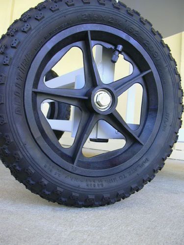

Rob Stalder Posted July 23, 2007 Author Report Posted July 23, 2007 FWIW I might add to this. I made a few of these carts a while ago, mainly at the request of someone else. I had a few military instructional videos to do so I thought I might try one for myself. As you can see I had three of these Chihuahua cameras constantly snapping at my heels - Rob can you move a bit to the left, to the right, boom over the reflector, etc etc. I realised I would have to put castors on the front as I was pushing & pulling it this way & that. The castors worked fine, I experimented with 3 sizes & decided the best were 3inch ones, particularely in the rough ground. I also experimented with boom mounts & ended up with a small box bottom shelf front left & a manfrotto super clamp top shelf front left. PSC bobbers also work well in place of the super clamp. This meant I didn't have to lean the boom up against the cart or a tree with the risk of someone tripping over it. I now have the bigger wheels with better bearings & axles allowing me to bolt them directly to the side of the cart as in the 3 shelf version. This enables the cart to be much narrower. This cart is not designed for Drama nor to carry a lot of weight, although some people have given it a go with a small setup. I have made available a larger shelf (deeper F to as an option for a flat bed mixer. Cart weighs about 8kg or 17.5lbs. As this is the style of work I do I am very pleased with myself to have at last made something I can use and - it works for me. Rob Stalder Quote

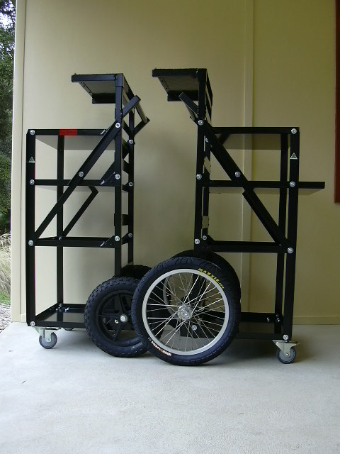

Rob Stalder Posted December 26, 2008 Author Report Posted December 26, 2008 Have just made some more foldup carts, keeping the same dimensions, but have painted them black to see how they looked. Have kept the feature of an option for the 2nd shelf down to be larger at no extra cost - but the carts have gone up an extra AUD$50. Also tried out 16" side mounted spoke wheels, which are interchangeable on the cart with the12" ones. There are 2 mounting locations. As the axle mounts are at the rear to keep away from folding mechanism, the wheels do stick out the back. The 12" ones are not that noticeable at 180mm (7"), but the 16" ones are at 220mm (8 3/4") - But they sure do boogie over rough terrain. The top half shelf lifts off and can be placed in either direction. Rob Stalder www.rastorder.com.au Quote
