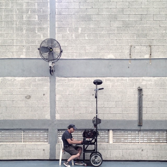

Rob Stalder Posted August 18, 2016 Author Report Posted August 18, 2016 Man at work... Tully - Israel. Quote

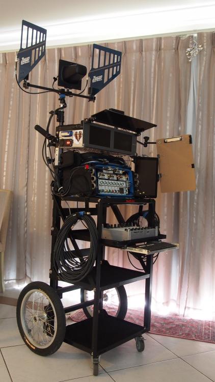

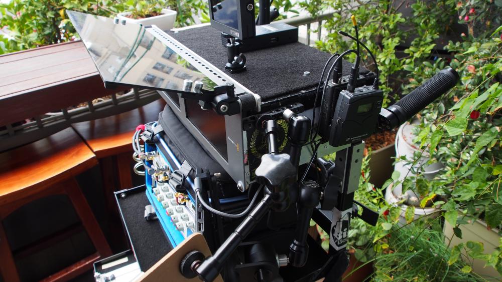

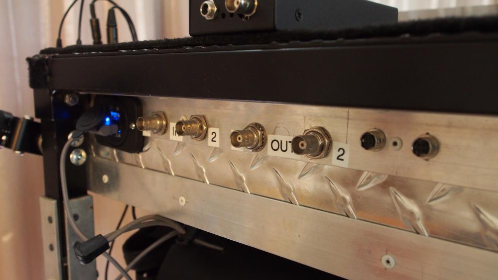

Nate C Posted January 9, 2018 Report Posted January 9, 2018 Sorry this post is so late. I got crazy busy and then enjoyed some time off over the crazy season. I underslung a slide out keyboard shelf useing micro sliders Added brackets to bolt a Mix8 to that fold down when not using Mix8. Still need to find out the correct size screw used on the Mix8 so I can use their bars. Rollerblade wheels to the handle so as I can lay the cart down and slide it in my car. To the top shelf I bolted on 15cm extensions to raise it high enough to fit a larger bag underneath the monitors. Smart DUO monitors are kind of underslung from the face of the top shelf with a permanent aluminium box built around it. The rear panel has a patch bay with 2x USB power outlets, BNC in and out for each monitor as well as 2x Hirose power outlets. Left side has NP1 slot and power gauge and 2x USB power outputs. There is also small cheese bars on either side for mounting stuff as well as a cold shoe mount on top for rigging a third monitor, in my case DP4 with convertor. All of this is power by a single NP1 battery via a Hawkwoods cup/distro. Also made a Matte box esq sunshade the monitors tag. Later discovered I needed to add handles higher up as the carts centre of gravity is much higher then when Rob originally built it. As I live in a four story walk up apartment a solution to this was essential. Ended up settling on Rosette camera arms as they lock sturdy but can be folded down for loading in the car. With the monitor shelf on the cart no longer folds. It could though if the extension bars were a couple of inches higher. The top section can be easily be removed within a minute. Most of the time I use the cart in low profile mode. Almost for the most import thing, lucky dice tyre caps. Quote
Rob Stalder Posted January 10, 2018 Author Report Posted January 10, 2018 Hello Nate. What you have done is brilliant, I can see your lateral mind working overtime. Thank you for posting those pics. not just for others to see, but for me too. I am very impressed. Re the lucky dice valve caps, I try to include one of these and one of these on (most) of my carts, because I can. Best, Rob Quote
