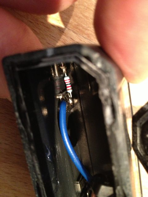

TJW Posted November 23, 2012 Report Posted November 23, 2012 I'm interested to know if anyone has tried charging the GlobalMediaPro NP1's from a Hawkwoods MR2/4 charger and if they have experienced any ill effects long term??Works well. You cannot use the charging slots as they do not recognise the battery. Neither can you use the concentric DC connector at the bottom is the NP1 slot as that is NiMhd only. The solution is either to buy a HW AD-8 adapter an fit a BP90 plug (-ve pin) or make up an adapter from an old NP1 which I have done for a few friends fitting a resistor to tell the charger that it is LiIon and fitting a BP90 plug. Quote

Matt Bacon AMPS Posted November 23, 2012 Report Posted November 23, 2012 Works well. You cannot use the charging slots as they do not recognise the battery. Neither can you use the concentric DC connector at the bottom is the NP1 slot as that is NiMhd only. The solution is either to buy a HW AD-8 adapter an fit a BP90 plug (-ve pin) or make up an adapter from an old NP1 which I have done for a few friends fitting a resistor to tell the charger that it is LiIon and fitting a BP90 plug. Good to know. Thanks Quote
