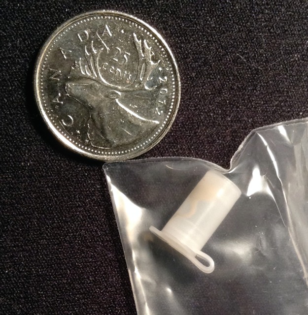

Boomboom Posted March 3, 2013 Report Posted March 3, 2013 Received mine last week (from Trew T.O.) Here's what it looks like, for those who'd wonder... (Yep, there's even an instructions sheet! Lectro's class as usual ! ) Quote
