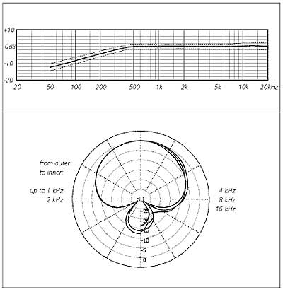

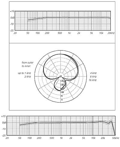

Derek H Posted May 7, 2013 Report Posted May 7, 2013 For reference, frequency response and polar pattern graphics from Schoeps: Standard MK41 *note that the 2nd response curve below the polar pattern is when using the CMC XT preamp. MK41S ...I say it's too bad they don't make a CCM41 with a variable HPF, like a built in CUT1 or CUT2. Quote
Scott Smith Posted May 7, 2013 Report Posted May 7, 2013 While in general I have always found the roll-off of the -S version to be a bit severe (except for it's intended use on close-miked dialog), I have used it occasionally for car rig shots, especially where I can't mount a mike with a CUT-1. It doesn't leave the case often, though.... It would be much more useful for film work if they could have incorporated a steeper hi-pass filter, with a lower cutoff frequency, maybe 80-100 hz. Next to impossible to do in a capsule though, without a lot of extra electronics. --S Quote

Ken Wilkinson Posted May 7, 2013 Author Report Posted May 7, 2013 For reference, frequency response and polar pattern graphics from Schoeps: Standard MK41 *note that the 2nd response curve below the polar pattern is when using the CMC XT preamp. fpol-mk-ccm41_0.jpg MK41S fpol-mk-ccm41s.jpg ...I say it's too bad they don't make a CCM41 with a variable HPF, like a built in CUT1 or CUT2. That's quite a cut... Thanks Quote
