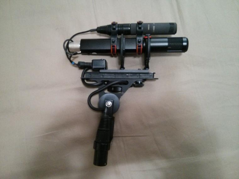

Glen Deakin Posted August 6, 2013 Report Share Posted August 6, 2013 I fit my same setup into a rycote WS1. Took some messing around but got it pretty good. Had to go right angle on the XLR for the 30 but am very happy with it. here are some pictures i took quickly with my phone. Quote Link to comment Share on other sites More sharing options...

Glen Deakin Posted August 8, 2013 Report Share Posted August 8, 2013 My plan right from the beginning was to get this setup as small as possible and getting everything into a Rycote WS1 was perfect for what i wanted. Got some great help From both Audio Services and Trew Audio in Toronto to make this happen. Obviously with a smaller windshield there is less room inside but Im never going to crazy with swinging it around. The XLR Mod was done at Audio Services. Quote Link to comment Share on other sites More sharing options...

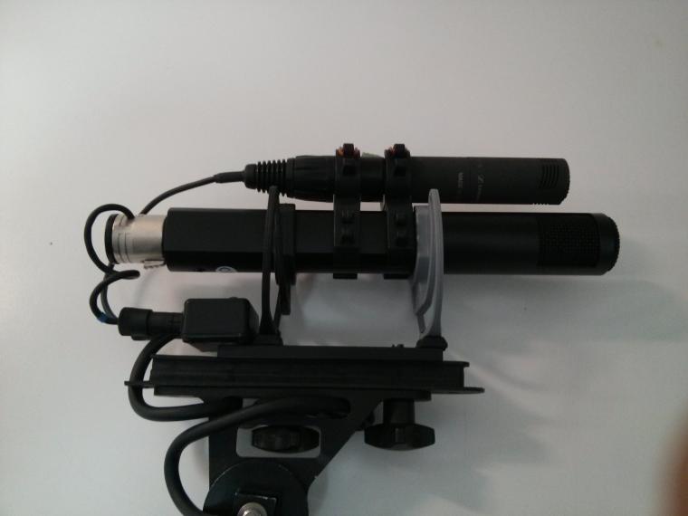

Glen Deakin Posted February 3, 2014 Report Share Posted February 3, 2014 Here are the pictures of my setup. i changed a few things around from the original ones that i posted earlier. Changed back to Black Lyers (1 MKH at the back & 1 Universal at the front) to push everything back abit. Does not sway so much at the front now. Also removed the back clip holding the 8000 microphone to the 30. did that after i took the picture. Only other thing id like to do would be to go binder straight to the sennheiser MZX connector to make things more sleek. So far this is working well. Added a 4th pic of the inside Quote Link to comment Share on other sites More sharing options...
