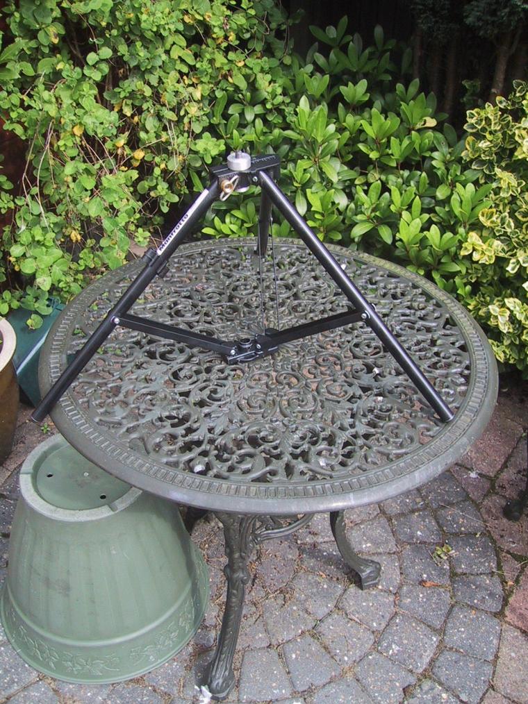

Jon, On the carts that we manufacture we buy a Manfrotto MA1052Bac Compact stand and remove the tripod. This gives us a 2.7 metre 2 section mast which is fastened to the cart. The tripos that is left is made into a mic stand by putting a boss into the top where the 2 section tube went through and this makes a very sturdy stand when you want something remote for your FX mic.post-233-0-62795200-1377783393_thumb.jpg

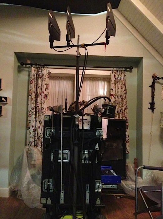

Top 2 sections of lightweight stand, cross-brace designed for a combo stand serves as antenna bar, loc-line mounts, female baby mount and a utility male baby pin in the middle.
All for about $150
Such a good deal, I have 2. Other stand is pipe clamped to my vertical magliner "bag" cart. The extra cross bar with spare antennas is ready to rig on that or process trailers, etc.

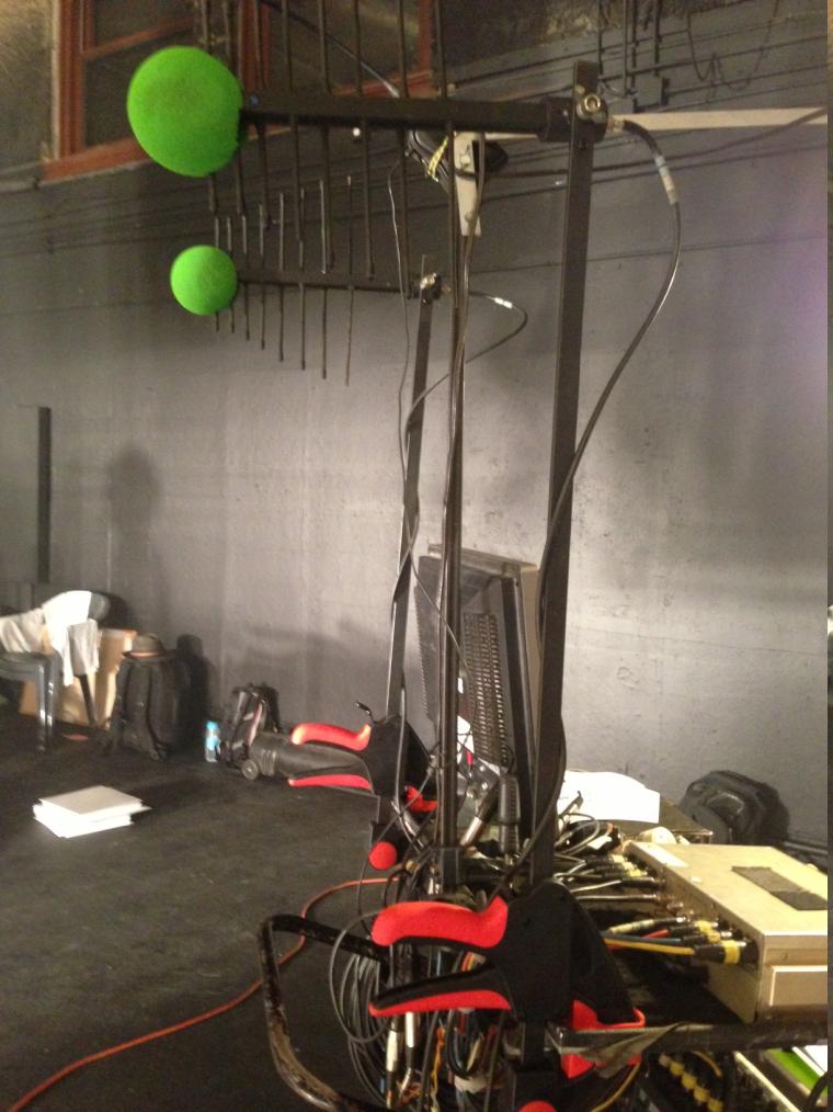

I went for a couple of 3-foot carpenter's clamps from Harbor Freight. My first ones were light duty and broke too easily, but the heavier-duty ones are great. Theory says for optimal diversity performance the masts should be spread further than the width of my cart, but I've not identified any problems arising in practice.
And those green foam balls are eyeball-protection for my tall boom ops. Toys-R-Us for them. And a great conversation-starter for everyone from visiting civlians to jaded veterans.
All this can be yours for under $30.
Fred

Jon, On the carts that we manufacture we buy a Manfrotto MA1052Bac Compact stand and remove the tripod. This gives us a 2.7 metre 2 section mast which is fastened to the cart. The tripos that is left is made into a mic stand by putting a boss into the top where the 2 section tube went through and this makes a very sturdy stand when you want something remote for your FX mic.attachicon.giffx mic stand.jpg
