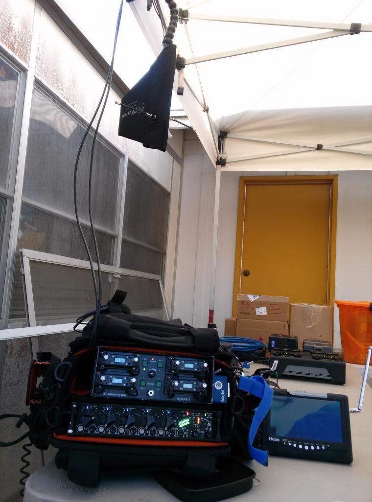

Derek H Posted October 25, 2013 Report Posted October 25, 2013 I also suggest the RF diversity fin antenna. Especially if you're not on a cart and need to be portable. Provides two antennas in a single point system. Can clip to a bag with a flexi mount or you can easily remote it out using the same flexi mount and available structure or a single light stand. I'll post some pics later. Attached to a petrol 601 feeding a Sennheiser quad pack. Significant improvement in range and consistency for this setup. Good luck! Quote

Philip Perkins Posted October 25, 2013 Report Posted October 25, 2013 Great pix. Good illust. of how the RF Venue is helping in baggo-fast moving setups, letting the soundie be outside a room that might have dodgy RF transmissions re whips. Also nice to see the Nomad with 664 knobs! philp Quote
