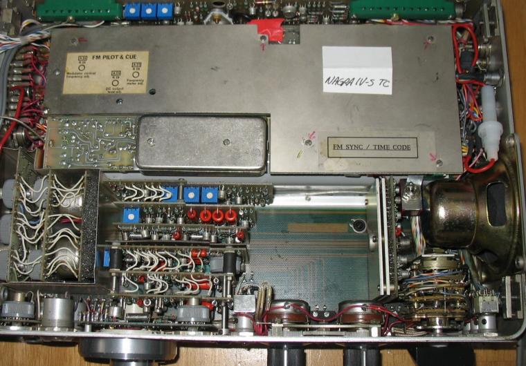

rstl99 Posted December 11, 2013 Report Posted December 11, 2013 Hi all, I recently purchased a Nagra IV-S from Pro-Sound, which possibly belonged to someone frequenting this forum (I was told it came from a sound mixer working in Hollywood). Anyway, my interest is in stereo music recording, so I'm thrilled to have this IV-S to play with. This IV-S a time-code version, which I'm not familiar with. Since I don't need to sync with anything the timecode circuitry if of no use to me. However, I note a small toggle-switch just behind the speaker, inside, and wonder if someone could tell me if the position of that switch impacts in any way stereo audio recordings that I want to make with the IV-S. I attach a picture in case this triggers your memory of the function of that switch. Thanks for your help. --Robert Quote
old school Posted December 11, 2013 Report Posted December 11, 2013 The FM pilot tone or the TC gets laid down and recorded to the small center track of the Nagra recording on tape. Pilot will be a low freq hum and the tc an un nice squeal if you could hear them. I'd flip it to FM Sync since you don't need TC. CrewC Quote
ao Posted December 11, 2013 Report Posted December 11, 2013 60hz pilot was for mono machines. because the low frequency would bleed from the centre track, 13.5khz fm sync was developed. the record and playback heads were narrowed on the timecode version, to provide better separation and prevent timecode bleed, which accounts for the lower signal to noise ratio on the timecode machine, compared to the regular stereo nagra. ao Quote

Glen Trew Posted December 12, 2013 Report Posted December 12, 2013 The 60Hz pilot signal on the IV-S was frequency modulated at 7kHz, which is why it was referred to as "FM Pilot" instead of "Pilotone". This kept the 60Hz hum from bleeding into the audio tracks. The timecode signal of the Nagra-issued timecode version of the IV-S (commonly but unofficially referred to as "Nagra IV-STC"),laid down the timecode linearly, without being frequency modulated. This is because the frequency of timecode was deemed sufficient to not bleed significantly onto the audio tracks. In truth, the timecode added perceptible noise, but it was mostly lost in the tape hiss. The early versions of the Nagra IV-STC did not have the option for recording without timecode. When this was scoffed at by those recording nonsyncronous music, Nagra accommodated by adding the option for disabling the timecode generator, thus reducing noise. The Nagra pictured above appear to me to be a popular after-market timecode mod by Timecode Systems, affectionately known as the Harvey Mod. (If it is the Harvey Mod, there will be an LED display on top of the deck). It was a good, high-quality mod when installed properly. Unlike the Nagra version, the Harvey Mod allowed either FM Pilot or Timecode to be recorded on the center track. But if sync is not needed, you might as well disable the sync signal, whether it is FM Pilot or timecode. Glen Trew Quote
afewmoreyears Posted December 12, 2013 Report Posted December 12, 2013 I have about 15 boxes of 808 and or the re biased 908 scotch recording tape for that machine... I need to look and see... I have been waiting to get it to someone who needs it... It's been a long time... still new and stored properly...If that someone is you, let me know.... PM me.... Make me a donation and pay for shipping and you can have it... Quote
Philip Perkins Posted December 12, 2013 Report Posted December 12, 2013 That's not a Harvey mod board. The Harvey install replaced the stock Nagra speaker (this one has the orig one) with a smaller speaker set back into the case, to accomodate the Harvey control panel on the right side where the speaker was. A Harvey mod does not require opening the machine to switch from TC to FM Pilotone to no sync recorded at all--that was all avail on the rotary switches on that side-mounted panel. This machine might have been a custom mod. philp Quote
Marc Wielage Posted December 12, 2013 Report Posted December 12, 2013 I can recall that when we got in Harvey mod 1/4" timecode tapes in the 1980s for telecine in post, those seemed to be more accurate than the original Nagra TC tapes for some reason. Eventually, Nagra worked it out and the timecode started having zero offset. Fred Ginsberg wrote a very thorough book on the Nagra IVSTC back in the 1990s. I believe it's still available for download at this link: http://www.filmtvsound.com/index.php/user-manuals/category/14-nagra Quote

Glen Trew Posted December 13, 2013 Report Posted December 13, 2013 That's not a Harvey mod board. The Harvey install replaced the stock Nagra speaker (this one has the orig one) with a smaller speaker set back into the case, to accomodate the Harvey control panel on the right side where the speaker was. A Harvey mod does not require opening the machine to switch from TC to FM Pilotone to no sync recorded at all--that was all avail on the rotary switches on that side-mounted panel. This machine might have been a custom mod. philp Yes, Philip, after giving it more than a quick glance it's clear that it's not a Harvey Mod. The side panel is clearly a standard Nagra timecode IV-S panel, but switching between FM Pilot and timecode required a board change. Maybe it's a timecode machine with the FM Pilot board installed? gt Quote

Philip Perkins Posted December 13, 2013 Report Posted December 13, 2013 I've never seen a Neil Stone IV_S mod, so that's a good guess maybe. (The ones I saw were the 4.2 mods). That is the stock Nagra lemo TCi/o, as far as I can recall. philp Quote

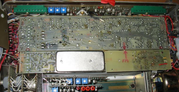

Charlie Parra Posted December 14, 2013 Report Posted December 14, 2013 I've never seen a Neil Stone IV_S mod, so that's a good guess maybe. (The ones I saw were the 4.2 mods). That is the stock Nagra lemo TCi/o, as far as I can recall. philp The Neil Stone Mod used the Denecke ST-1 (sync stripper) along with a Denecke SB-2 or GR-1. I don't see the ST-1 board in the picture, so I don't think it it is Neil's mod. ?? -- Charlie Quote

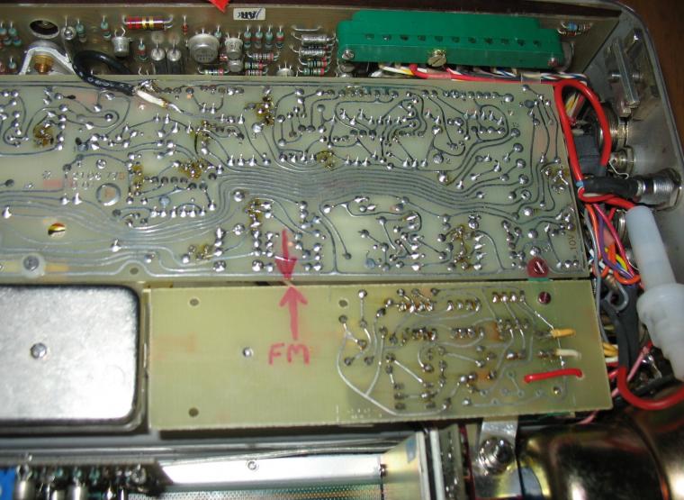

rstl99 Posted December 14, 2013 Author Report Posted December 14, 2013 Well, it seems the modification of my recently acquired IV-S is proving intriguing, as to who may have done what kind of mod on it, so I removed the cover in case it reveals more clues. Looks like a bit of a kludge to me... Oh well, I assume it did the trick as the recorder belonged to a west coast sound man who has a lot of feature films to his credit! Quote
studiomprd Posted December 14, 2013 Report Posted December 14, 2013 my guess is that perhaps the owner had both TC and FM Pilot boards available to swap between.. Quote
rstl99 Posted December 14, 2013 Author Report Posted December 14, 2013 my guess is that perhaps the owner had both TC and FM Pilot boards available to swap between.. That sounds plausible. If the lower board (the one marked "FM") would be the one swapped with a TC board, I'd have to see if the red yellow and white wires soldered onto it are hard-wired, or easily disconnected somewhere inside to accommodate the other board. If not, I gather this wouldn't allow a spontaneous swap in the field, as some de-soldering would be required. Anyway, it's a moot point for me, since I won't be using either FM or TC. At some point, I may want to find out how to disable either, to just have audio recorded onto tape. Maybe the previous owner will stumble on this post and clarify the mods that were done to accommodate his needs... Thanks. Quote

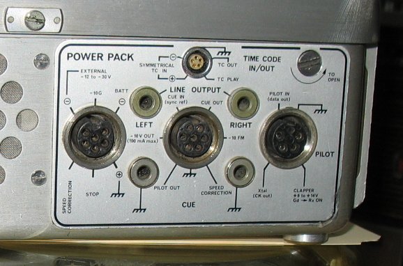

David Waelder Posted December 14, 2013 Report Posted December 14, 2013 [snip] Thanks. At some point, I may want to find out how to disable either, to just have audio recorded onto tape. Maybe I'm missing something here, but I've been wondering why you don't just remove the jumper plug from the external pilot tuchel connector. Actually, looking at the photo supplied, the pilot jumper doesn't appear to be present anyway. The pilot and/or TC signal passed through that 4-pin connector. Unless the signal were jumped from (if memory serves) the Xtal pin to the Grnd, the signal would not carry through to the sync head. Removing it would take the sync circuit out of the path completely. Alternatively, if one doesn't have the screw-on jumper plug and wanted to use sync recording. one could just bend and cut a paper clip to a U-shape and use it with a piece of tape to hold it in place. David Quote
studiomprd Posted December 14, 2013 Report Posted December 14, 2013 rstl99: " I may want to find out how to disable either, to just have audio recorded onto tape. " disconnect the head. " I am not certain just what modifications "by local Nagra distributor" would consist of. " 50Hz or 60Hz pilot selection, if you cannot do it yourself... Quote
