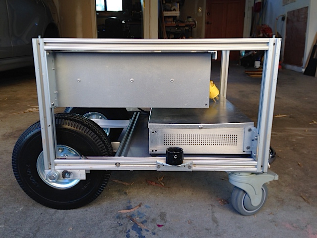

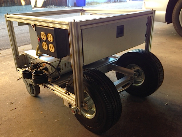

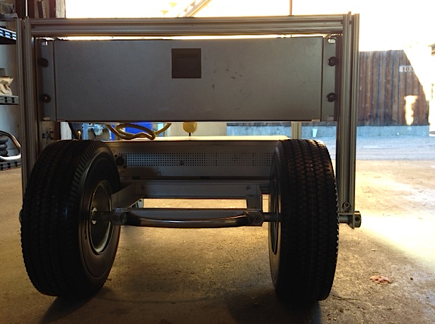

Jeff Wexler Posted January 14, 2014 Report Posted January 14, 2014 I changed the wheels on my cart before the last movie but discovered while working that the wheels I had used (12" motorized wheelchair flat-free tires) were not a good choice. So, after wrapping the job, I completely re-designed the wheel and axle assembly, going back to the inboard style arrangement I had done on several of my older carts. Going the inboard route it is true that some stability may be compromised (though I have never really found that to be a problem) but the benefits are many. The overall width of the cart is just the frame of the cart, not the wheels, keeping it so that the cart fits nicely even in very narrow doors. Also, I can use pretty standard handtruck-style wheels (in this case, 10" flat-free tires). The great advantage of my original design, two piece cart, is that I could work on just the lower frame without worrying about the main part of the cart. Once put back together I will probably not separate the two section again (unless I have to make some sort of modification). Quote

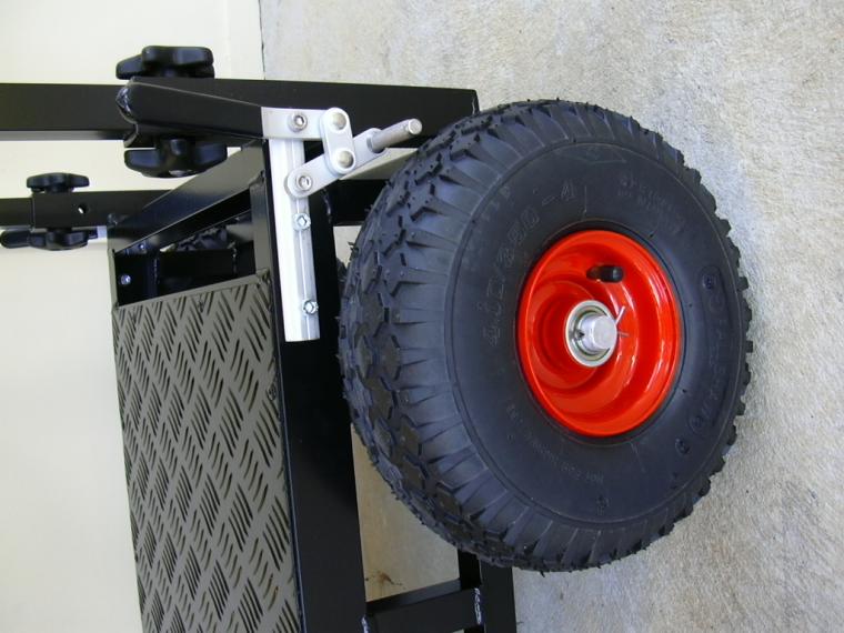

Rob Stalder Posted January 15, 2014 Report Posted January 15, 2014 Nice work there Jeff. I have also looked at the no flat option, for the 4 x 10" wheels on my 2g cart. However one day at my suppliers I saw some & picked one up. I calculated 4 would weigh almost as much as the cart. I do use some 8" ones on the front & they are flat free & don't weigh much - come from somewhere in China. However the 10" ones I use are Fallshaw (Australian made), they are sold in USA.. www.fallshaw.com.au/contact They are not split rims, nicely powder coated. They can come with inner tubes, although lately I have been getting them in tubeless. Problem with that is if you let them down they take a big air compressor to get them inflated again. I am thinking of re-visiting tubes again also. The product code I buy is T350x4DMD-SB20 = T350x4str/SB20 T350 is wheel, 4DMD/4str is tyre (diamond pattern, quite wide), SB20 is 20mm axle... Product page is www.fallshaw.com.au/wheels/pneumatic/steel Maybe worth a thought. Rob Quote
