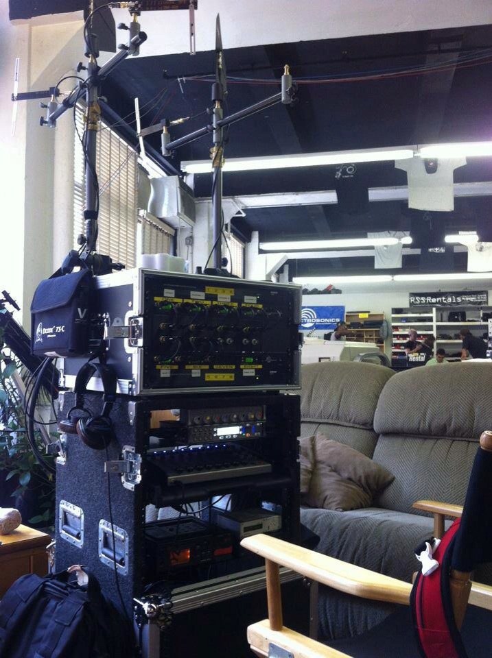

rich Posted January 23, 2014 Report Posted January 23, 2014 you're going to have to show us a bit more detail than that. Quote
Jonathan Reyes Posted January 23, 2014 Author Report Posted January 23, 2014 Top Case: 1 to 8- ucr41a in 2 RMP195 Connected to 2 Shure UA488SWB Custom built BNC jumper from 411a's to UA488SWB 2 PSC shark fins 3 Lectro dipoles (2 for UA488SWB 1 for lectro T4) 1- T4 IFB 1- T2 Boom feed 1- Comtek tx to phase right (IFB Feed) Bottom Case: 788t w/cl8 and CL9 FR2 for BU Recording TC-1 display GR-1 PSC Powermax Ultra Quote
Constantin Posted January 23, 2014 Report Posted January 23, 2014 What do you do with both the CL-9 and the CL-8? Can you use bith at the same time? Quote
Jonathan Reyes Posted January 23, 2014 Author Report Posted January 23, 2014 Can't use both at the same time... I have the cl8 mounted to it just incase it needs to go in a bag rig... Quote
