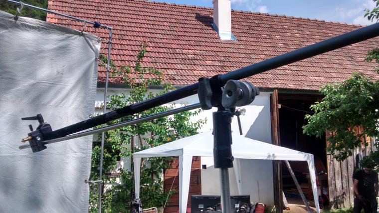

David A-Ribeiro Posted June 2, 2014 Author Report Posted June 2, 2014 This is how it looks like at the moment. There is a weight at the base of the tripod, no worries there. My concern is only that the very cheap boom will not withstand the rycote & shotgun. Quote
Laurence Posted June 2, 2014 Report Posted June 2, 2014 The stresses on the pole as shown are identical to those on a pole held by a boom operator... although theoretically less, since it never gets swung or raised, which momentarily increases the stress significantly. If it can't handle this stress, it's not a real boompole. Quote
David A-Ribeiro Posted June 2, 2014 Author Report Posted June 2, 2014 Yep, no issues at all, sounds good, nice mix with the lavs, another happy sound day in the countryside. Thanks everyone Quote
