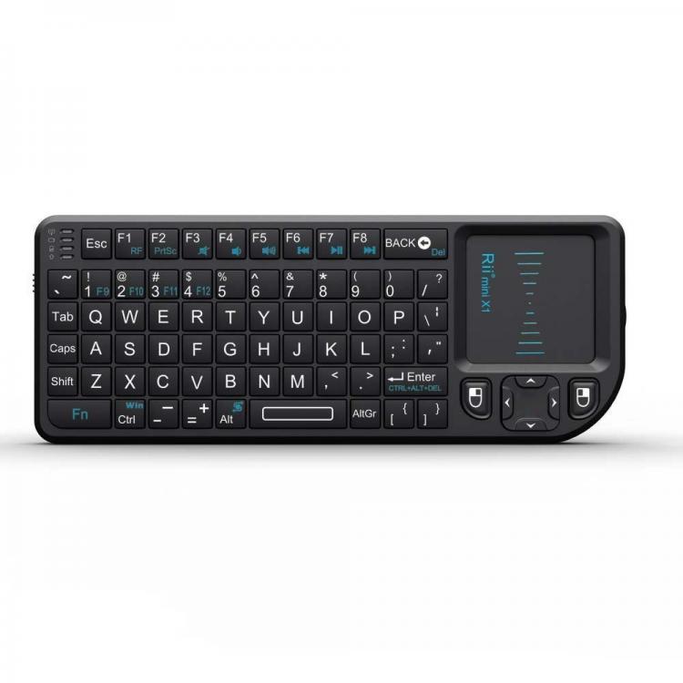

mirko Posted December 5, 2014 Report Posted December 5, 2014 I have read this post now. I recently switched to Fusion and I'm looking for a small keyboard compatible. Jack, maybe you've changed your keyboard, but the one in the photo is what brand name? thanks Quote
Jack Norflus Posted December 5, 2014 Author Report Posted December 5, 2014 http://m.newegg.com/Product/index?itemnumber=9SIA0AT1JD2550&cm_re=mini_wireless_keyboard-_-23-111-052-_-Product FYI - a Nomad compatible key board may not necessarily be compatible with Fusion. Quote

Nate C Posted March 9, 2016 Report Posted March 9, 2016 It doesn't work via the Nomads 2.4Ghz/Zaxnet. You will have to use a dongle. The dongle that comes with the Rii keyboards are low profile (as are most these days). It sticks out less then the TC BNC connector directly above it. Quote
