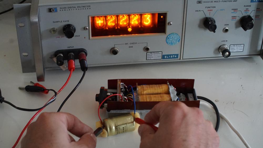

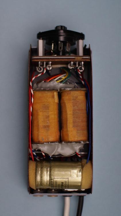

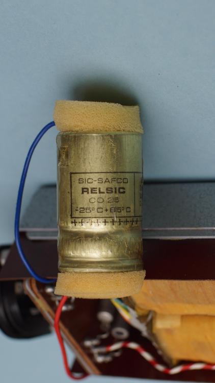

dela Posted September 7, 2020 Report Posted September 7, 2020 On the ATN supplies the ripple capacitor is often completely dried out. It can easily be replaced by a new capacitor (1000-2200 uF, suitable voltage), making the supply as good as new. And without hum. Quote
JMB Posted September 7, 2020 Report Posted September 7, 2020 7 hours ago, dela said: On the ATN supplies the ripple capacitor is often completely dried out. It can easily be replaced by a new capacitor (1000-2200 uF, suitable voltage), making the supply as good as new. And without hum. Dela, this is a good idea. The capacitor is quite easy to access: you open the top screws, after you take off the top cover we have access to the capacitor. No need to touch the bottom screws! In my ATN it is a SIC-SAFCO RELSIC 1000 µF, seems to be 63 - 75 Volt Dimensions: diameter 27 mm x 43 mm long With such diameter we can get a new capacitor of up to 4.700 or even 6.800 µF. To my understanding 50 Volt would do it. I measured the voltage at the capacitor when ATN was on the mains (230 Volt here in Germany), it showed 22,23 Volt To replace the capacitor in the ATN I choose one 25 x 35 mm, 6.800 µF, with 50 Volt. Matthias Quote
JBond Posted September 7, 2020 Author Report Posted September 7, 2020 Looks like problem solved Matthias 👍 nice pictures and tutorial on dela's advice . You produce some very nice posts. Good work, dela, When life long professional Soundmen chime in with actual first-hand knowledge using Nagras to record many hundreds or thousands of Hollywood movies, they stated they always had their Nagras plugged in without any problems. Gave a clear view and opinions on using rechargeables. We will never get a better sense of professional experience with early Nagras than you get from Hollywood Soundmen. After all, they were not recording high school plays at parent night. All along I thought the problems lie with JMB's equipment, not with the memories of the Sound professionals. The capacitor makes sense, when Jeff, Scott, and Philip used the equipment, the capacitors were 50 years younger. Of freeking course, there was no buzzing. These are "Professional Soundmen" - the best there is in sound. These are the men with many hours, many years of "ears on" experience. They would know and remember noise interference better than anyone while producing some of the biggest names in Hollywood Films. It's amazing how much you guys remember about battery times, volts, rewind times, etc. It's like you are still using vintage analog Nagras today. Thank You dela. Time and time again you always help so many people on this site without getting the credit that you fully deserve. Quote
