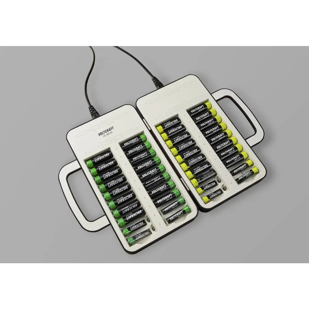

DanieldH Posted August 11 Report Posted August 11 I just came across this thing and don't know what to think about it: https://www.conrad.com/en/p/voltcraft-charger-for-cylindrical-cells-nimh-aa-aaa-2973096.html If you need a NiMH charger for up to 40 batteries this appears to be a good deal and useful design at first glance, but looking closer makes me sceptic and wonder to whom this product may be targeted. - The handle is completely fixed and has no mechanism to collapse for storage - It seems, it will only charge an even number of batteries, though each battery is charged separately - It charges each battery or a given number of them with impulses in series, not parrallel - Switch-off via timer: 9.5 hours user-safety-instructions-2973096-voltcraft-charger-for-cylindrical-cells-nimh-aa-aaa.pdf Quote
