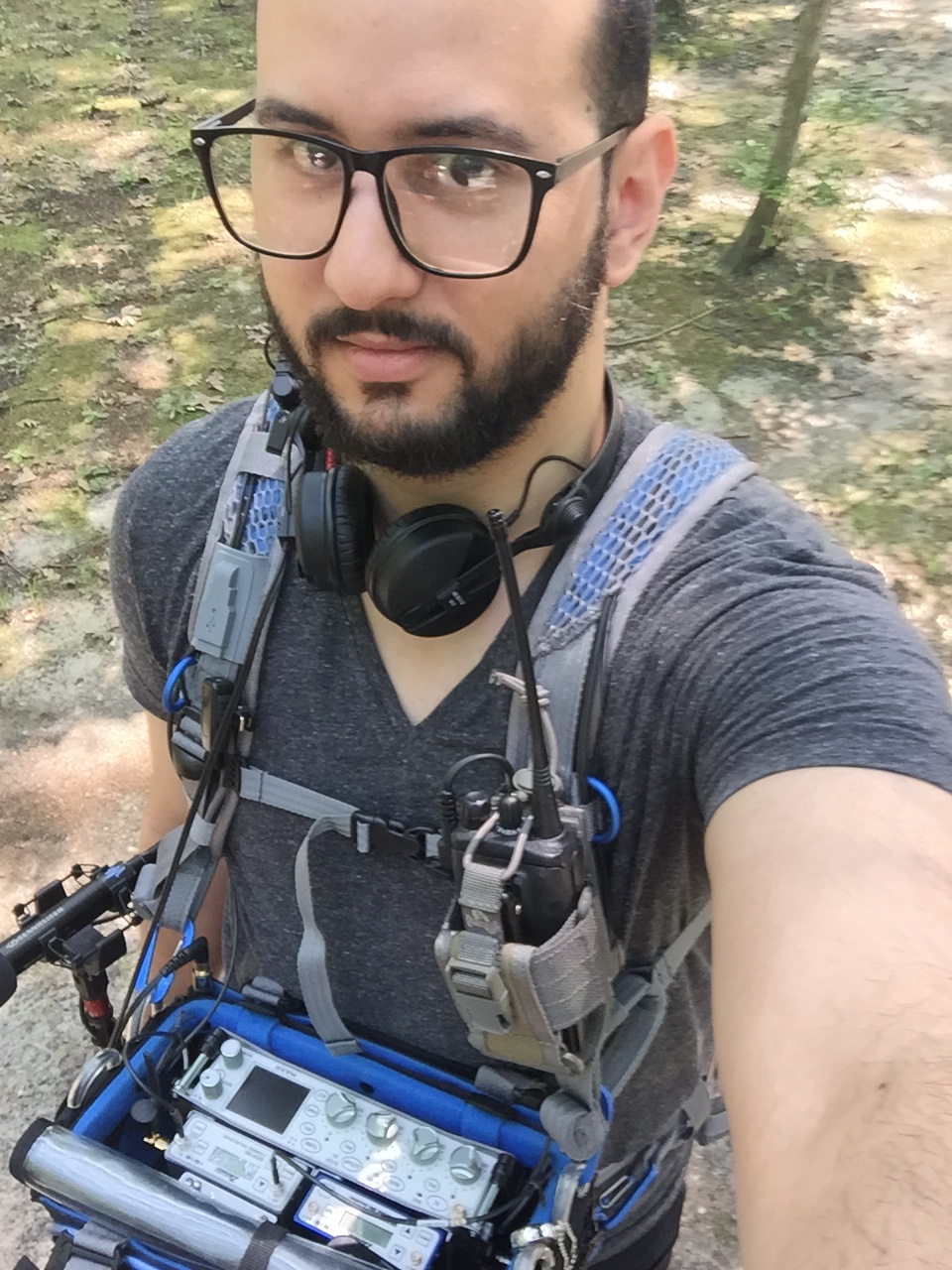

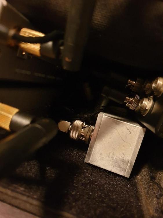

Ze Frias Posted June 27, 2015 Report Posted June 27, 2015 I couldn't see my own picture either, so here it is again: Quote
Aural Fixation Posted June 27, 2015 Report Posted June 27, 2015 Jose, in working with your setup, when you set your bag down to take a break, do you leave the harness attached to the bag, or do you have quick releases for the antenna? I usually keep my harness on at all times de/attaching the bag as needed. That is my only hesitation in using your setup. Quote

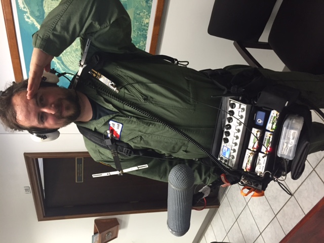

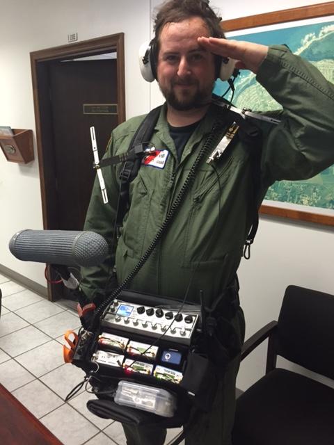

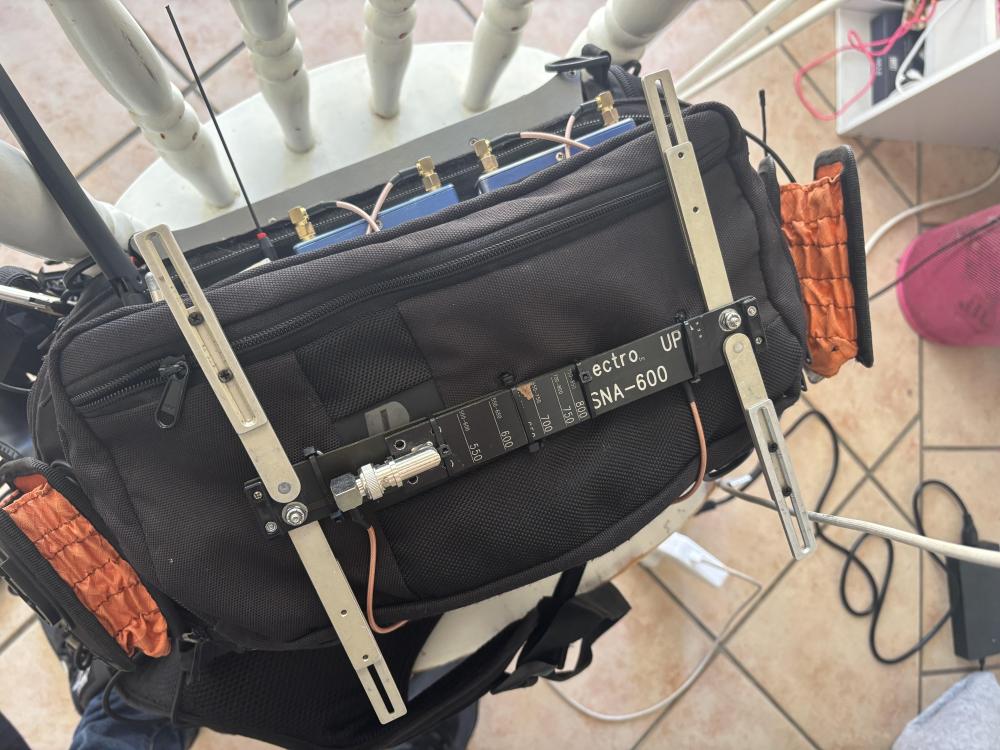

Jason Todd Posted June 27, 2015 Report Posted June 27, 2015 Not the most elegant setup, but the range boost is worth it. Quote
pindrop Posted June 27, 2015 Report Posted June 27, 2015 (edited) Thanks Jason here's a geeky off topic question, what black knobs you got on your Nomad and why? Edited June 27, 2015 by pindrop Quote
Jason Todd Posted June 27, 2015 Report Posted June 27, 2015 They're Sound Devices 664 knobs. I like the feel of them better than the stock Nomad knobs. They have a little bump at the front of the knob that I think makes them a little easier to grab when I'm not looking. Quote
Glen Trew Posted June 27, 2015 Report Posted June 27, 2015 Not the most elegant setup, but the range boost is worth it. The dipole cable is essentially the same thing, with probably the same performance, with fewer connections and nearly invisible, not to mention much less expensive. The dipole cable is definitely the way to go for external antennas on bag rigs. Quote
Glen Trew Posted June 27, 2015 Report Posted June 27, 2015 They're Sound Devices 664 knobs. I like the feel of them better than the stock Nomad knobs. They have a little bump at the front of the knob that I think makes them a little easier to grab when I'm not looking. Good to see the HN headset with talkback boom being used, too. Quote
Jason Todd Posted June 27, 2015 Report Posted June 27, 2015 Thanks, Glen. Love the high noise headset and the slate mic is super useful. The high noise headset was essential in protecting my ears from gun shots, noisy boat motors, and a hundred other things on the police show I just worked on and I loved having the slate mic to have private convo's with producers on Comteks. I have the dipole cables that Lectro makes (in Block 20) in addition to the SNA600's. In my experience, the SNA600's got me better range, but it's certainly not scientific and not dramatically better. Just my experience. I'm still going back and forth between the two. Quote
Jason Todd Posted June 27, 2015 Report Posted June 27, 2015 Also, I had shark fins on a stereo bar with a pistol grip that I could quickly switch to on occasion when I really needed to push the range for police raids. It was much faster to just disconnect two BNC's two swap back and forth between the antennas. Quote
Ze Frias Posted June 28, 2015 Report Posted June 28, 2015 Jose, in working with your setup, when you set your bag down to take a break, do you leave the harness attached to the bag, or do you have quick releases for the antenna? I usually keep my harness on at all times de/attaching the bag as needed. That is my only hesitation in using your setup. the coax dipoles rigged on my harness are now terminated to BNC, which is a quick disconnect. I keep the harness on at all times. I have the dipole cables that Lectro makes (in Block 20) in addition to the SNA600's. In my experience, the SNA600's got me better range, but it's certainly not scientific and not dramatically better. Just my experience. I'm still going back and forth between the two. I too have the same experience, but the coax dipoles work pretty darn well for almost all my bag jobs. Quote

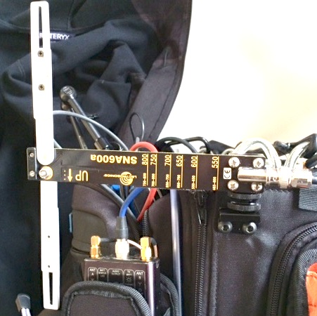

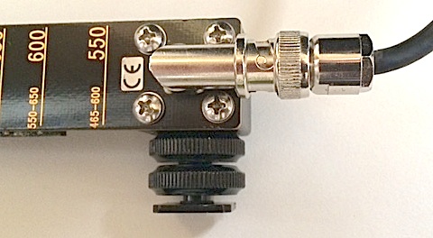

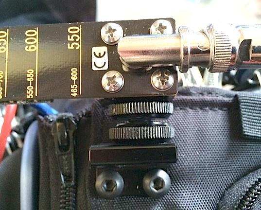

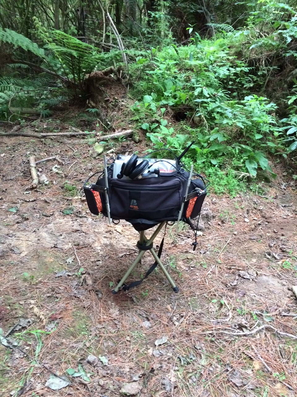

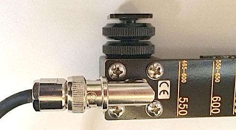

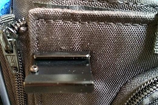

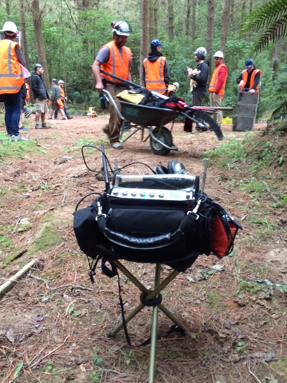

pindrop Posted July 15, 2015 Report Posted July 15, 2015 (edited) Just trying this as a quick release mount for SNA600 on the side of an Orca OR41 using Smallrig coldshoe components - So far so good. http://smallrig.com/ Cold Shoe Mount 1593 Cold Shoe Adapter 3/8 inch screw 1275 Edited July 15, 2015 by pindrop Quote
Jack Norflus Posted July 15, 2015 Report Posted July 15, 2015 Nice! I've been planning on doing something like this for a while - everything I was thinking about wasn't nearly as elegant so I will be stealing your idea. Quote
pindrop Posted July 15, 2015 Report Posted July 15, 2015 (edited) Nice! I've been planning on doing something like this for a while - everything I was thinking about wasn't nearly as elegant so I will be stealing your idea. Excellent, great to be able to make a small contribution, I've learned a lot from this forum, and a great many things on the Zaxcom front from you Jack. Edited July 15, 2015 by pindrop Quote
Jason A Posted July 15, 2015 Report Posted July 15, 2015 Just trying this as a quick release mount for SNA600 on the side of an Orca OR41 using Smallrig coldshoe components - So far so good. http://smallrig.com/ Cold Shoe Mount 1593 Cold Shoe Adapter 3/8 inch screw 1275 Jeesh! Way to show me up Pindrop! Great, inexpensive and light option. I'm stealing it as well:) Quote
pindrop Posted July 15, 2015 Report Posted July 15, 2015 Great, Smallrig make nicely made useful bits at very reasonable prices. The only thing that worries me is my SNA up arrow is pointing down, will my sound be upside down Quote
