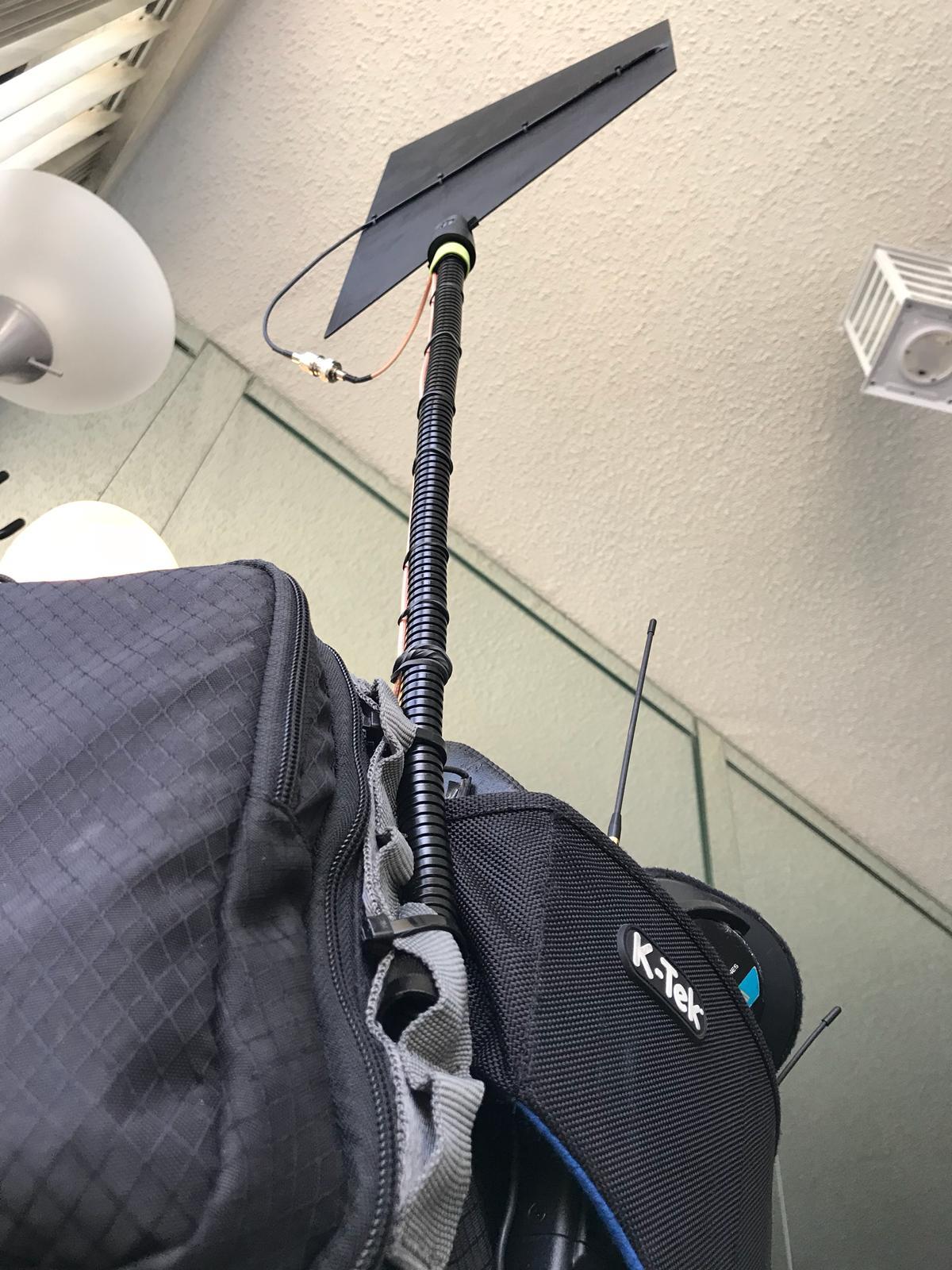

Guillermo Ursini Posted September 4, 2019 Report Posted September 4, 2019 Well here is what i did, 19" flexible gooseneck ($10), i was radio ham in Argentina and work on broadcast radio, i know i need to clear space and elevate the antennas. This option give me a fast and easy way the change the antenna. LECTROSONICS SNA-600 and LPA WA5BJV 400-1000 i build. I need to try this on real shoots!!! Quote

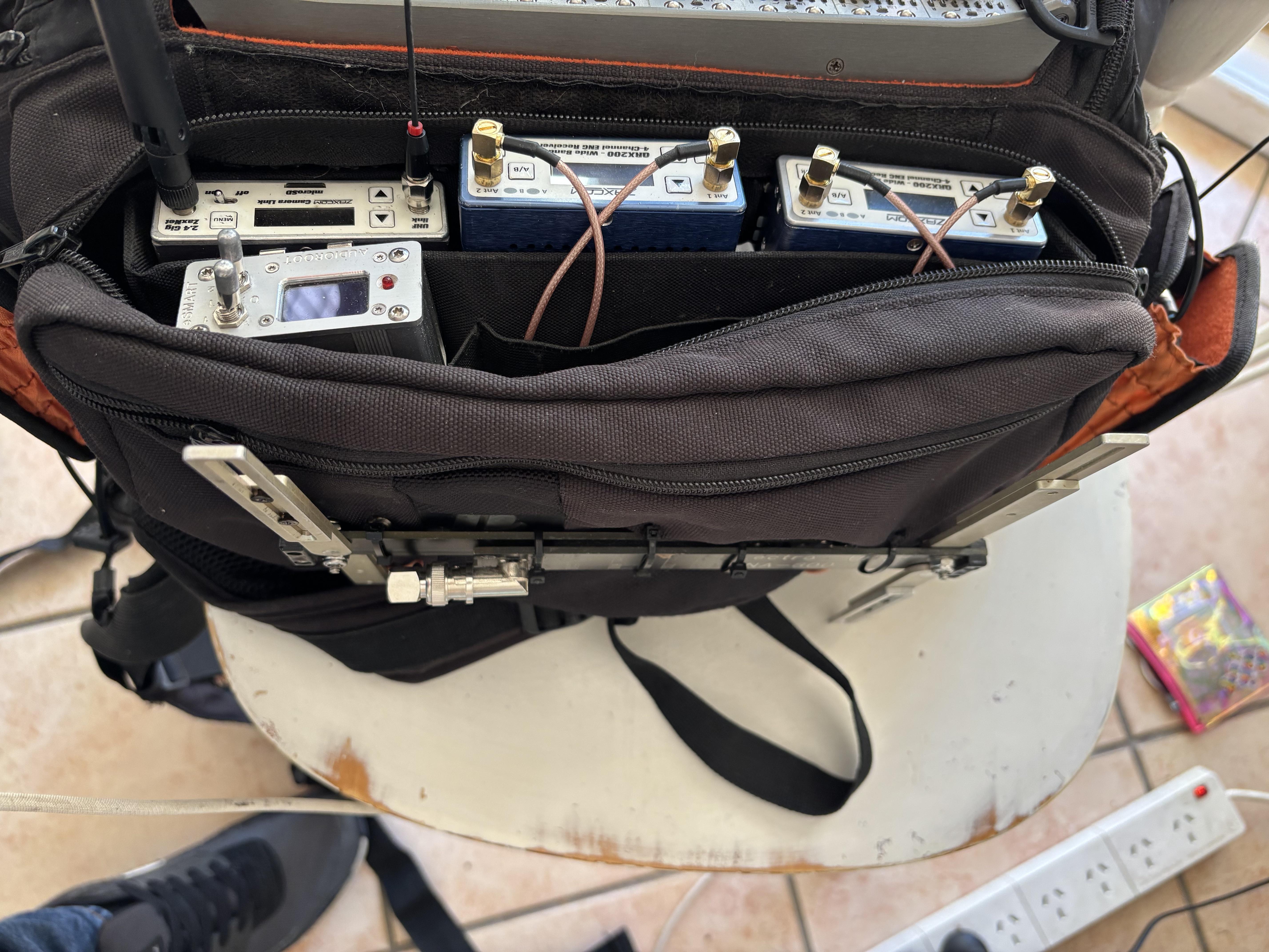

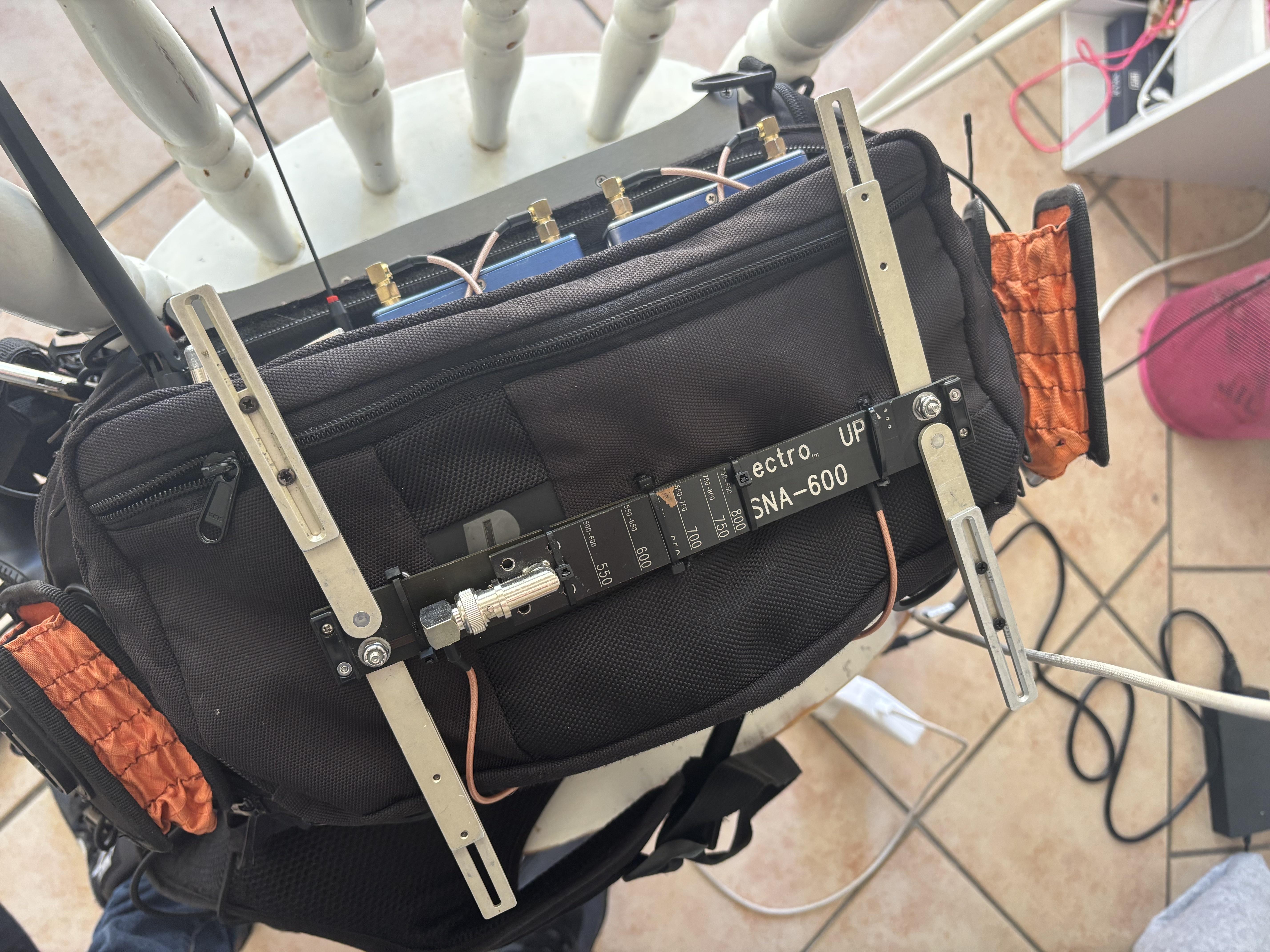

renaud82 Posted July 12, 2024 Report Posted July 12, 2024 Hey guys, I dug this post because I needed to know how to attach my SNA6000. I bought the orca OR150 antenna holder but it's total crap. I own 2 orca bags but there's no way to make them fit on it. So thanks to your pics and ideas I am now lighter. The antennas are held together with some velcro and attached to the bag thanks to the boom holder on the front (which I do not use). thx again IMG_4217.heic IMG_4216.heic Quote
