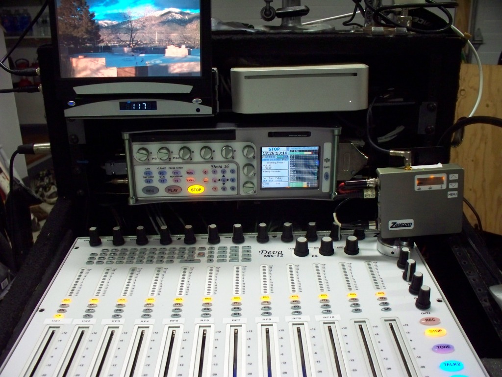

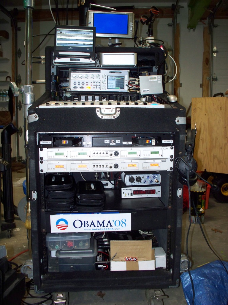

bigmaho Posted November 5, 2008 Report Posted November 5, 2008 Hi All, I've received a few requests to 'show my stuff'. But you're all a bunch of cheapskates. Not one $5 bill in my g string! (but I'll check the rest of my guitar when I get a chance). Anyway, here's the messy cart with my new Deva 16 and Mix 12. Also includes 8 Zaxcom radios, 2 Audio Ltd receivers, rf splitter amp, Comtek transmitter, Zaxcom IFB, WinRadio Spectrum Analyzer, 2 monitors, Mac Mini, Power Supplies and Distro, Antenna Mast for UHF and 2.4 gHz, Comtek Antenna, Presonus Firebox, etc. This cart covers just about all my recording and playback needs. It weighs in at 210 lbs. Now if I can only figure out how to get the pictures on here.... Hmmm, 'insert image' isnt working. Might be Mozilla. I'll try Internet Explorer. Be right back... Quote

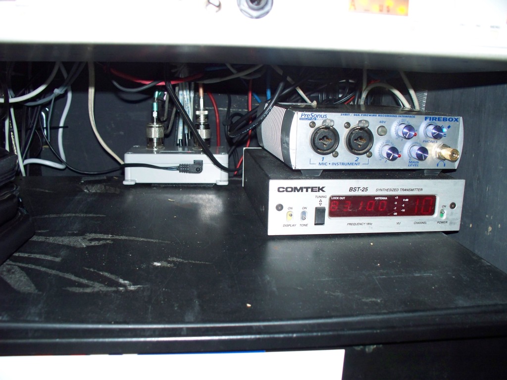

bigmaho Posted November 5, 2008 Author Report Posted November 5, 2008 And a close up of the middle - The RF amp for my IFB (boosts 100 mw to 1 watt), the Firebox and the Comtek BST xtr Quote

Matthias Richter Posted November 6, 2008 Report Posted November 6, 2008 And a close up of the middle - The RF amp for my IFB (boosts 100 mw to 1 watt), the Firebox and the Comtek BST xtr Hi Billy, what is that Firebox doing? And have you got portable RX in addition to the RX4900? I will get at least two for the out of the porta jobs. btw - I will get two of those Areitec phantom supplies made for the trx 900 by 2moro ... Matthias Quote
bigmaho Posted November 6, 2008 Author Report Posted November 6, 2008 Hi Matthias, The Firebox is the interface between my Mac Mini and the Deva. I run all playback through the Mini. The music people can deliver to me via CD, or USB dongle, or even email to my cell phone. I load it into the Mini, do any editing, and use a simple Mac program called Sound Studio for playback. The music outputs from the Mini fire wire into the Firebox and from the firebox I take a digital output and feed it back into the Deva where I have full control. While the Mix 12 has 12 pots, you can still use the 8 pots on the Deva, so I route the playback through the Deva faders. It's an incredibly flexible system. And yes, I have 1 portable Zaxcom receiver AND I built a 'road rig' which is an Audio Ltd Quad box married to two Zaxcom studio receivers, so I can quickly run 6 radios in a small package for car rigs or in remote locations where I can't bring the cart. I can also add the Zaxcom portable receiver to that rig for a total of 3 digital and 4 analog radios. The Audio Ltd Quad box is nice because it has SMA antenna connections for 4 additional diversity receivers so I can run up to 8 radios through one pair of antennas. With the Deva 16 and Mix 12 combo I still have 2 unused line leval analog inputs available, so I could easily add 2 additional radios. If you notice the black 'home brew' looking rig above the 2 Zaxcom RX4900's, it was a prototype rig Zaxcom built for it's digital studio receivers. It has a broadband rf amp with 12 inputs. I saw it on the shelf at Zaxcom's factory and bought it. I use it as the 'rack' for 2 Audio Ltd receivers, and I also feed my WinRadio from it (the WinRadio is hidden in the photos underneath the mix 12). I still have 7 additional antenna outputs so it would be easy to add more radios if I was on a crazier than normal shoot. If things get really out of hand I can even use the Mac Mini and Boom Recorder (and the Firebox) to record 4-6 additional tracks. So without much effort I can squeeze 22 tracks out of this little cart. (and god help us all if it ever comes to that!) Best, Billy Quote
bigmaho Posted November 6, 2008 Author Report Posted November 6, 2008 Hi Jeff, Thanks for your comments (and for running this site!!!!!) And yes, there's quite a bit of horsepower on a small cart. It's a New York thing. I'm always carrying it up and down stairs so it can't be a Hummer. I've been eyeing the Mix 12 for a while, but was in no rush to make the change. Even after I bought the Deva 16 I wired it into the cart making optimal use of the Cameo AND the 16, using all the I/O's on the Cameo and many more on the Deva. Unfortunately, as soon as I had it all rigged the Cameo died, so I had to re-rig faster than Patton got to Bastogne. Even if my Cameo is revived I'll stick with the Mix 12. It makes my cart and wiring MUCH simpler, and as I mentioned on RAMPS, one of the benefits I didn't expect is that the cart is MUCH quieter. I had ground loops all over the place and by eliminating the Mixer I eliminated most of the loops. That alone makes the change over worthwhile for me. Also, if anything should happen to the Mix 12 or the Deva, it's a very fast and easy swap out. If my Mix 12 dropped dead I could quickly reconfigure without changing one cable, to mix through the Deva until a new Mix 12 arrived (and the Mix 12 has only one connection to the Deva). Hope you are well. It had been slow here in NY movie-wise, so I'm starting an episodic on Monday. Still can't believe last night!!!! All the best, Billy Well, you figured it all out Billy... I knew you could do it (posting pictures here, I mean) and we all really appreciate the effort. You have got more going on with your cart than I think I have ever seen; if you study the lineup of equipment you have a tremendous amount of recording "horsepower" available. Thanks for posting here ... I have been reading all your Mix 12 comments on r.a.m.p.s. and it really interests me (not ready to take the plunge, yet, but I understand how you were somewhat forced into that decision quite abruptly). Hope all is well with you. Best regards, Jeff Wexler Quote
Noah Timan Posted November 6, 2008 Report Posted November 6, 2008 One thing that might not be immediately apparent from the photos is (despite carrying so much stuff) how very small Billy's cart actually is -- I remember being really knocked out when seeing it in person at the compact size. Quote

patrickveigel Posted November 6, 2008 Report Posted November 6, 2008 Hey Billy, what du use as an antenna for the IFB 100? I looked at a couple of ordinary WI-FI antennas but the plug/cable is wrong and adapters seem to be extremely hard to find in Germany. Also with boosting your IFB from 100mW to 1W I assume your talking about the Comtek, not the IFB 100? Thanks Patrick Quote
bigmaho Posted November 6, 2008 Author Report Posted November 6, 2008 Hi Patrick, I've tried a few 2.4 gig antennas and ended up with a small patch antenna that has about 8 db gain. This isn't it, but it's similar, http://www.wlanantennas.com/product_info.php?products_id=31 And no, I did mean the ifb. My Comtek is the BST transmitter that has great range (when used with the large Comtek antenna). The IFB transmitter puts out 100 mw, but in order to equal the range of my UHF wireless mics I have to boost the power of the 2.4 gig IFB signal. So the little amp in the picture boosts the ifb form 100 mw to 1 watt. At a watt, the ifb range is about the same as the rf mic range, so if an actor is near the end of their radio range I still have ifb range so I can adjust the transmitter gain from my cart. Billy Hey Billy, what du use as an antenna for the IFB 100? I looked at a couple of ordinary WI-FI antennas but the plug/cable is wrong and adapters seem to be extremely hard to find in Germany. Also with boosting your IFB from 100mW to 1W I assume your talking about the Comtek, not the IFB 100? Thanks Patrick Quote
Kevin Sorensen Posted November 7, 2008 Report Posted November 7, 2008 Hello Billy, Can I just ask, how are you powering up all of your gear ? Also it looks like you are not using a second recording machine. If that's the case, what are your thoughts about using a back up recorder? And what typically ends up being the media of choice for dallies/post etc.? Any archiving for sound editors, Raid etc. ? KKS Quote
bigmaho Posted November 7, 2008 Author Report Posted November 7, 2008 Hello Billy, Can I just ask, how are you powering up all of your gear ? Also it looks like you are not using a second recording machine. If that's the case, what are your thoughts about using a back up recorder? And what typically ends up being the media of choice for dallies/post etc.? Any archiving for sound editors, Raid etc. ? KKS Hi Kevin, No backup machine on the cart, except I consider the Deva itself its own backup. I write to either DVD/RAM or CF card for distribution to post and use 160 gig hard drives that stay with me. Each drive lasts for about 8-12 weeks of shooting. Also, since I'm using Zaxcom recording radios I guess I'm running 10 backups (though I have them set to loop record, so they overwrite themselves every 12 hours or so. So it's only a short term backup like if I forget to hit record or I lose power during a take). Powering is all AC into the cart. I have a 10 amp 120 - 12v power supply with 4, 4 pin xlr outputs, a DC supply rail with 12 mounting posts so I can route 12v all over the place (it's made for Ham radio shacks by MFJ - http://www.mfjenterprises.com/Product.php?productid=MFJ-1116 and a Mac Mini AC power supply. My Aux cart (ok, I'll get a photo of that ugly beast someday) has all my Zeppelins, Comtex Receivers, expendibles, cables and adapters, basic tools, AND an AGM Marine battery and Inverter/Charger. I can power off the Aux cart alone for 8 hours (probably a good bit more now that the Cameo is retired), or, when there is house or genny power, I power through it, and if power is inadvertantly pulled, the inverter takes over instantly. Best, Billy Quote
