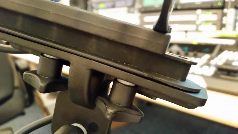

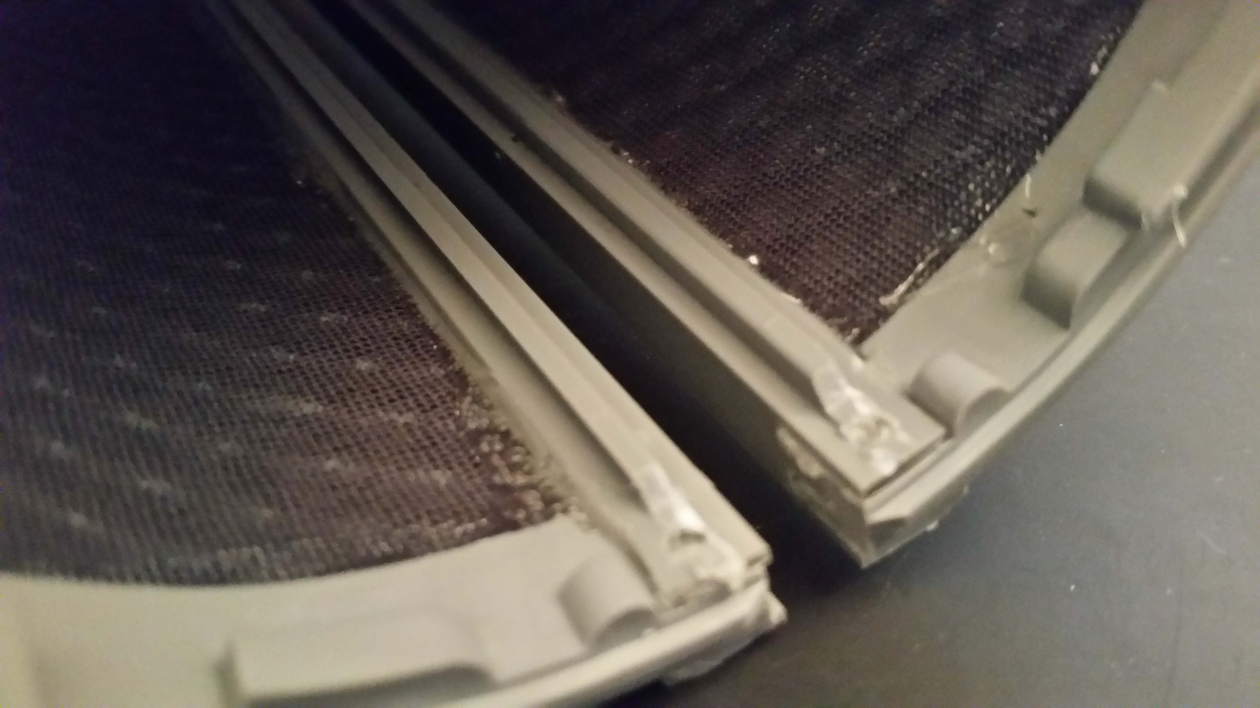

chrisyking Posted January 26, 2016 Author Report Posted January 26, 2016 O.K. so I worked out what is happening here. This may be of value to Rycote or anyone using Rycote baskets. If you look at the bottom basket photo there is an internal ridge which runs along the length of the groove. This ridge buts up to the rubber seal shown in the photo on the top. If you then tighten the two knobs, this ridge will bite into the plastic that the lyre is attached to, making a direct vibration path from the bottom bit of plastic to the top bit that the lyres are attached to. Basically as soon as you tighten the knobs, the thing stops isolating vibration all together. This is a major design f$%k up. If you loosen the knobs, the vibration noise goes away. She solution is to stop that ridge biting. I'm going to try a few things and will get back to you. Chris Quote
pkautzsch Posted January 26, 2016 Report Posted January 26, 2016 Sorry, maybe I just don't get it, but that's exactly the design that works flawlessly in our setups with normally tightened screws. The screws themselves also make a solid connection (vibration path) between bottom and top part when tightened. The actual vibration reduction is done by the lyres - else, a INV-7 with no elastic parts apart from the lyres themselves would have the same LF handling noise issue, wouldn't it? Maybe something with the screws? Cable? - But if you loosen them, the whole thing's gonna rattle. I remember Ambient booms to be more susceptible to handling noise, but we use Panamics and K-Teks most of the time. What requires you to do any handling on the boom (except from swinging) during dialog? Quote

chrisyking Posted January 26, 2016 Author Report Posted January 26, 2016 Maybe there's been a change in design then....? With the ones you have is there a noticeable difference between the mount with and without the basket? Without the basket my WS1 is pretty much silent when I tap the boom, but with the basket it's awful, and looking at the design I can see why. I bought it new arrived yesterday.... Can you look at your ones and see if they have the ridge? Don't get me wrong, in every day use it would be fine as long as you don't hit the boom, but it just seems funny that the well designed suspension mount would fall to pieces on vibration once the basket is on.... I do a lot of media scrums where boom poles are being hit. Sports and red carpets. Quote

chrisyking Posted January 26, 2016 Author Report Posted January 26, 2016 The point is that without the basket, the thing never really gets tight as the mic platform is just sitting on rubber. The screws are pushing against the rubber, but they are not totally in tension as they are only fighting the rubber, so the rubber really kills the vibration. Once the basket is in, the whole thing is solidly locked up with the entire length of the seal being solid, plus the screws being properly in tension. I'm not saying the Rycote isn't useable, it's industry standard. It just seems like this might be really easy to fix so that you get amazing vibration isolation with or without the basket. Quote
jbuerjes Posted January 26, 2016 Report Posted January 26, 2016 Hi, I am using the WS1 + MZL for a Sennheiser 8060. (My basket has the ridge as well.) And yes, there is a little bit of a plus of handling noise when the basket is mounted. But it is not as crass as you describe it. May be you have a defective item? I still love this set up because it is so comfortably small and along with a short ambient boom (QP 450) I can work all day almost effortlessly. Quote
chrisyking Posted January 26, 2016 Author Report Posted January 26, 2016 Yes maybe mine is dodgy. Are there any washers in your system? I just had two under the thumbscrews. Are there any internally? Also, how do you find the 8060. I just bought mine. Do you find it O.K. in noisy situations? The main thing is that now I know what is causing the problem, I can fix it. I really love the size of this unit, and I took it out for a PTC today. Was quite bright in just the basket, but nice and crisp. Sounded O.K. background noise wise on a noisy street. I'll do some comparisons with the 416 we have here over the next week or so.... 39 minutes ago, Richard Thomas said: I think I know what it is- is the MZL cable touching the basket? No, I checked that. It is bad even with the back off so the cable is free. Quote
jbuerjes Posted January 26, 2016 Report Posted January 26, 2016 Yes, two washers under each screw, no washers on the inside. In noisy situations (red carpets, mixed zones in sports) I'd hope that I am working for a reportage where handheld microphones “are allowed“. I worked on a noisy fair the other day and I was lucky to be able to boom from below so the bodies were blocking much of the noise. And if you do tests with the MKH 416 and the MKH 8060 please write about this! Quote

daniel Posted January 26, 2016 Report Posted January 26, 2016 Chrisy, I now use a super-shield (which is great btw) but from what I remember of the modular system there are usually several holes the tightening screws can be put in (depending which 1 you have). I can't work out from the photo if you have the medium suspension but if you do it should have at least another hole for the tightening screws - I would try it with these screws spaced as far apart as possible. Aside from that, you'll always get more handling noise between takes as you wont be trying as hard and compared to the MKH60 almost any mic will feel more sensitive to handling - the MKH60 (imho) has fantastic characteristics in this respect as well as reach. For what you're doing I think a TAC!T cable would also really help you out as the 8060 doesn't have a bass cut (or high pass) option. dr Quote

chrisyking Posted January 27, 2016 Author Report Posted January 27, 2016 Yes I have the MZL kit 1 which has the conbox included. I noticed the cable they pot on the conbox is too long and hots the back of the basket unless you put the mic quite far forward. Either way last night I applied some small adhesive foam squares to various bits of the mount so that now the basket ridge shouldn't transfer vibration to the mic. Will test later and let you know. Quote
