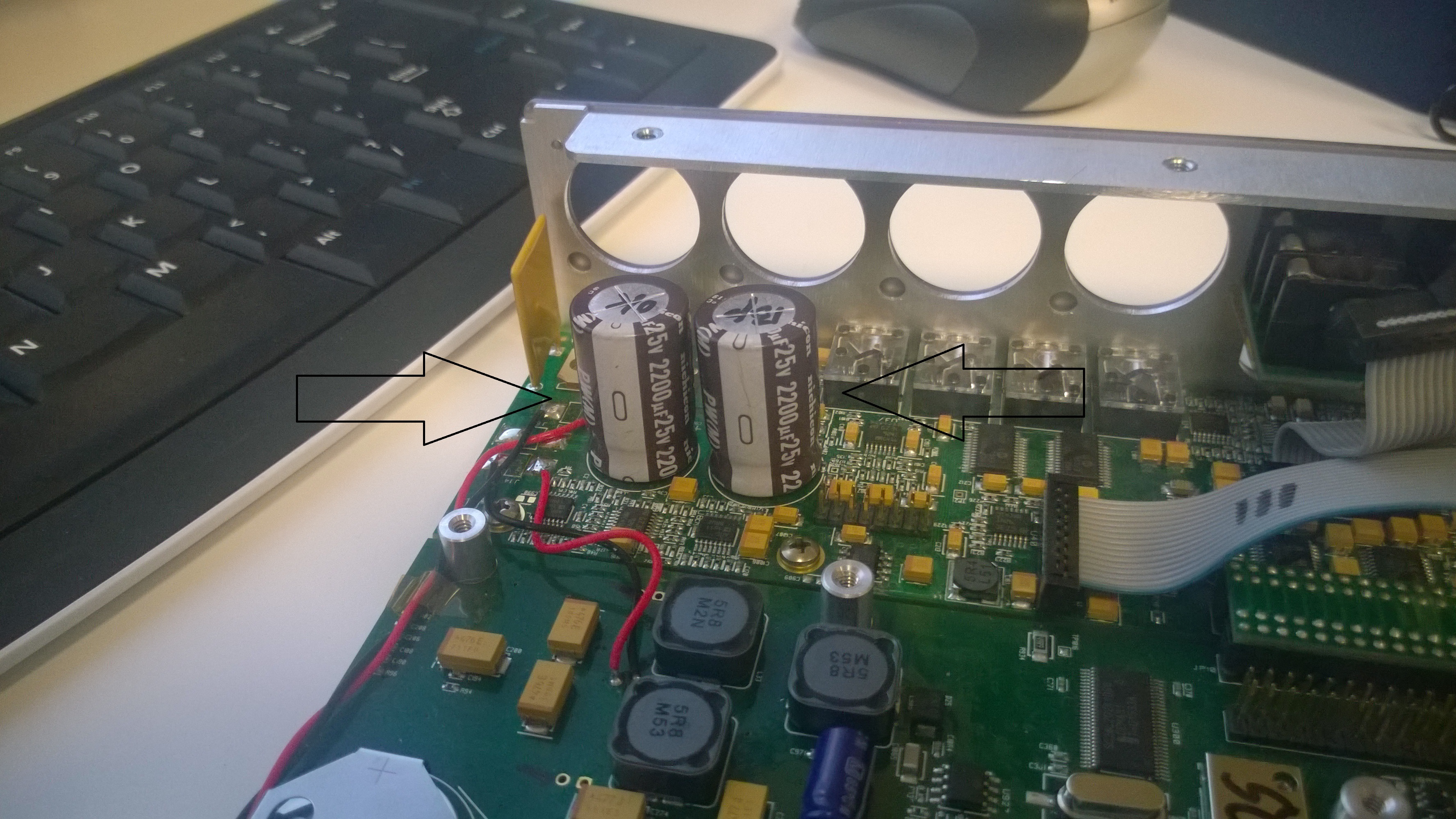

PTA Posted June 16, 2016 Report Posted June 16, 2016 1 hour ago, RadoStefanov said: Just need to share a little warning: ZAXCOM NOMAD,MAXX AND MIXPLEXER1 USERS BE AWARE: Inspired Energy battery has issues with Zaxcom gear AC filters which trips the battery and resets for approximately 75 seconds. 75 seconds is a long time our world. "waiting on sound" Yes, I'd love some specifics on all of this as to what causes this and how to avoid it. Quote

RadoStefanov Posted June 16, 2016 Report Posted June 16, 2016 39 minutes ago, berniebeaudry said: When does this happen? On initial power up with all devices turned on? I can trip my BDS sometimes if I power up everything at once. I have the Nomad on the unswitched port and turn it on separately and that seems to solve the problem. What are AC filters? Just curious on all of this because I'm considering switching to this type of battery at some point in the future. 18 minutes ago, PalmerT said: Yes, I'd love some specifics on all of this as to what causes this and how to avoid it. rolling sound . Will post specifics later. Quote
Glen Trew Posted June 16, 2016 Report Posted June 16, 2016 Like most rechargeable batteries, these have internal overload protection for the cells and internal wiring. When equipment is turned on, the instantaneous current requirement can be much higher than he equipment draws when in normal operation. Therefor, if all equipment is turned on at the same time, the combined startup current can exceed the rated capacity of the supply (in this case, the battery) and trigger the battery's internal circuit breaker. This can happen with any supply or any battery, depending on the capacity of the supply and the combined in-rush startup current of the equipment. If this happens with your bag rig, decide which piece of equipment would be the most convenient to keep turned off until all the others have powered up, and then turn it on a couple of seconds after everything else, or maybe turn it on first (using the unswitched outlet of a BDS like berniebeaudry described above), and then everything else. Quote
RadoStefanov Posted June 16, 2016 Report Posted June 16, 2016 When I first dived in to Inspired Energy batteries I was getting strange power malfunction. Glenn Sanders and the product engineer from Inspired Enrgy helped me pin point the issue. Zaxcom gear "Nomad, Maxx and Micplexer1" uses 2200 mFD caps that help with AC filtering. They are marked C986 with white font. They trip the battery internal circuit for 70-75 seconds especially when the battery is fresh from the charger. Both caps or only one should be removed. "with only one removed the trip still occurs but not as often" I don't see a situation where I would use AC so took off mine. No problem with the caps off. This problem was experienced with all flavors of Inspired Energy Batteries - the originals, AudioRoot and Remote Audio. I would not recommend these batteries for Zaxcom users without my mod. Quote

RadoStefanov Posted June 17, 2016 Report Posted June 17, 2016 2 hours ago, PalmerT said: It seems like some users have had issues with Zaxcom stuff and the batteries tripping, but then other people like José don't have issues. It would be interesting to see if this is a difference in setup or if it is a difference in gear specifics. I bet I can trip Jose's gear especially if he is not going through the bgdu distro. It is not magic. It is electronics. And again if you don't care about AC power it is absolutely correctable. Quote
