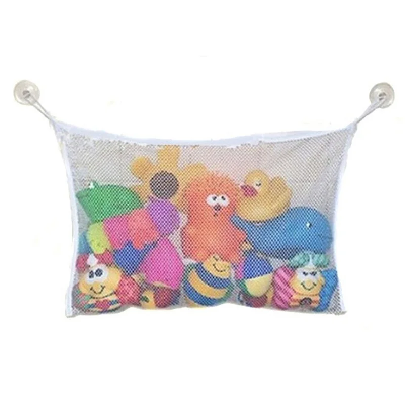

Matt Bacon AMPS Posted January 14, 2017 Author Report Posted January 14, 2017 21 hours ago, JackHenry said: I'm currently designing the innards of a Pelican iM3075. It's a very large case and I'm trying to figure out a way to use the lid cavity to store my rolled cables (when using the case vertically). If you have something in mind for your design for cable handling, spit it out....... From what you have mentioned my initial thought would be to secure some netting with an elastic opening to prevent them from falling out. How many and what type are you talking? XLR cables or small timecode cables? 18 hours ago, Jan McL said: Like where you're going with this. Might be fun to have optional side tables, too. Wonder about your thoughts relative to having only two wheels. Perhaps simplicity is best here. Yes this could potentially be possible as an optional add-on. Yes I considered having front casters during the design process. This could also be an option (a tall version and a short version) but would reduce the available storage space which I considered more important. Am I wrong? When tipped on the rear wheels they should big enough to transverse over all but the toughest terrain. Aspects such as weight I think are also a consideration especially if you are lifting it up a set of stairs. Quote

JackHenry Posted January 14, 2017 Report Posted January 14, 2017 Matt, I'm talking about two or three 25 metre long rolled 2 channel Mogami 2930Sent from my iPhone using Tapatalk Quote
Matt Bacon AMPS Posted January 14, 2017 Author Report Posted January 14, 2017 26 minutes ago, JackHenry said: Matt, I'm talking about two or three 25 metre long rolled 2 channel Mogami 2930 Sent from my iPhone using Tapatalk Something like this... Portable-Bathroom-Baby-Toys-Storage-font-b-Net-b-font-font-b-Bag-b-font-with.jpg but without the toys in them. You get the idea though. Quote
