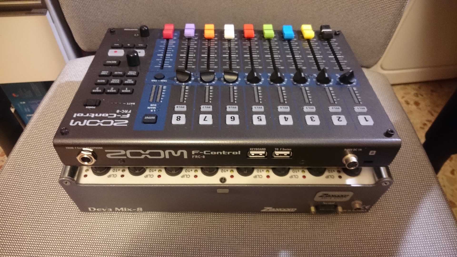

Philip Perkins Posted March 25, 2017 Report Posted March 25, 2017 The FRC is actually too big, I think, much bigger than the F8. I was hoping for something about 8" square....sort of like the Zax mix 8. I also really want it to incorporate a small keyboard, so there is just one "extra thing" instead of two. Quote
efksound Posted March 25, 2017 Report Posted March 25, 2017 5 hours ago, Philip Perkins said: The FRC is actually too big, I think, much bigger than the F8. I was hoping for something about 8" square....sort of like the Zax mix 8. I also really want it to incorporate a small keyboard, so there is just one "extra thing" instead of two. the FRC8 is almost the same size as the Mix8 , but a lot thinner Trade off for the short faders,is getting a lot more of control, in fact you can control everything of the F8 from the FCR Quote
