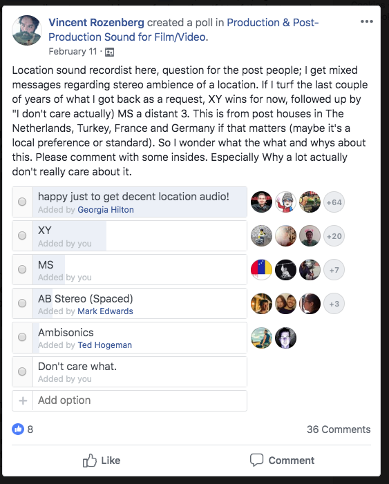

Vincent R. Posted April 23, 2019 Report Posted April 23, 2019 I actually ran a poll last time in a post production group, what the post guys and galls actually prefer. These where the results (I think we can ignore the first option...); Quote
pillepalle Posted April 23, 2019 Report Posted April 23, 2019 @ Jim Feely Well... I'm surely the last person to ask what is comon on sets *g* But all the sound guys that I've asked recommended M/S. With every other technique you have a fixed recording angle, that might not be right in that certain situation. It's super flexible because you can use it with nearly every microphone as Mid-Channel, depending on what you want to achieve. And it's super compact and easy to use. If you have little time to setup it might be the best choice... Greetings Ps: Interesting Poll, Vincent. So most people go for an 180 degree recording angle and good localisation of the sound sources. Quote

Vincent R. Posted April 23, 2019 Report Posted April 23, 2019 I think what I took from the poll results and all the responses from the post people in the group, is to ask the post person what they prefer, if at all (some really are not bothered with ambience stereo files at all, go figure). Of course that is that you already know the post house. Basically what I already try to do if possible. To put it very blunt; it doesn't matter shit what WE like or prefer (Location sound recordists), but it matters what THEY want (post houses). Quote

Constantin Posted April 24, 2019 Report Posted April 24, 2019 20 hours ago, Vincent R. said: To put it very blunt; it doesn't matter shit what WE like or prefer (Location sound recordists), but it matters what THEY want (post houses). And to that end it makes a lot more sense to use an M/S rig and just not use the S, rather than use an XY rig where you may end up with two bad signals. Maybe what they meant when they chose XY was that they prefer matrixed MS? Quote
