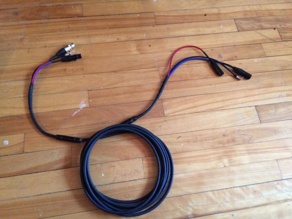

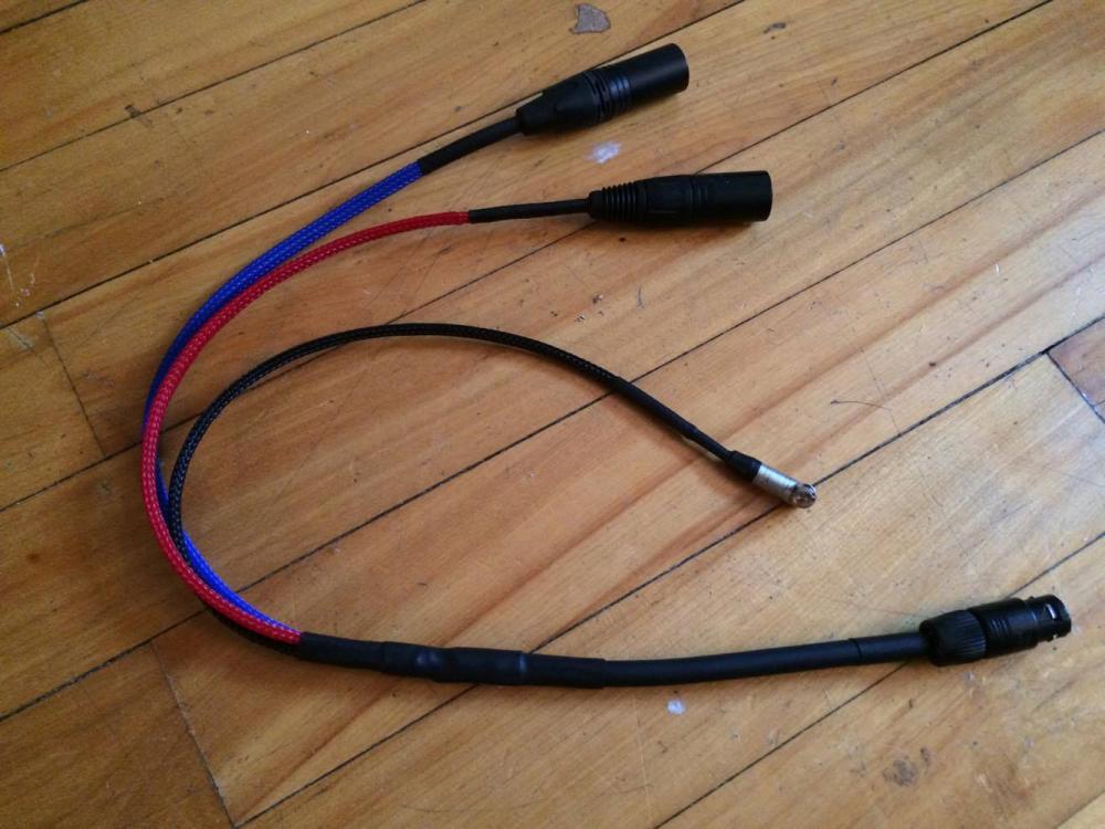

I rolled my own. I also made it compatible with the Remote Audio wiring scheme. Sometimes on multi-camera shoots you have to switch cameras. No need to switch tails. RA seems to be the most popular. They also make several different kinds of breakouts for the various cameras. My most recent is a breakout for a Arri Mini. I also made a couple of extensions and a 7' extension for the dolly.

Have you consider the Remote Audio Multipair cable? It's a 3 channels (3 pairs) cable. It's sold by the foot. The channels are readily made for that purpose, color coded (blue, red and black for the stereo return), you just wrap them with techflex after the fan out and there you go. Used Neutricon 8 pins for the breakout part. Cost me about 100$ for a 23' snake.

My main cam snake suggestion is to have 2 fans, ie one for each end, instead of just one at the camera end.  That way you can quick-release yourself from the snake if you need to move fast.  I found this extremely helpful when working OMB out of a bag esp on crowded sets with a lot of lighting gear.
Share this post
Link to post
Share on other sites
I do the same.
Then you can have different lengths of cables to go between the ends.
Share this post
Link to post
+1 for quick connects on both ends, different length extensions, and a couple fan outs so the snake isn't just tied to the mixer but can be used as a microphone snake too with 3 (or 4) channels.
