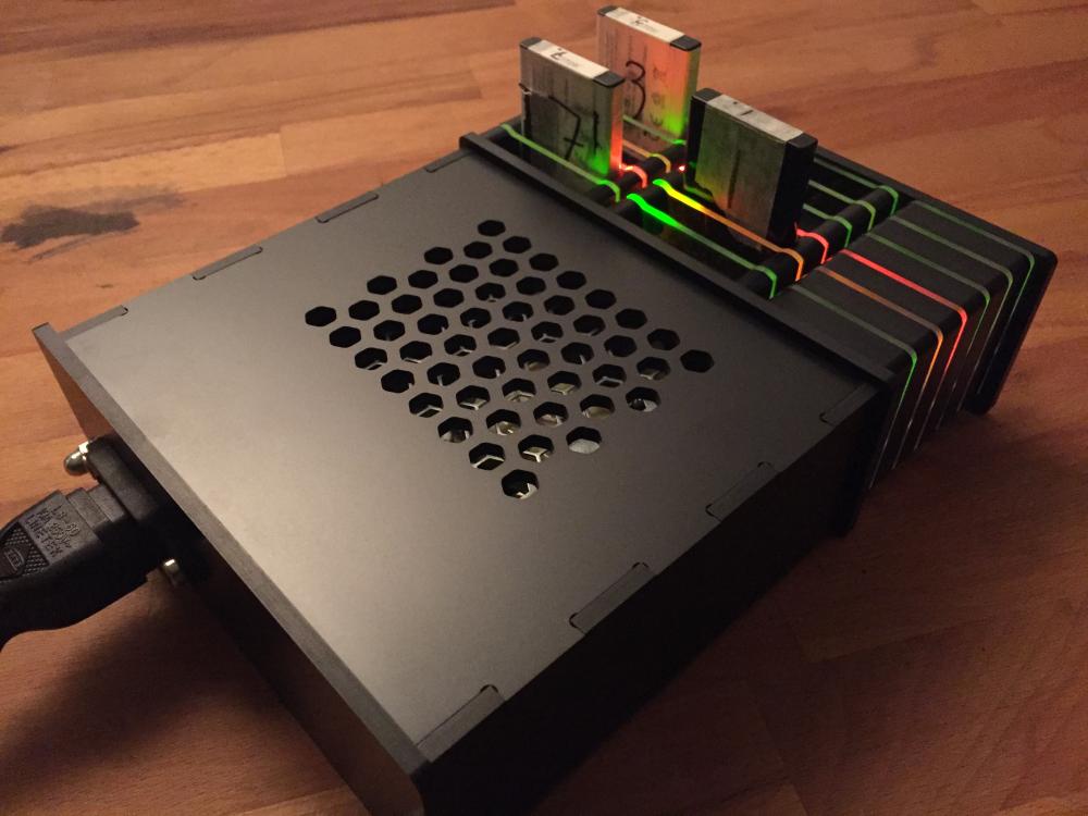

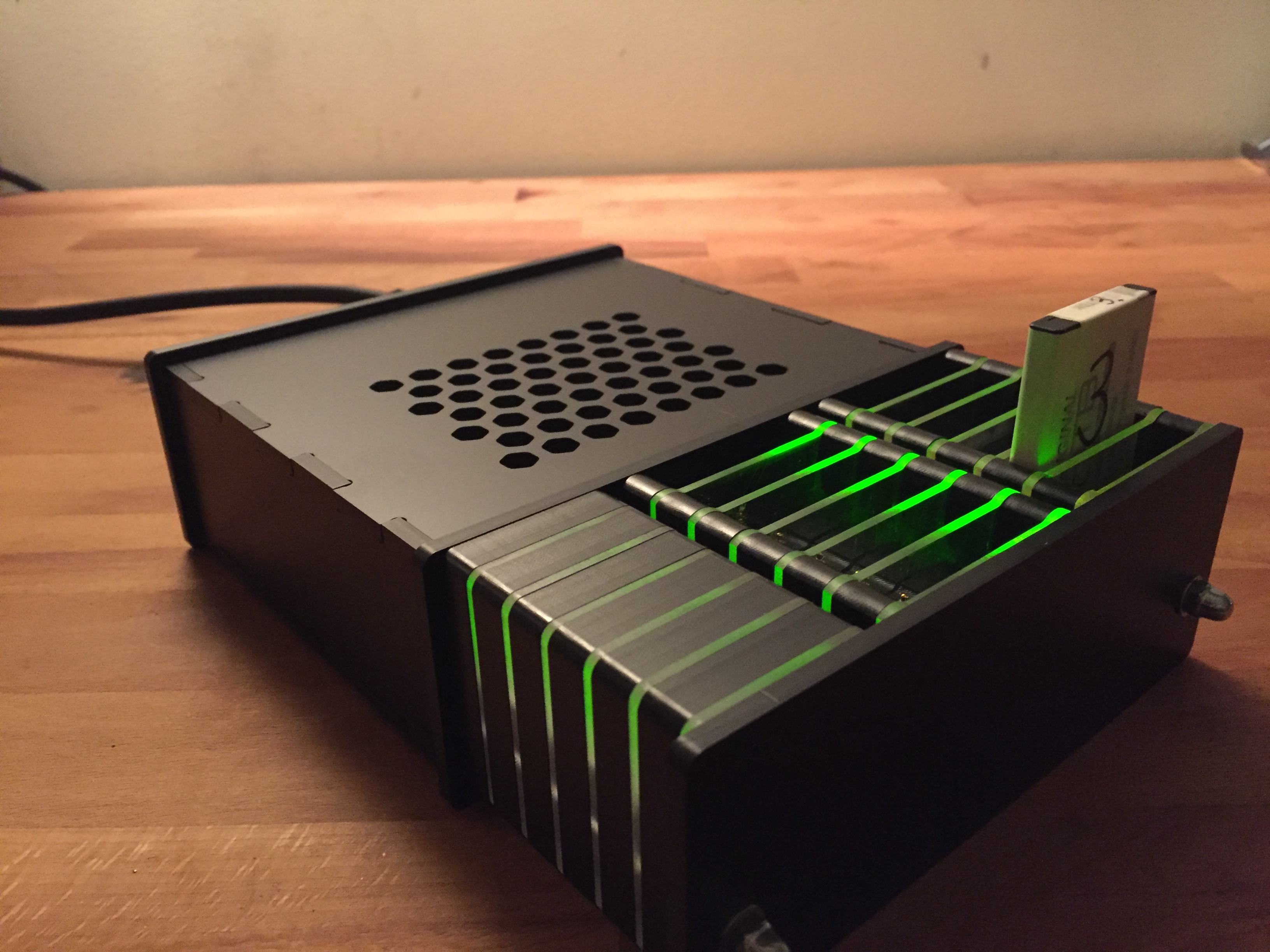

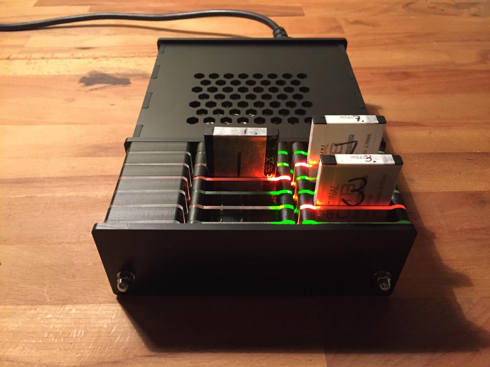

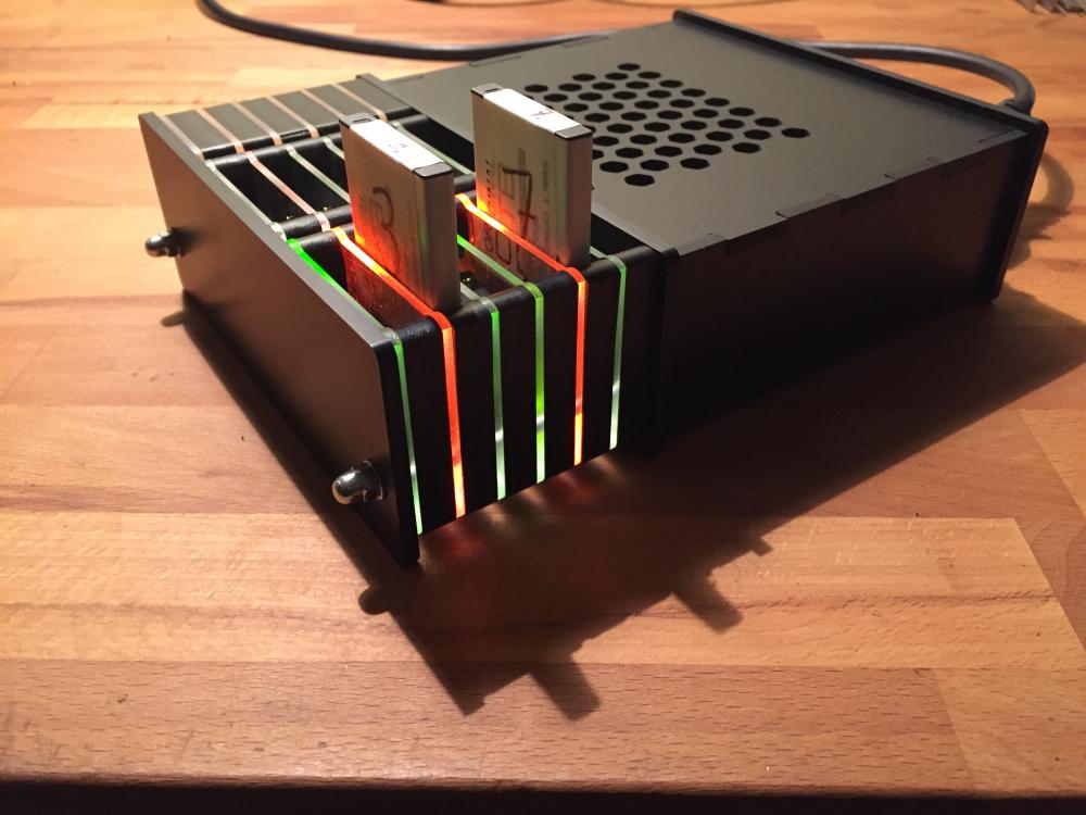

WrineX Posted January 16, 2018 Report Posted January 16, 2018 Hi was wondering if there was anyone interested in a bulk charger for np-50 batteries, i still want it to have some time on the set (in action) before i want to sell any. but an idea about what kind of interest can be expected would be nice. for all i know everyone has something similar already. or no one uses that much of these batteries. or well countless reasons why not. But this is my project little about me and my project how, why and some specs and some pictures. Little about me ? Hi, My name is Joppe and live in the Netherlands, i did mostly audio post production in the past and some audio recording on set (not much). But my interest after a while started to drift away again to making stuff with my hands, mostly audio related gear like exotic loudspeaker designs, but some furniture or weird request every once in a while to. I really enjoy problem solving and creating physical stuff, although sometimes i just wished i never started anyhow, i talked to my friends and ex colleagues (sound recordist) regularly and came aware of the fact that there is not actually a affordable bulk charger for NP50's. They all have either Zaxcom or Lectrosonics transmitters and both use NP-50, and you use a hefty amount a day (depending on how many transmitters of course). So i thought i would give it a go, and of course it all spiraled out of control (as usual) and now there are a gazillion prototypes and parts everywhere (mostly in the bin) and there is no way back so......... i introduce ................ The................... NP50 Charger. What else do i need to call it , im not so good with names.(if you got any please do tell) NP50 Charger The NP-50 charger is a hand made slow (overnight) charger bay that will be available in a 6, 12, 18 slot version. It saves some precious space on the road and works all around the world, it works in all power conditions 230/50Hz or 110/60 Hz. (do let me know which is your prefered voltage) The charger is a Constant Current, Constant Voltage charger and will handle your batteries with care.It can charge all batteries simultaneous at a moderate current limited at ~400mA. All batteries are charged in between 3-4.5 hours depending on capacity of the battery. On request i can add some extra spacers to make it more ergonomical but the intention was small form factor so it is not standard. Any wishes ? Just ask !, Thats the beauty of a small company. Features- Charge 6,12 or 18 NP-50's Simultaneous. - Swiss made gold plated spring loaded battery contacts, that wont scratch up the battery contacts and insures lowest resistance possible. - (rather) Small form factor (HxWxL) 5x14,5x20 cm for a 12 slot, add another ~3 cm for 18 slot version. - Internal Industrial oversized power suply from well known brand. - All passive cooling. No fan noise to keep you awake at night. - Custom amount of slots, i stated 6, 12, 18 but if you would like to have a 14 or 8 slot thats fine with me. Power suply specifications Power 75 Watt Input range: 85~264 Vac Certificering: CE Cooling : Passive Protection : Short cicuit Overload Overvoltage Charger specification for each module (2 slots) Max current each module : 800mA-1000mA Charge rate each slot : ~400mA Charge percentage : ~96-97 % increases life of the battery up to 1.1 times Overheat protection : Charger will cycle down charge current if module reaches above 65 degrees Celsius. Normal working temperature at room temperature 6 slot : Max ~44 degrees Celsius Normal working temperature at room temperature 12 slot : Max ~46 degrees Celsius Normal working temperature at room temperature : Max ~48 degrees Celsius Dimensions 6 slots : (HxWxL) 5x14,5x17 cm Dimensions 12 slots : (HxWxL) 5x14,5x20 cm Dimensions 18 slots : (HxWxL) 5x14,5x23 cm Quote
Constantin Posted January 17, 2018 Report Posted January 17, 2018 Hey Joppe, that definitely looks interesting. How much did you think of asking for the 12-bay version? you may or may not know this, but Lectrosonics build their own 12-bay charger, but it’s really expensive. The problem I have with some unbranded cheapo charger, is that they don’t always realize when a battery has been inserted. Does yours have that problem, too? Some of my NP-50 chargers also have USB outputs, and can take care of my USB charging needs. Could you theoretically add 2-3 USB outlets? Also, a lid would be pretty nice. Ideally a lid per charge bay that stays well in place (like the Lectro Octopack slot covers) The name is boring. Also remember that Lectro sell their own branded batteries, LB50. But I can‘t provide an alternative... Quote
LarryF Posted January 17, 2018 Report Posted January 17, 2018 Hi Joppe, Neat looking unit. I really like the wrap around charge indicators. You can see them from any angle. The modular construction is neat, too. I assume there are dual charge control chips for each module? Best Regards, Larry Fisher Quote

WrineX Posted January 17, 2018 Author Report Posted January 17, 2018 Hi Constantin. Well the price is going to be somewhere in the region of the lectro divided by 2 (i knew it existed, indeed) A exact price i cant give you as of yet since i just delivered my prototype to a sound guy ( literally sitting in the train now on my way home) and since i cant predict the additional cost that might occur.( hope none) Also everything is made and assembled by me so i might need to tweak some production processes. So I don't want to make exact promises, I might not be able to keep. About battery detection, It happens every now and then if a battery is very close to the set value. ( 95-97%) If you used the battery for instance in a transmitter this should not be a problem (depending for how long of course) the 95 percent gives you 1.2 times more charges out of a battery without to much loss and without change of overcharging it , since that has a 1% error. Then again if it won't start charging, battery is at the desired value or really close, something that should not impact capacity in term of far less minutes on your transmitter. Sometimes leaving it will drop the voltage below the threshold and it will fill the remaining mV it was balancing on. So in short . If a np50 is empty or used it will charge. If you used it for 5 minutes or not used at all it it might think it is full. ( actually is minus the threshold) About usb. Well I could if really needed be it that voltages will be slightly lower because I want to have as less heat as possible. Since the np50 will be charged at max 4.18-20 I want as less overshoot as possible. Since it is all so compact I am also restricted by heat dispersion. I can make a fast charge version. But not in this package. The lids? I am not exactly sure what they look like and why use them ? Ill try to look them up when I'm home ! Thanks for the interest ! Quote
WrineX Posted January 17, 2018 Author Report Posted January 17, 2018 3 hours ago, LarryF said: Hi Joppe, Neat looking unit. I really like the wrap around charge indicators. You can see them from any angle. The modular construction is neat, too. I assume there are dual charge control chips for each module? Best Regards, Larry Fisher Thanks Larry , for the complement !! Glad you like it it took quite some nights scratching my head looking at it with a beverage:) Yes they are dual chip chargers 2 mirrored circuits on one pcb. And situated under the middle column . Quote

WrineX Posted January 18, 2018 Author Report Posted January 18, 2018 if people have any question or requests/idea's please let me know. ill try to answer them if i can i thought of adding a few holes with threads in the side panels so you would be able to flush mount it in a battery charge case. do be aware that most heat will emit from the underside of the modules. (the reason why the modules are lifted up above the surface compared to the PSU housing) Quote

Bash Posted March 1, 2018 Report Posted March 1, 2018 Prices seem very reasonable. may I ask what defines the 8mm measurement? Is it the grey plastic bit between the clear lighty uppy bits? Is the 8mm measurement 8mm because that is the way it comes. Could it be possible to have 0.5mm milled off this material? I would suggest that there is no need to make a skirt to make it mount in a case or on a panel. All I would suggest is maybe a screw thread (or two) in the base of the PSU, so that I can screw it to a flat panel. It simply needs an easy way to mount securely onto a surface. I genuinely think you should look into a way of making quite a lot of these - at least a way of being able to pull down batches of the PSUs, and to have a load of battery modules ready to go. Obviously ordering in greater quantities will bring economies of scale, lower prices. Have you thought about when you might try to make a first batch? I'd commit to one straight away. Many thanks, Simon B Quote
WrineX Posted March 1, 2018 Author Report Posted March 1, 2018 Hi bash ! your are exactly right, the plastic that holds the Np50 by the fingers is 8 mm thick milling 0.5mm of is an option but i never trust to much on depth of cut when milling thin floppy plastics i thought about maybe buy a planar, and just put the basic material trough there before i cnc. not a clue if that would work but i guess only one way of finding out is.... i do would love to have it a bit snugger fit although it does not hurt the workings. 7mm is a non existing thickness in any palstic material let alone in this variant. Ooh I have an idea i have a company near me that makes and recondition cutting boards, they have a planar service, and the base material happens to be the same sort of plastic. i am gone call him tomorrow if i can shove some left overs true his planar in exchange for some cash (it is a shabby kind of dude) Well about production, i first wanted to wait for testing to complete, i think 3 months on the road is a decent test after the continues charging and discharging i did while monitoring temp and amp and capacity. but i did not have a mailbox full of people wanting one maybe 3 or 4 of my friends so i did not ramp it up yet. Very nice to hear you are interested in one! i guess i have to make some spare parts then what amount of modules would you be interested in ? ill keep everyone updated on the cutting board dude haha hope he has time tomorrow. Quote
