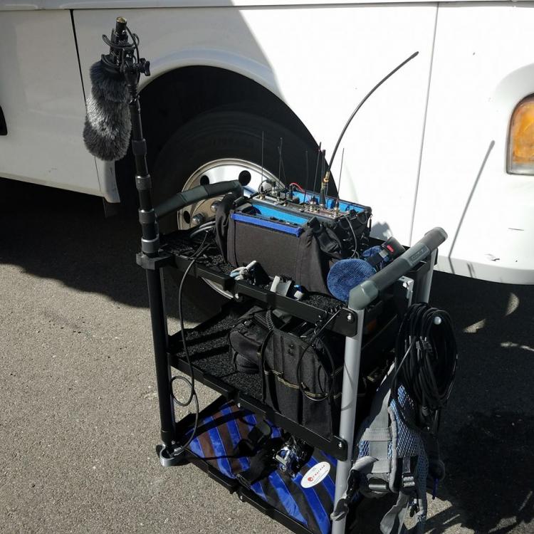

Andrew From Deity Posted March 6, 2018 Report Share Posted March 6, 2018 I wrote an ultra long blog post that includes multiple tutorials on different mods and upgrades you can do to the folding Olympia Tools Service Cart. I’ve done a few of these on my cart and I’ve included some mods that others have also done. https://wavreport.com/2018/03/06/tutorial-uber-diy-olympia-cart-pimping/ Quote Link to comment Share on other sites More sharing options...
Derek H Posted March 6, 2018 Report Share Posted March 6, 2018 This is a cool cheap cart. Any way it could safely haul a C-stand? The small wheels are kind of a big problem. Even 5" wheels are really too small for outdoor use. Quote Link to comment Share on other sites More sharing options...

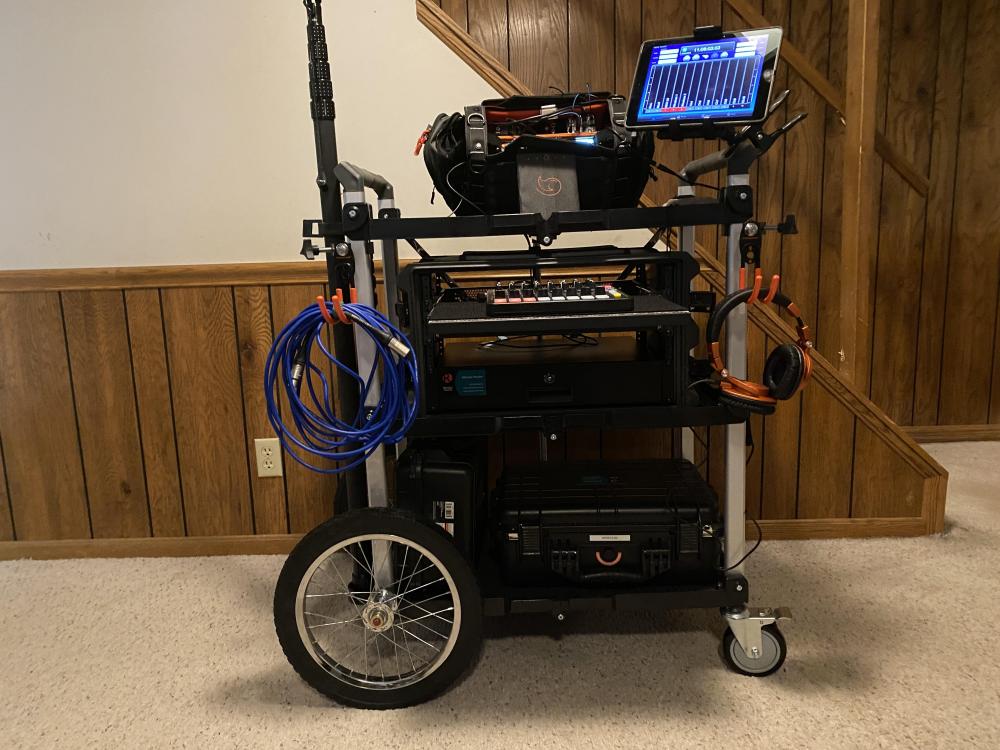

aginzo Posted March 24, 2018 Report Share Posted March 24, 2018 This is a wheel idea that I have been thinking about doing in my Olympia cart. However, it would need to be able to pull out the folding cart part of it in order to still have a way to put in a small vehicle. Quote Link to comment Share on other sites More sharing options...
Andrew From Deity Posted March 26, 2018 Author Report Share Posted March 26, 2018 On 3/23/2018 at 6:33 PM, aginzo said: This is a wheel idea that I have been thinking about doing in my Olympia cart. However, it would need to be able to pull out the folding cart part of it in order to still have a way to put in a small vehicle. I love it. Its like a sled you guys created for the folding cart to drop into. Even though it’s now a 2 piece cart its still rather small to fit into even a 4 door car. What else have you guys done to it? Quote Link to comment Share on other sites More sharing options...
aginzo Posted March 26, 2018 Report Share Posted March 26, 2018 16 hours ago, Drew3296 said: I love it. Its like a sled you guys created for the folding cart to drop into. Even though it’s now a 2 piece cart its still rather small to fit into even a 4 door car. What else have you guys done to it? I can't take credit for this by the way. This is not something I did. I can't remember who these guys are. Quote Link to comment Share on other sites More sharing options...

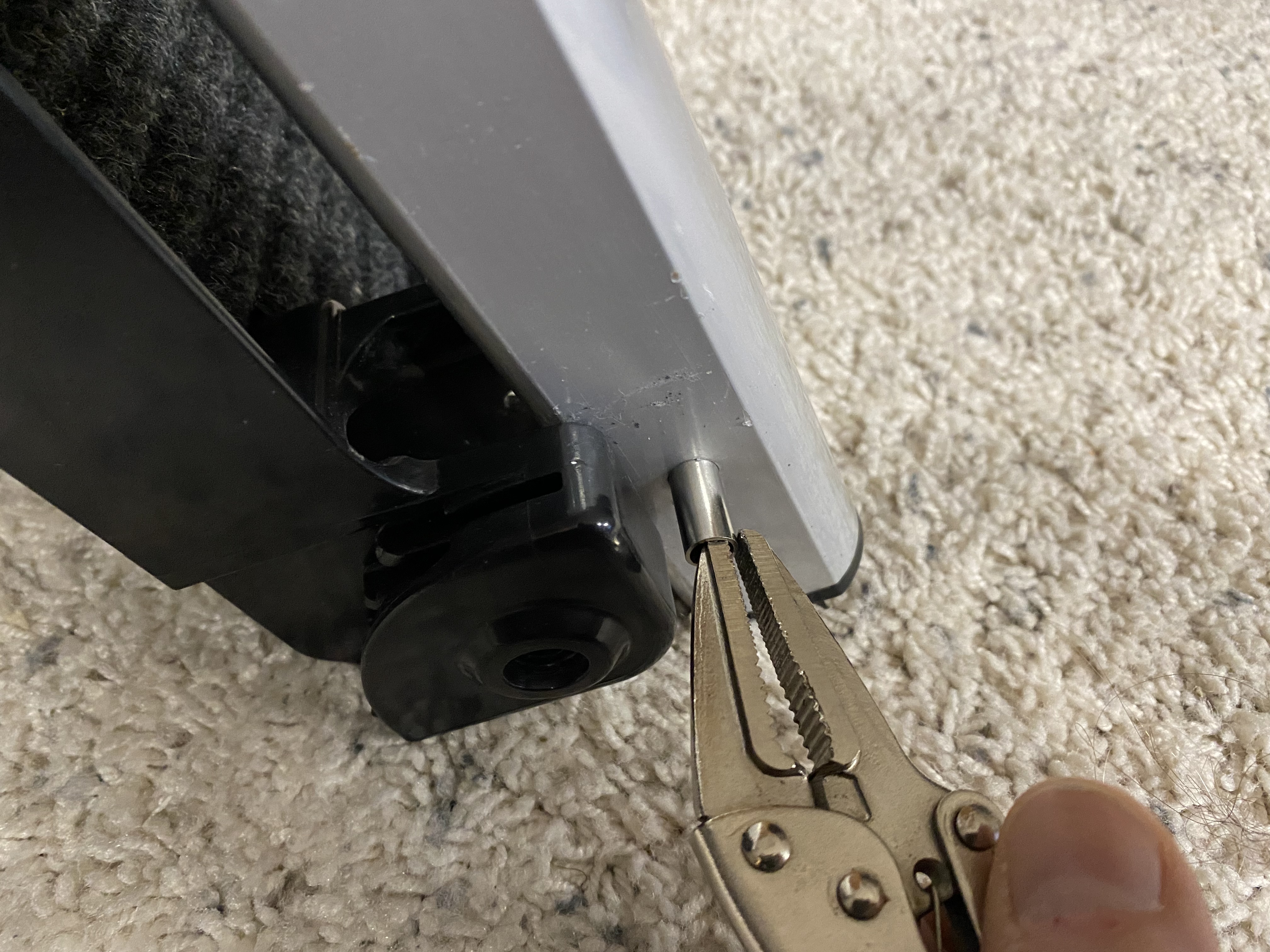

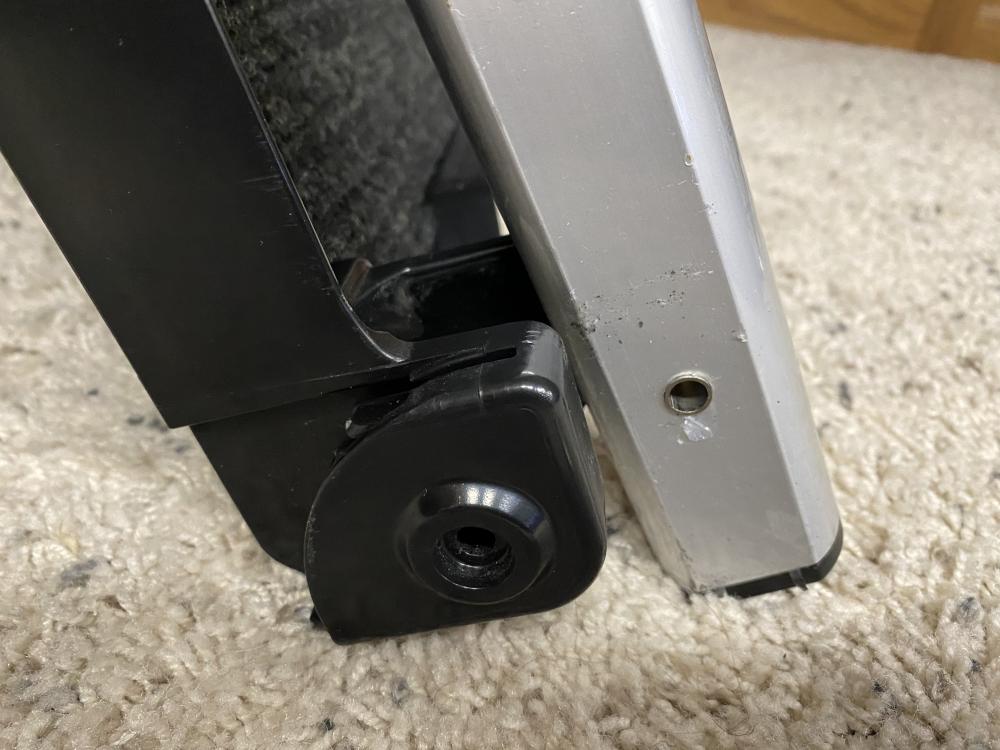

Neil Bliss Posted June 1, 2022 Report Share Posted June 1, 2022 Resurrecting an older thread here - I have one of these carts and I'd like to replace the stock casters. How do you get them off? They look like they ought to just thread off but I can't seem to figure out how to do it. [edit] and of course 30 seconds after posting for help I figured it out. They're held in place by the bolts attached to the shelves. Quote Link to comment Share on other sites More sharing options...
Michael Render Posted June 2, 2022 Report Share Posted June 2, 2022 I recently modded an XL with 5” casters and 16” wheels. It worked out great. Quote Link to comment Share on other sites More sharing options...

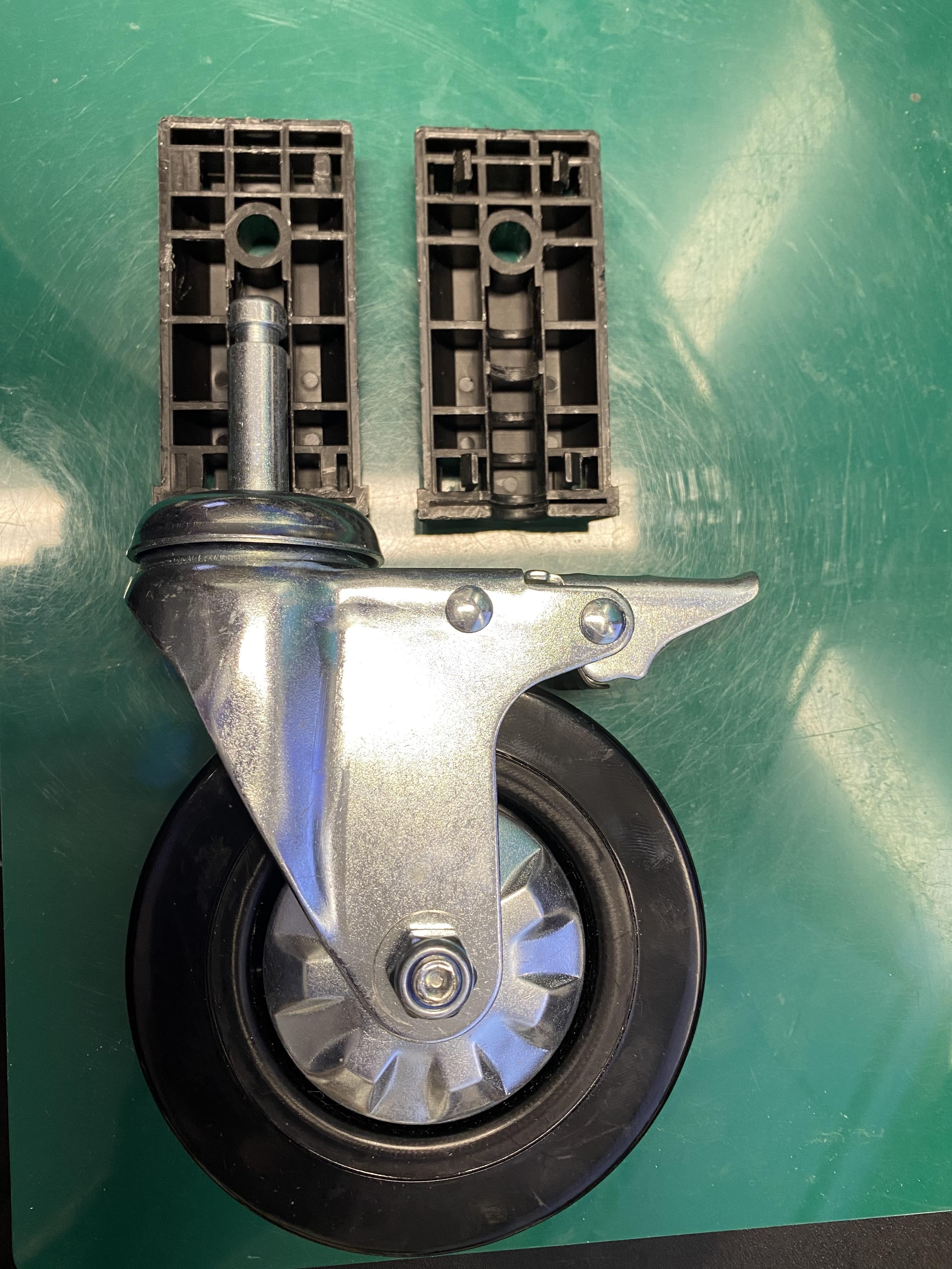

Freq1c Posted November 2, 2022 Report Share Posted November 2, 2022 On 6/1/2022 at 10:46 AM, Neil Bliss said: Resurrecting an older thread here - I have one of these carts and I'd like to replace the stock casters. How do you get them off? They look like they ought to just thread off but I can't seem to figure out how to do it. [edit] and of course 30 seconds after posting for help I figured it out. They're held in place by the bolts attached to the shelves. So how do you take the plastic wheel assembly apart to put it on the new wheels? It seems to be one solid piece. Quote Link to comment Share on other sites More sharing options...
Neil Bliss Posted November 4, 2022 Report Share Posted November 4, 2022 On 11/2/2022 at 11:12 AM, Freq1c said: So how do you take the plastic wheel assembly apart to put it on the new wheels? It seems to be one solid piece. I never did replace the wheels, once I got things apart they were pretty non-serviceable. Quote Link to comment Share on other sites More sharing options...

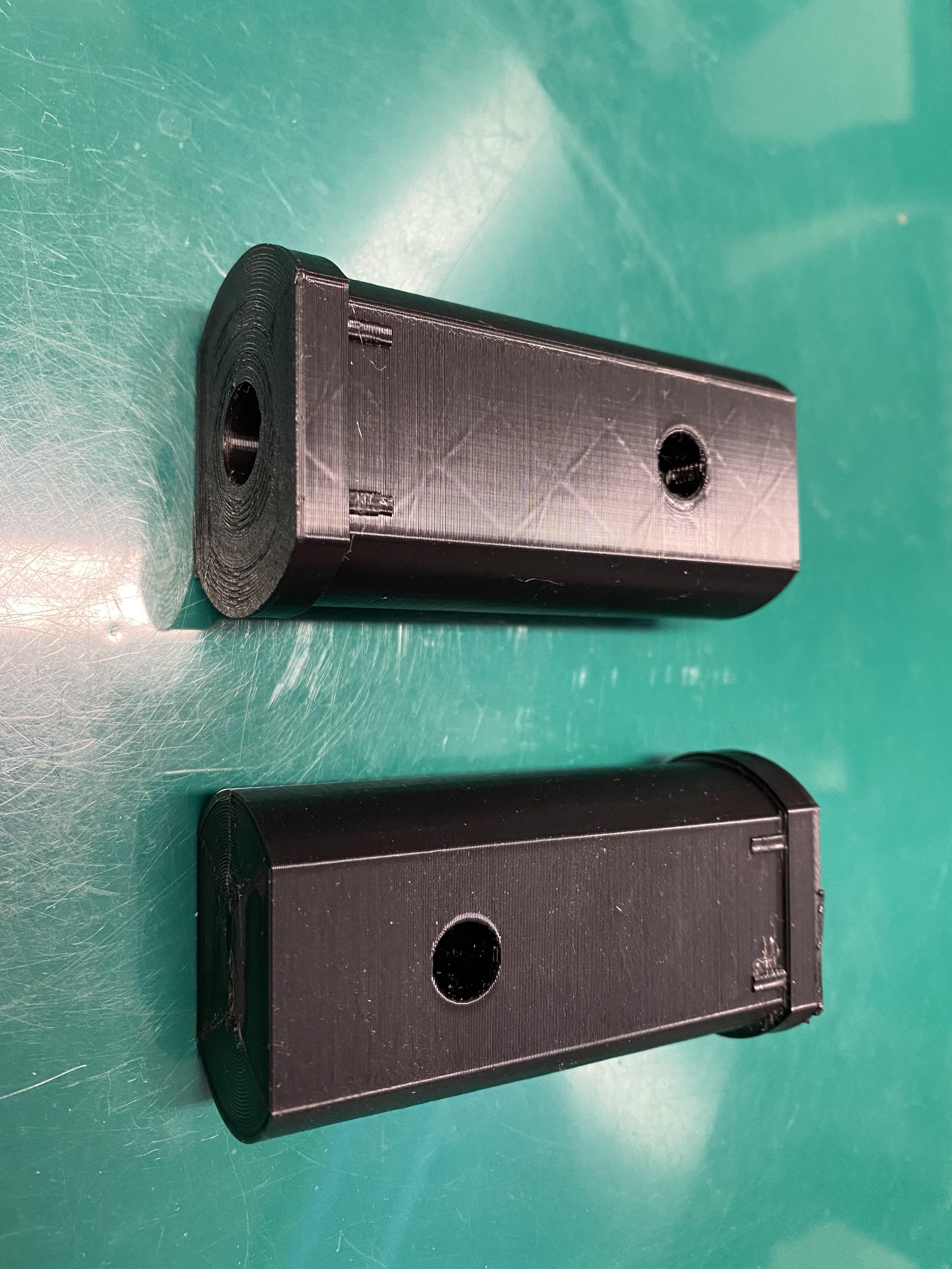

Michael Render Posted November 6, 2022 Report Share Posted November 6, 2022 On an XL cart it is easy to remove the wheel assembly. Once out, they just pry open. Unfortunately, the XL carts use snap ring mounts. The original cart uses M10 stems. i designed and 3D printed M10 assemblies to use threaded casters. I am not a 3D printing expert, but it works great printed on my Ender 3 S1. Others have used my file and the wheels don’t fit tightly. Some have just used epoxy in the existing assembly to keep their new casters tight. Quote Link to comment Share on other sites More sharing options...
Johnny Karlsson Posted November 7, 2022 Report Share Posted November 7, 2022 I bought bigger casters with M10-1.5X25mm stems. Unscrewed the original ones and just screwed in the new ones. Works, but the bigger wheels wobble if I roll the cart slightly faster than slow. Quote Link to comment Share on other sites More sharing options...
