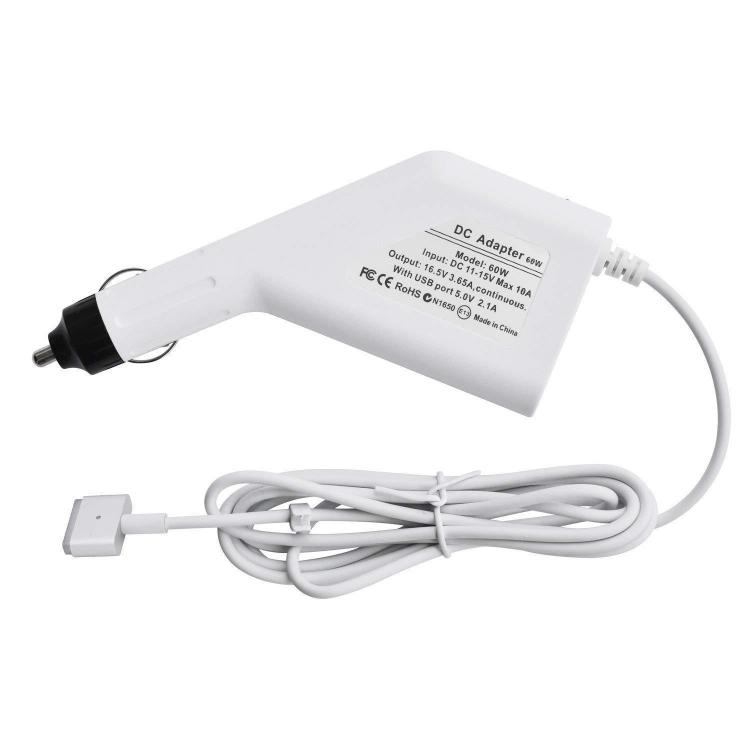

Apple used to make and airline DC to MagSafe adapter.  That would probably be the path of least resistance, but to be safe I might go with a regulated 12v output from your battery rather than feeding the circuits of the adapter an unregulated 14.4v tap.
afaik apple didn't licence magsafe to 3rd parties, so there aren't many solutions...
some companies did cut off the connector from the power supply and connected it to a LiIon power pack (I used one of those when we needed to have extended runtime in project off the power grid). not cheap but light and works well.
alternatively, you could use a common 12V battery with an 12V DC to 120/230V AC converter and just plug in the normal charger, conversion losses shouldn't be too high if you use a good AC converter (also the apple power supply needs a good AC converter, otherwise it refuses to work - Tom's idea with the airplane adapter would probably avoid that problem and be smaller overall)

If I built a hirose or dc locking to cigarette lighter adapter, I should put whatever steps the voltage down to 12v into that custom cable, so that I can connect to any port.  Same goes with my USB charging want/need.
keep any voltage regulator built into the cable versus building it into specific ports on the bds.
I've understood it's relatively easy to tear out the regulator board from a cigarette lighter charger and solder in a different connector. I think I saw a tutorial online somewhere to do this for 5V USB power. You might need to hack up a new enclosure, though. An easy solution could be to use the hole for the tip of the cigarette lighter jack as a cable exit and solder the Hirose/dc-jack on the cable, so you could just plug the assembly into your power distribution with one connection.
