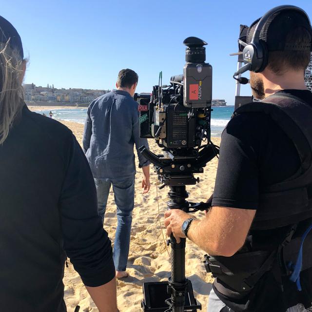

Steve Foy Posted September 27, 2018 Report Posted September 27, 2018 I use a Lectrosonics LR combined with a Tentacle. Small, light weight, reliable and never had a complaint from the Camera Dept. The photo shows this combo side mounted on an Alexa Mini but can be mounted on top just as easily........... Quote
