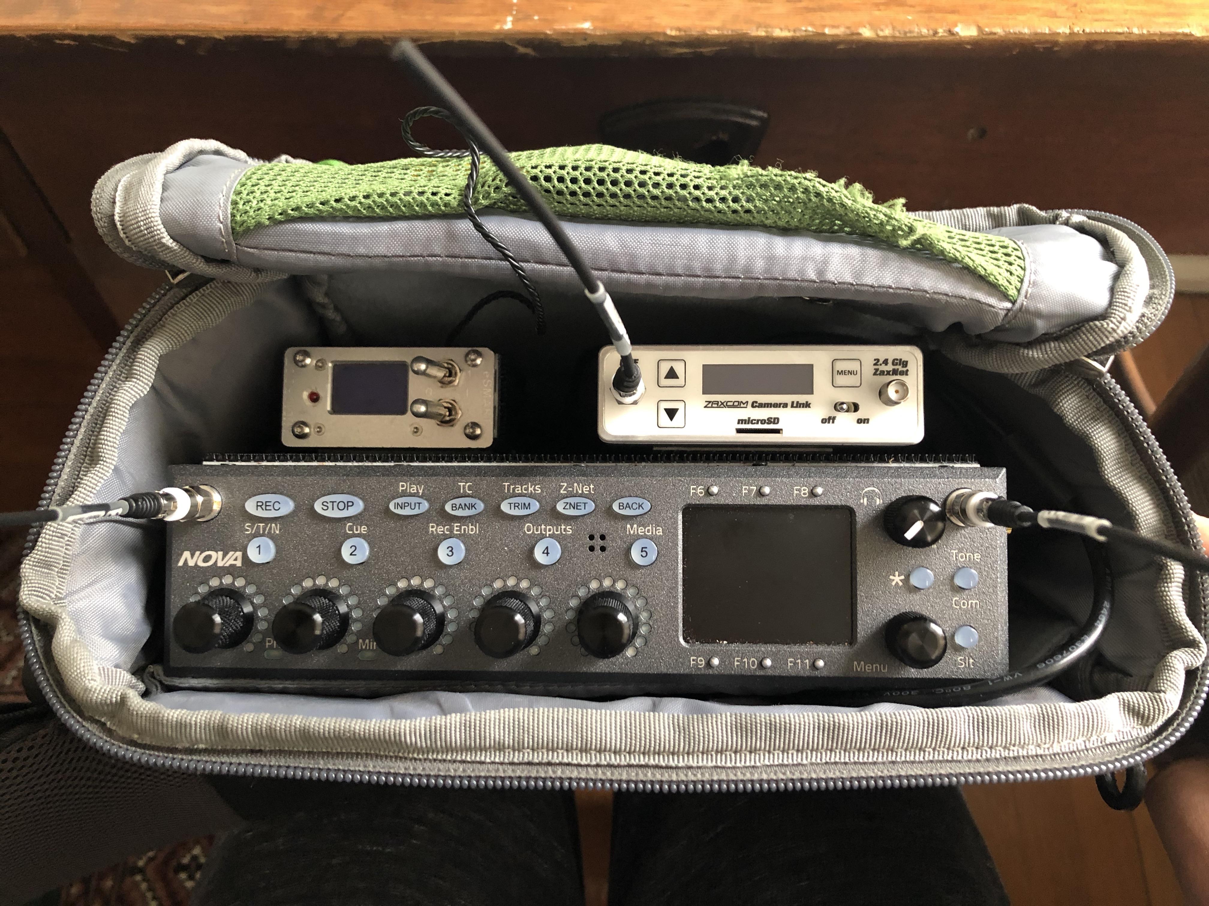

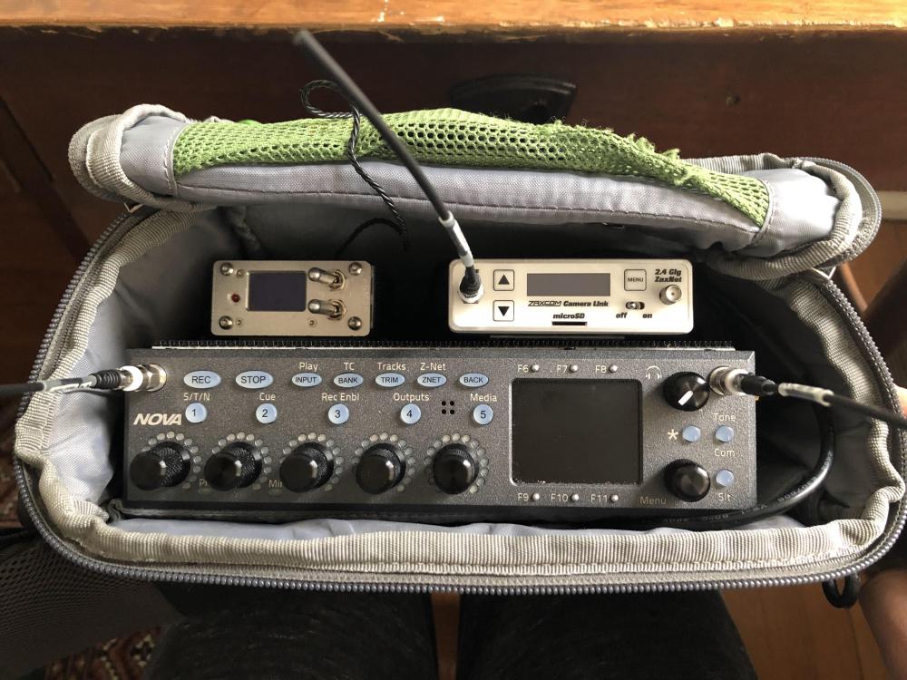

ivanovich Posted January 25, 2020 Report Posted January 25, 2020 Types of jobs you do: Documentaries, Shows, Films, and everything in between. A lot of day playing. Camera audio will be final or reference: Depends. Most of the time its just TC or guide/reference. There are gigs that I do that require broadcast quality hop. Mono/Stereo hop: Both. Most common cameras you work with: Pretty much all of them. TC needs: JB-1s, Zaxcom ERXs, Zaxcom rx200's. Hey guys, so I have a question regarding UHF hops in a compact bag setup. I primarily use a Zax CL3 with RX200's and URX100's. This setup works fantastic in a cart or if I'm working with the K-tek bag/harness combo because I can place the CL3 TX further away from the incoming RXs. My issue is that most of the time I'm running a really compact and lightweight system that doesn't use the traditional 'sound bag' setup. I don't have a lot of room to place the UHF TX far away from my receiver antennas. Right now, I'm using the TX at 608Mhz frequency and most of my incoming RXs in the 530-550 range. I get significantly reduce range when the CL3 in the bag is on. The second I turn the CL3 TX off my incoming RX range increases dramatically. Is there anything I can do to mitigate this overloading of the incoming RXs? I'm hoping that if I can remote the CL3 antenna to somewhere else in the bag will resolve the issue. I'm going to contact the Zaxcom mothership to see how I can get up to the highest legal use (614mhz?) to get more frequency separation. I'm also hoping that using more of a 'tune-able' antenna (SNA600a) could help mitigate RF spray, or a combination of all of these will allow me to use UHF hops with my compact bag. Picture is attached so you can get an idea. What methods are people using to get the best range for both UHF hops and their normal 'talent' wireless? Quote
John Blankenship Posted January 25, 2020 Report Posted January 25, 2020 Unless something has changed that I'm not aware of, 608-614mHz (TV Channel 37) is illegal for our use in the U.S. 608-614mHz -- This band is used in the Wireless Medical Telemetry Service (WMTS) and the Radioastronomy Service. This band is allocated for both Federal and Non-Federal use. As far as your desensitizing issue, have you tested putting the antenna on a remote cable to see if that would solve the issue? If you determine it does, then you can start experimenting with placement. Getting it on a plane away from the receiving antennas would be where I would start -- below their plane or above it. I wonder if adding one of the Zaxcom filtered antennas might help -- a question for the mothership. Quote
ivanovich Posted January 25, 2020 Report Posted January 25, 2020 Thanks for the ideas John. I just did a quick test of remoting the SNA600a to the side of the bag and it did seem to help a lot. I'd like to minimize the spray even more but running the CL3 at 608 and shortening the SNA600s so the antenna is more in tune to the 650 marking really did make a difference. Would adding an inline filter (between TX and SNA600) help keep the RF spray within the specific TX frequency? I just looked up the frequency question and it seems you're definitely right but there's a couple of spots in the 600mhz range that we might be able to use. Available frequencies following the transition Many frequencies in the TV bands that had been available for wireless microphone use prior to the auction will continue to be available after the transition period. These include: -VHF and UHF frequencies on TV channels 2-36, which fall below 608 MHz. -Certain frequencies in the 600 MHz guard band: 614-616 MHz. -Certain frequencies in the 600 MHz duplex gap: 653-657 MHz for licensed use or 657-663 MHz for unlicensed use. Jon, didn't mean to hi-jack the thread, I was just thinking it's semi-related to the above! Quote
osa Posted January 25, 2020 Report Posted January 25, 2020 If i am not mistaken, doesnt the antenna filter duplicate what is currently built into the CL unit? Maybe its block specific and more narrow? i have had success reducing interference significantly (but not eliminating entirely) using whip antennas by putting spacers between the CL and nova about an inch or so. Also allows airflow the CL gets hot reducing output to 50 or 25 didnt seem to change much in scans so i am leaving at 100 most of the time -Ken Quote

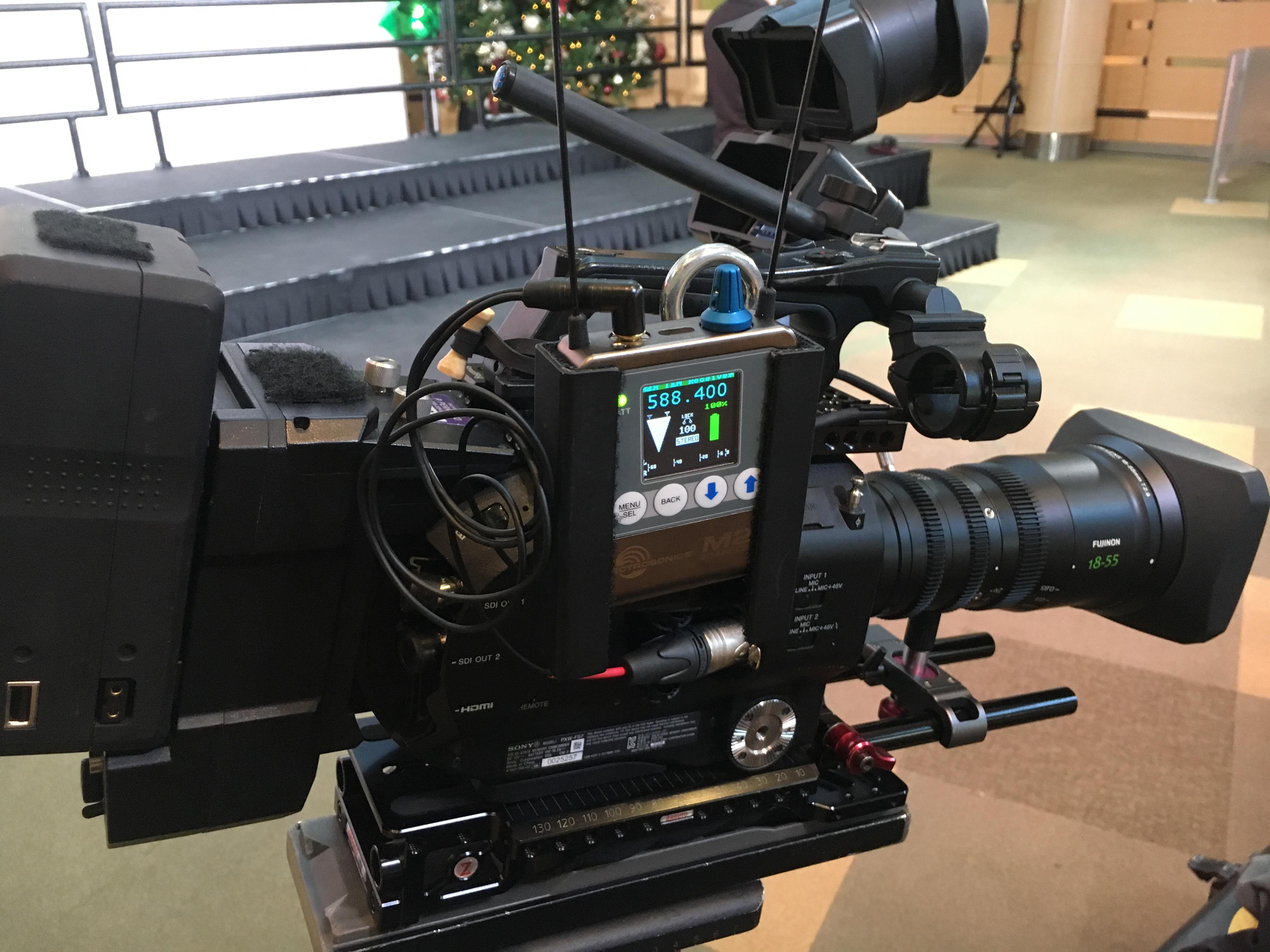

jwill Posted January 25, 2020 Report Posted January 25, 2020 I went to Lectro M2R and DCHT, small, broadcast quality audio, run on lithium AAs' all day...the pros, the cons cannot be hit with phantom power, and a non locking mini jack! I haven't had any issues with the mini jack but I did have the unit get fried by phantom power! You've got to get phantom blocker cables! My 2cents Quote
JonG Posted January 26, 2020 Author Report Posted January 26, 2020 @jwill since I started this thread, the DCHT was released, and it really ticks a lot of boxes for me. I’d like to eventually migrate over to that system, just waiting on a few things right now. I got a chance to beta test your setup and it is really something. Question to you tho: what do you think of the levels from the M2R? I kind of felt like it was a bit low. I think about cameras like the Alexa that are line level only. I’ve never been able to get -20dB tone on an Alexa, always about -26/-28 from other hop systems I’ve tried, which isn’t the end of the world but annoying that it’s low. I like to think of myself as being very thorough, and getting low levels on cameras hurts my pride! Quote
jwill Posted January 26, 2020 Report Posted January 26, 2020 I Jon I am over that issue! I figure if I am going wireless to camera, I am doing a back up record any how. I have run the M2R to 100% and achieved -20 db to an fs7. Quote
