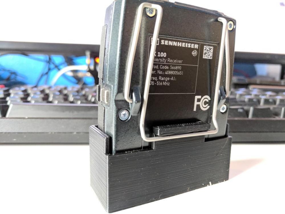

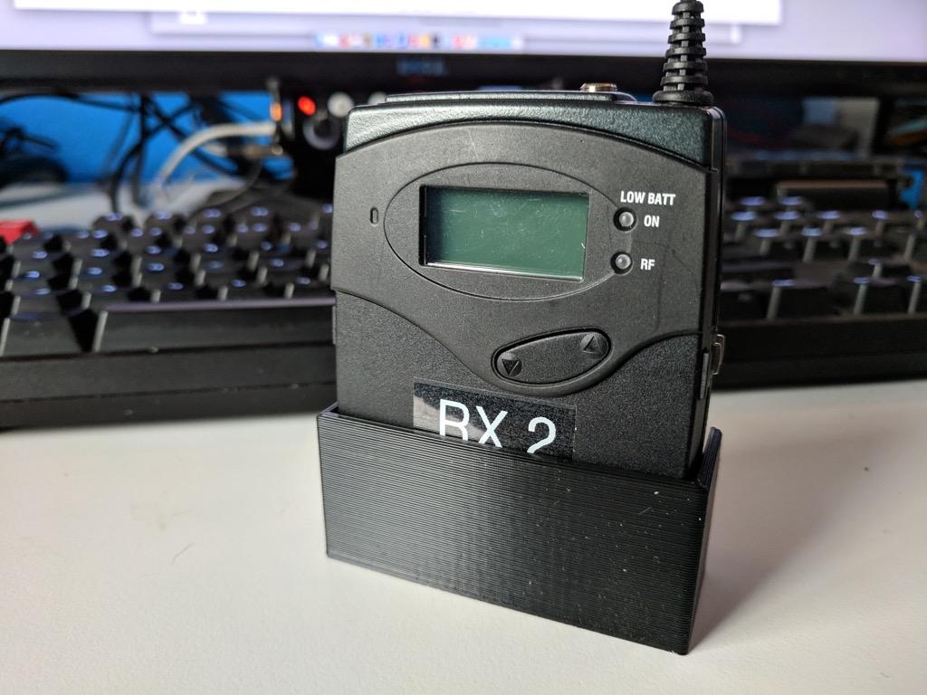

Allen Rowand Posted November 2, 2018 Report Posted November 2, 2018 Decided to move my G3s to the outside of my bag, so I designed some protectors for the bottom. Not going to do much in a catastrophe but at least I feel a bit safer setting the bag down. Quote

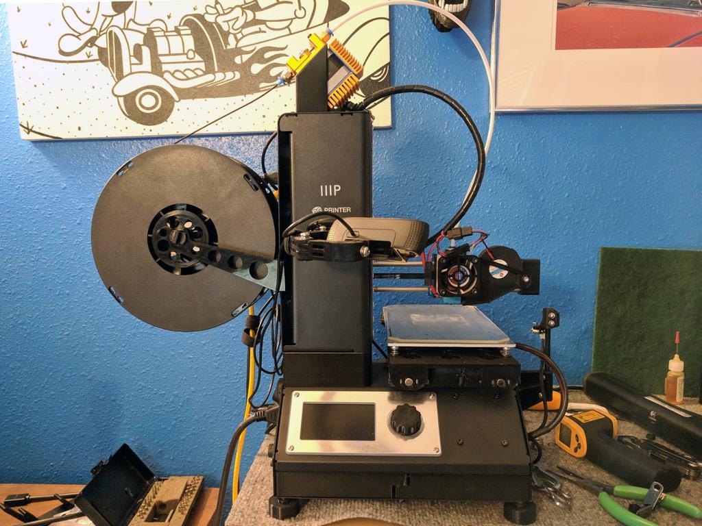

drpro Posted November 12, 2018 Report Posted November 12, 2018 Allen I just got the MP IIIP mini printer. Learning and having fun. Would you be willing to share your printer mods? Thanks David Quote
Philip Perkins Posted November 12, 2018 Report Posted November 12, 2018 The little ridge to catch the G3 clip is a nice touch. Here are two pieces that I'm sure at least started out as 3D printing projects (bought from Wilkinson Sound). On the left is a virtually weightless ORTF stereo bar for SDCs, and on the right a solution to the perennial Senn. MD421 mic clip issue (their part is the little tube + flat piece that is bolted into the mic body). Quote
Allen Rowand Posted November 13, 2018 Report Posted November 13, 2018 10 hours ago, drpro said: Allen I just got the MP IIIP mini printer. Learning and having fun. Would you be willing to share your printer mods? Thanks David It might be easier to list what hasn't been modded: Filament spool holder Relocated extruder motor, added heatsinks Installed metal extruder Lifted Z tower 25mm Installed Z stepper motor with integrated shaft Installed E3dv6 Lite hotend with dual cooling fans Built custom heated printbed with glass print surface; print volume is now 125x240x160mm, stock is 120mm cube Relocated Z limit switch to adjustable post Rerouted heated bed wiring out of the side of the case Lifted top of printer base 20mm Added internal PSU for heated bed; stock PSU runs controller, motors and hotend Raspberry Pi 3 running Octoprint mounted to the back for control Webcam for remote print monitoring Strip of multicolor LEDs on side of Z tower controlled by Octoprint for increased visibility and print status A great place to start is https://www.mpselectmini.com/start, most of the mods I did are found at https://www.mpselectmini.com/thingiverse/start. Quote
drpro Posted November 13, 2018 Report Posted November 13, 2018 Good grief Allen, that is awesome. I have been spending hours learning about 3D printing and printing quite a few mistakes!! Learning to use the software is my weak spot. I have been using Tinkercad and slicing with Cura. Any other suggestions from you? I am already lusting after a larger printer. Thanks David Quote
