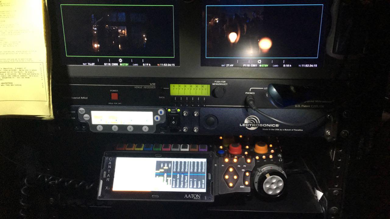

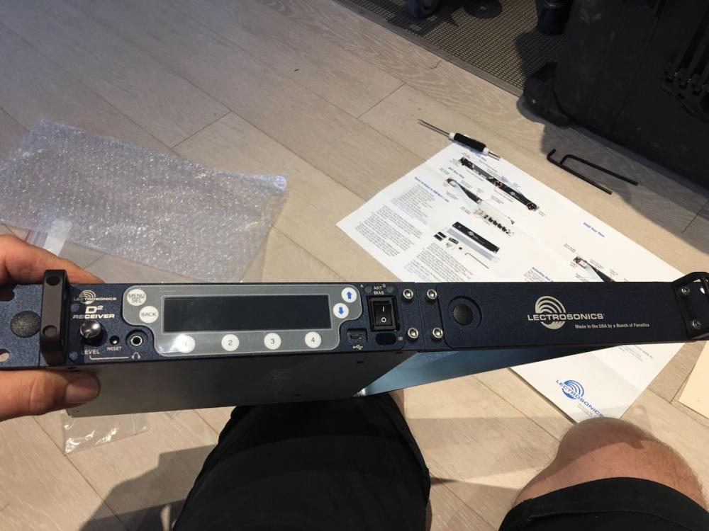

Hey guys,
Spent the last 3 days with the DSQD in the half rack configuration, 50 feet of cable to 2 Lectrosonics ALP 620's.  Very pleased for the most part, but yesterday was noticing a few things.  Could have been the Ronin head, but it seamed I was getting more quick "snap" type of hits on the Booms which are Hm and HMa.  The display for the RF showed no considerable loss in rf signal to indicate I should be potentially getting a hit.  This happened to also the day before with a Ronin head.  Day before that I had nothing to complain about, but the Ronin Head was not used.  Range was on par with WB Mid Venue, if not better at times with 50 feet of cable attached to the inputs and looping into venue.  I used the SMQD in a standalone configuration using two wireless booms, and two SMv's, set to 100mw.  One is on the 75khz deviation, and the newer set to 50khz deviation.
Display could be brighter outdoors as I'm used to the Cantar X-3's very bright and Useable screen.  The battery voltage readout could be more accurate.  For example, the display on Venue would read 1.45 for the AA ALK setting where the SMQD reads 1.4.  In critical times I like the most information I can get from Battery readouts.  It also reads the voltage lower than what the venue presents.
Audio quality is the same as a Venue.  I have not used the Dante in the real world but I have it connected and have tested it at home.  Just waiting for the new X3's update to give it Digital gain, and Digital limiters on all Digital inputs including the Dante.  I'm excited about the prospect of using Dante.  Setup was a breeze and went smoothly between Cantar and DSQD.  I will be spending the next week using it on some major TV productions, including the Boys, Stark Trek, and a new series called Mrs America.  All very demanding productions.
I hope that the "Snap" types of hits I was getting was a situational fluke, and that It can be something very reliable and robust in the field.  The venue I currently own has been excellent long term, so I hope Lectrosonics is listening to this short and preliminary review.  The hits I experienced, I have also experienced with My current Venue, so for now the revue is extremely positive.  We also know that there is more and more lower cost wireless gear being developed for camera department, and that the set has become a RF congestion at times. Lighting has become wireless now, so this further stresses our gear.  This has placed larger demands on the equipment for better range, more robust RF transmission and better reception.
I'll chime in after this week, with more time with the DSQD.
