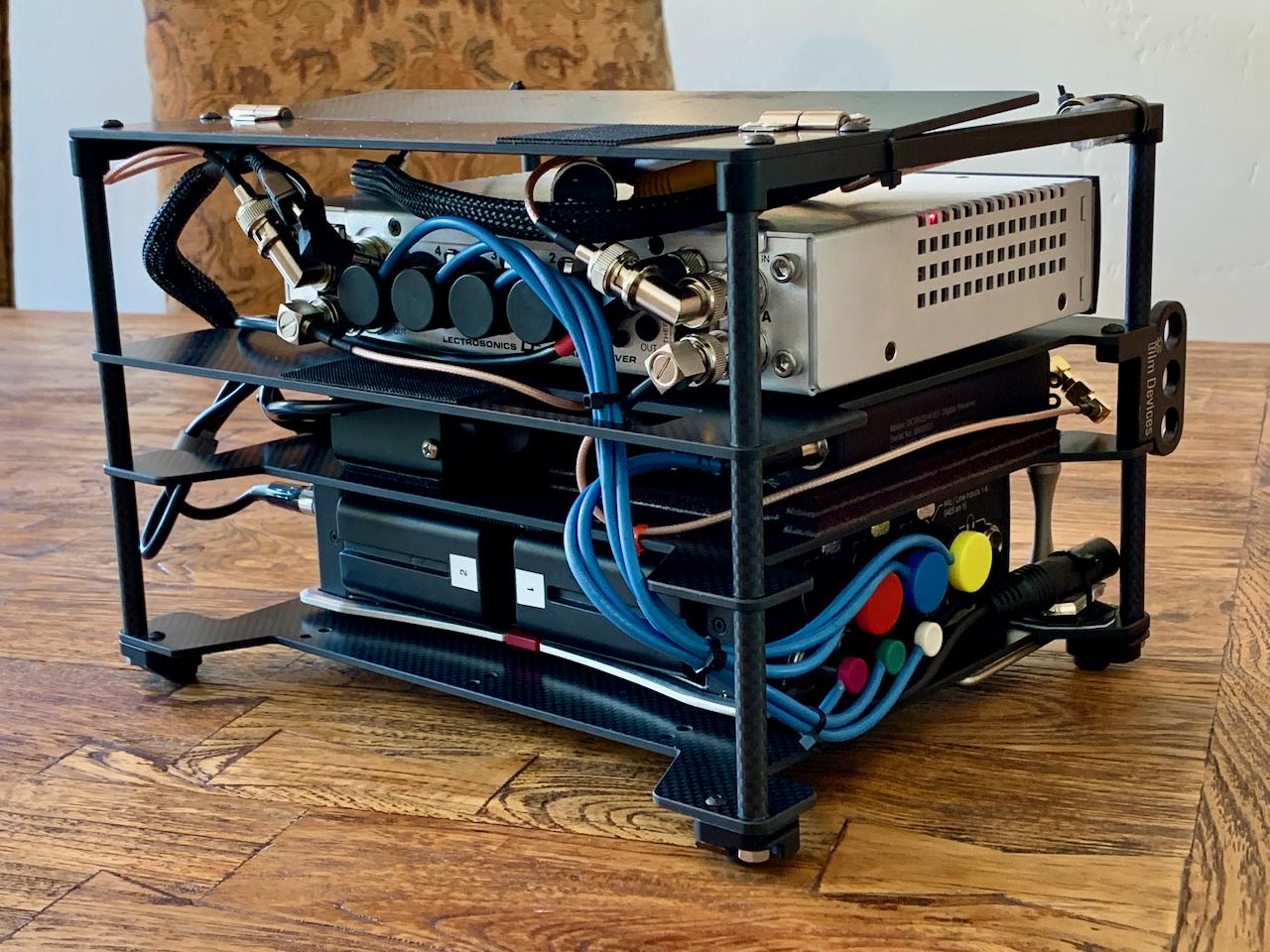

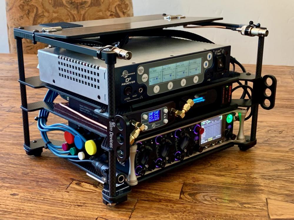

audiofp Posted February 17 Report Share Posted February 17 One downside is it's not built for the rigors of a bag so I put my DSQD and 822 in a Rack-N-Bag ... Quote Link to comment Share on other sites More sharing options...
Mark Posted February 18 Report Share Posted February 18 That’s a great rack n bag rig. Nice one. can you post a couple more photos please? I just ordered mine today. How are you finding it? Quote Link to comment Share on other sites More sharing options...
Jobo Posted February 18 Report Share Posted February 18 Love that mini-stack design. Very slick. Would love to see the cable runs on the backside! Quote Link to comment Share on other sites More sharing options...
audiofp Posted February 28 Report Share Posted February 28 A little pricey but I've enjoyed the access, even in the field. Removing the outer bag is quick. Quote Link to comment Share on other sites More sharing options...
codyman Posted February 28 Report Share Posted February 28 12 minutes ago, audiofp said: A little pricey but I've enjoyed the access, even in the field. Removing the outer bag is quick. Does make it very clean and organized. My bag's cable management certainly does not look like that! Quote Link to comment Share on other sites More sharing options...
