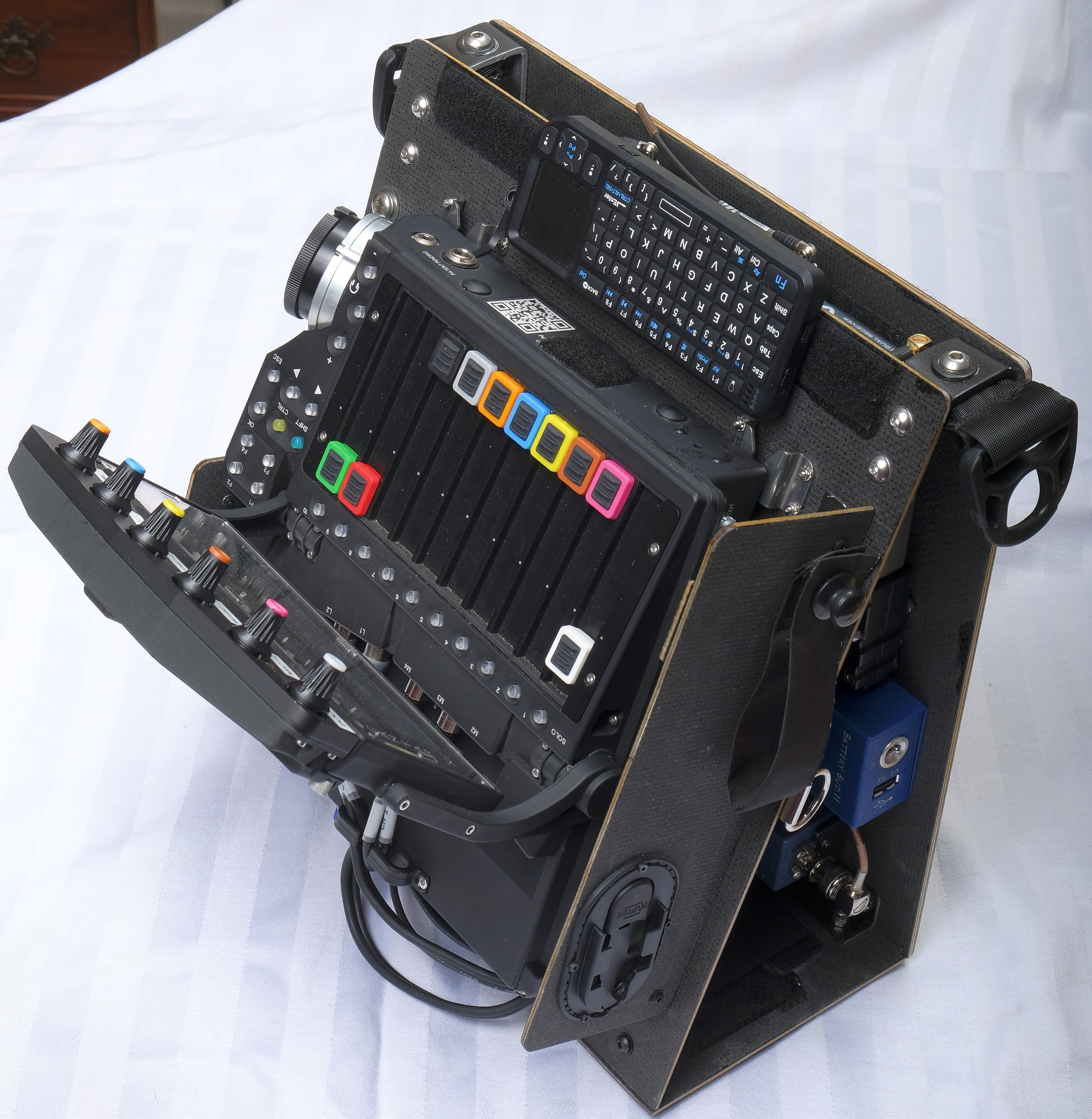

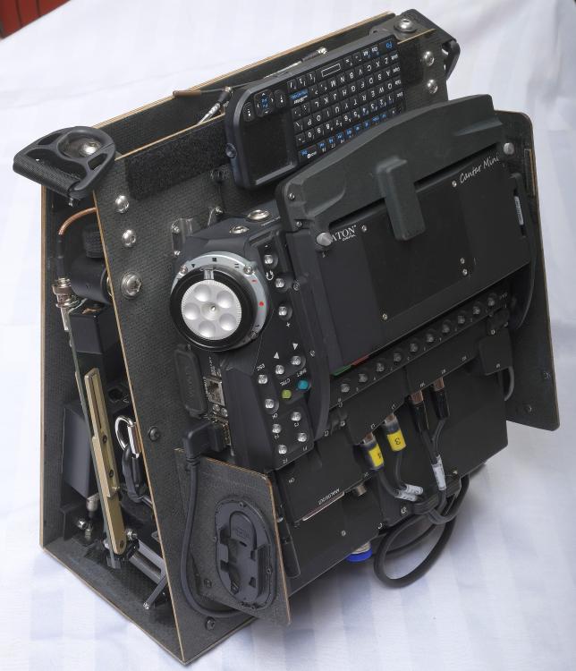

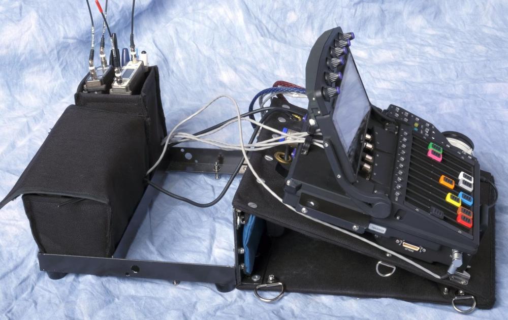

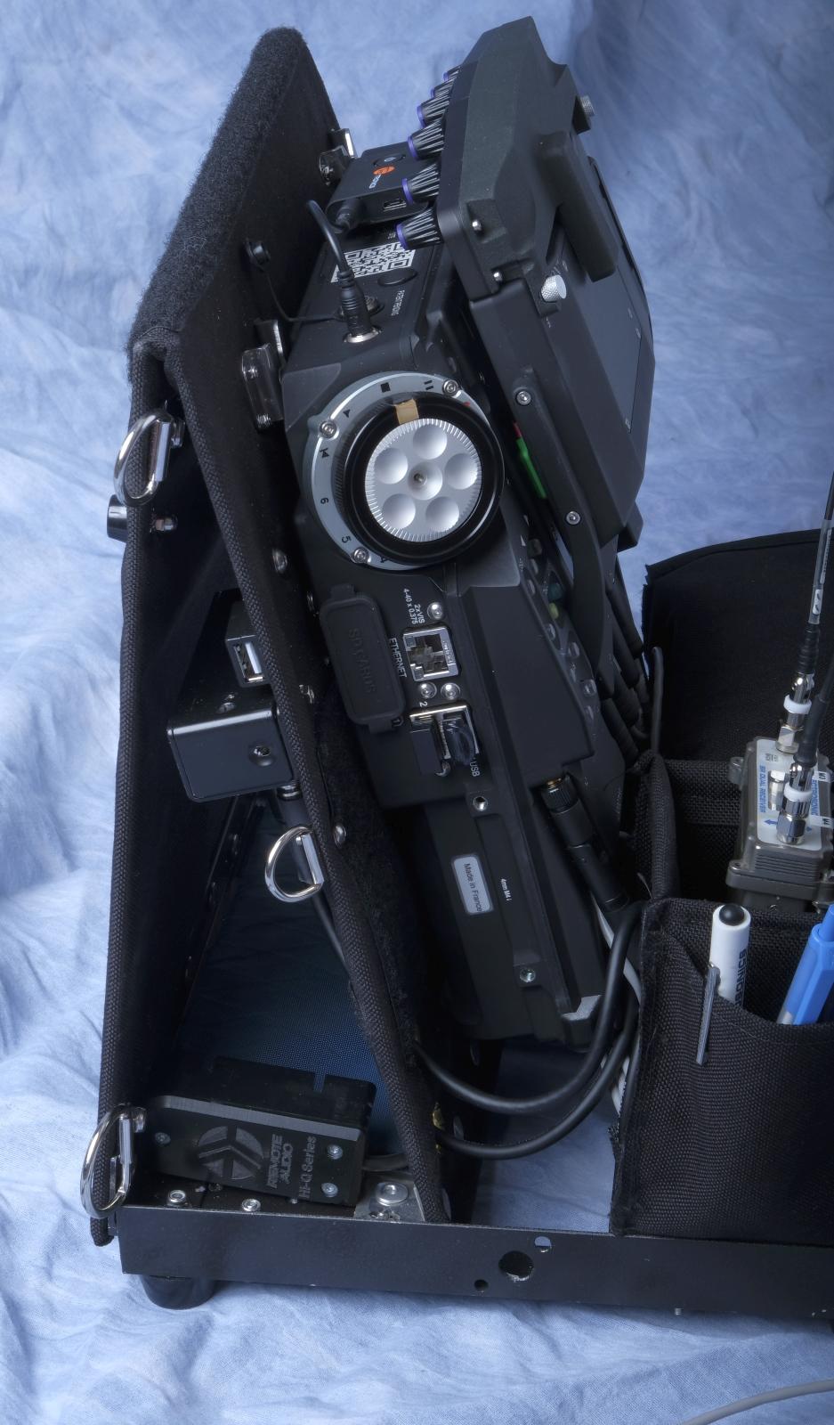

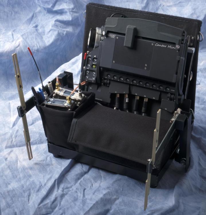

drpro Posted October 1, 2019 Report Share Posted October 1, 2019 For the past few months I have been using my Cantar Mini. I work bag and bag cart, so in my search for a Cantar Mini bag I found only three sources and none of them really did what I needed done in a bag. So I built two versions, the second is shown below in the photos. The first version shall never be seen in public. All of the metal work and sewing I did, so please don't judge me!! The Mini is not like any other recorder/mixer shape. So my design incorporates a frame much like the Aaton cheese plate offering. I wanted something fairly compact and have some features that I don't believe any other bag has. By making it triangular I have created a space that now houses a permanent battery distribution system, battery cup for an Inspired Energy type battery, a USB power outlet and two attachment points for mounting two Lectrosonic dipole antennas. For me battery and antennas on other bags are an afterthought. The total weight of the bag with no battery, is 2kg and that includes the BDS, USB power and the battery cup. So it's weight is on par with other bags. Dimensions are 30.5 x 28 x 23cm. Since this design has the Mini in a vertical position, a flat surface means you would need to operate from a standing position. On a bag type cart this is not a problem. So for the times when you can sit at a table I added the folding design to allow you to operate and see the screen. I have small rubber feet on the metal surfaces to protect whatever table you set up on. The sloped surface makes it a bit easier for me to operate as I don't have all of the button positions memorized. I am already thinking of changes in the third version. Also shown is my minimalist take. Two wireless channels and a boom. Quote Link to comment Share on other sites More sharing options...
David Waelder Posted October 1, 2019 Report Share Posted October 1, 2019 Very nice work and an imaginative response to the challenge. David Quote Link to comment Share on other sites More sharing options...
daniel Posted October 1, 2019 Report Share Posted October 1, 2019 +1 I like the fold out. Quote Link to comment Share on other sites More sharing options...
drpro Posted October 1, 2019 Author Report Share Posted October 1, 2019 Thanks David. Not having a mainstream recorder is a bit of a hassle, not a lot of third party support, mainly in bags. It has been fun, lots of measuring, extra holes where I missed measured and so on. Regards, David Quote Link to comment Share on other sites More sharing options...

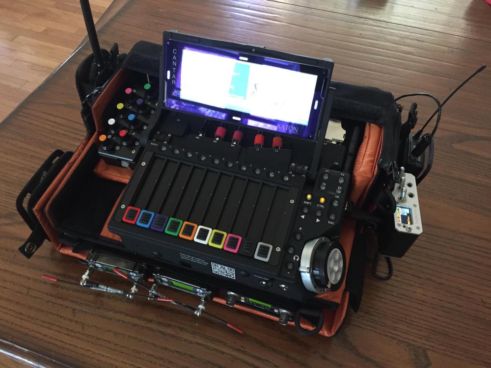

ryanpeds Posted October 1, 2019 Report Share Posted October 1, 2019 I had Protogear make me a custom bag. The only downside was it was quite expensive. I’ve now added the PSC 6 pack where he wireless are so it’s much cleaner. Quote Link to comment Share on other sites More sharing options...
drpro Posted October 1, 2019 Author Report Share Posted October 1, 2019 Nice Ryan, I did see those bags. What are your thoughts on the construction and support. I am guessing there is some sort of internal framework. Is there some internal storage for transmitters and other small bits. Lastly I see you are using five wireless and boom. Oops added PSC 6-pack. Are you using any AES devices. I am thinking about adding another SR with the AES outputs to bring wireless count up to 6 channels and still have two free mic channels for boom and ?? if needed. Quote Link to comment Share on other sites More sharing options...
ryanpeds Posted October 16, 2019 Report Share Posted October 16, 2019 The bags are very well made. The internal structure is similar to that of a porta brace bag. It doesn’t have a metal structure but the way the bag is designed it stays put rather well. I didn’t add a lot of internal storage. You can stash a battery underneath the PSC 6 pack. There are external pouches that can be moved around to 3 different positions that house my boom feed and Comtek. I have gotten rid of the power distro and the 6 pack now feeds directly off of the Cantar. So I don’t need external batteries anymore, I just use the 2 internal. I use the 4 pin XLR when on the cart which is the intended use anyway. I have an analog to AES converter on the cart for the AES inputs. I plan on adding a Sony DWR-S03D when they come out later this year and that will feed the AES inputs directly. Currently when in the bag it’s just 6 analog inputs fed from the PSC 6 pack. I’ll probably add another PSC 6 pack with the Sony receivers feeding the AES in the future. Quote Link to comment Share on other sites More sharing options...

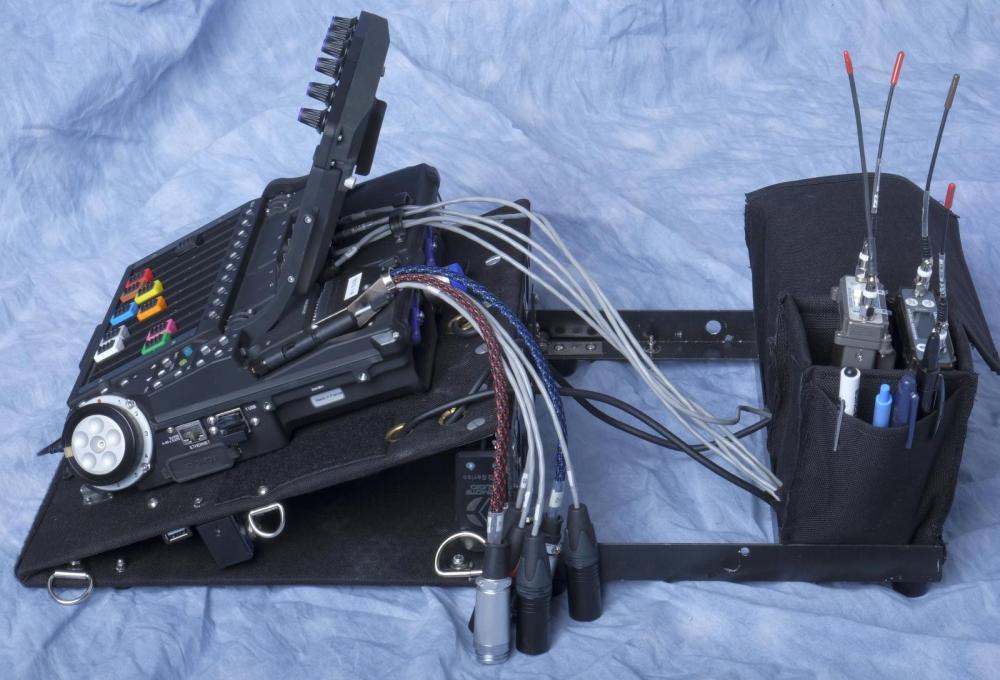

IronFilm Posted October 30, 2019 Report Share Posted October 30, 2019 On 10/2/2019 at 8:01 AM, drpro said: The total weight of the bag with no battery, is 2kg and that includes the BDS, USB power and the battery cup. So it's weight is on par with other bags. Dimensions are 30.5 x 28 x 23cm. 2kg? Just for the bag? Can't wait to see Rado's reaction if he ever reads this thread 😉 Oh to be a fly on the wall. But seriously now, I do love seeing these custom Cantar bags! Fascinating design choices for an oddly shaped recorder. However I hope you're not ever wearing them on your back all day long on a regular basis?? :-o On 10/16/2019 at 3:37 PM, ryanpeds said: I have an analog to AES converter on the cart for the AES inputs. I plan on adding a Sony DWR-S03D when they come out later this year and that will feed the AES inputs directly. Currently when in the bag it’s just 6 analog inputs fed from the PSC 6 pack. I’ll probably add another PSC 6 pack with the Sony receivers feeding the AES in the future. Interesting, why are you choosing Sony wireless over any of the other brands which offer AES outputs? Quote Link to comment Share on other sites More sharing options...
drpro Posted October 30, 2019 Author Report Share Posted October 30, 2019 True, 2kg, however that does include a PSC BDS along with the battery cup, USB power and the cables. So buy most any bag and add those items and the weight is probably in the 2kg range or better. The odd shape is really a problem. Definitely not a Nova, that is a really nice little package. Most of my work is on a small bag cart with occasional needs to wear the Cantar. I am too old for the run and gun shoots, regardless of how light the bag is!! Two hip replacements add to needing a cart. I have purchase a Hydra system to take advantage of the Cantar's ability to control all of the receiver functions, plus the ability to see the RF spectrum when scanning on that gorgeous bright screen. So I am in the process of designing another bag for the new bits. My sewing skills are not great, however I am going to try a fabric type bag which should be a bit lighter. I have purchased some Dyneema fabric which is very light and actually stronger than steel. I also have some RF blocking fabric and incorporate it into the bag, though I not sure it would make a difference. With the holidays here in the states soon upon us, hopefully I can find some time to work on it. David Quote Link to comment Share on other sites More sharing options...

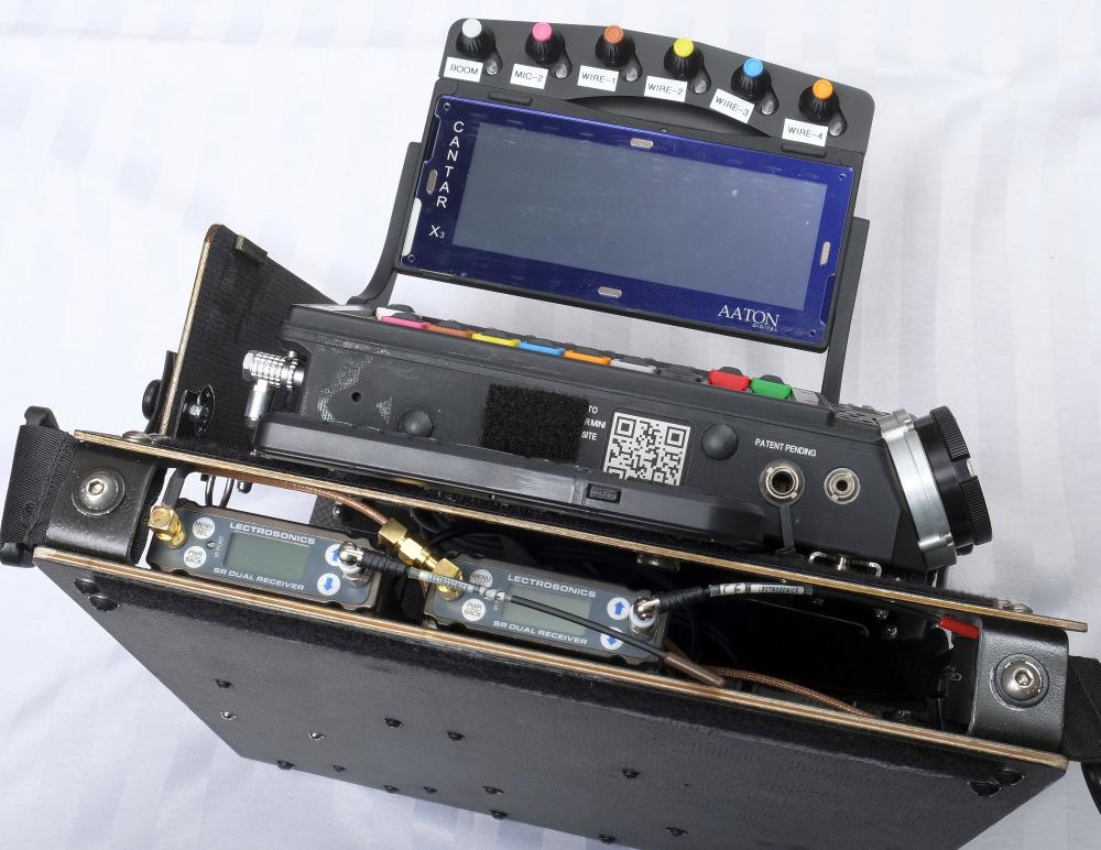

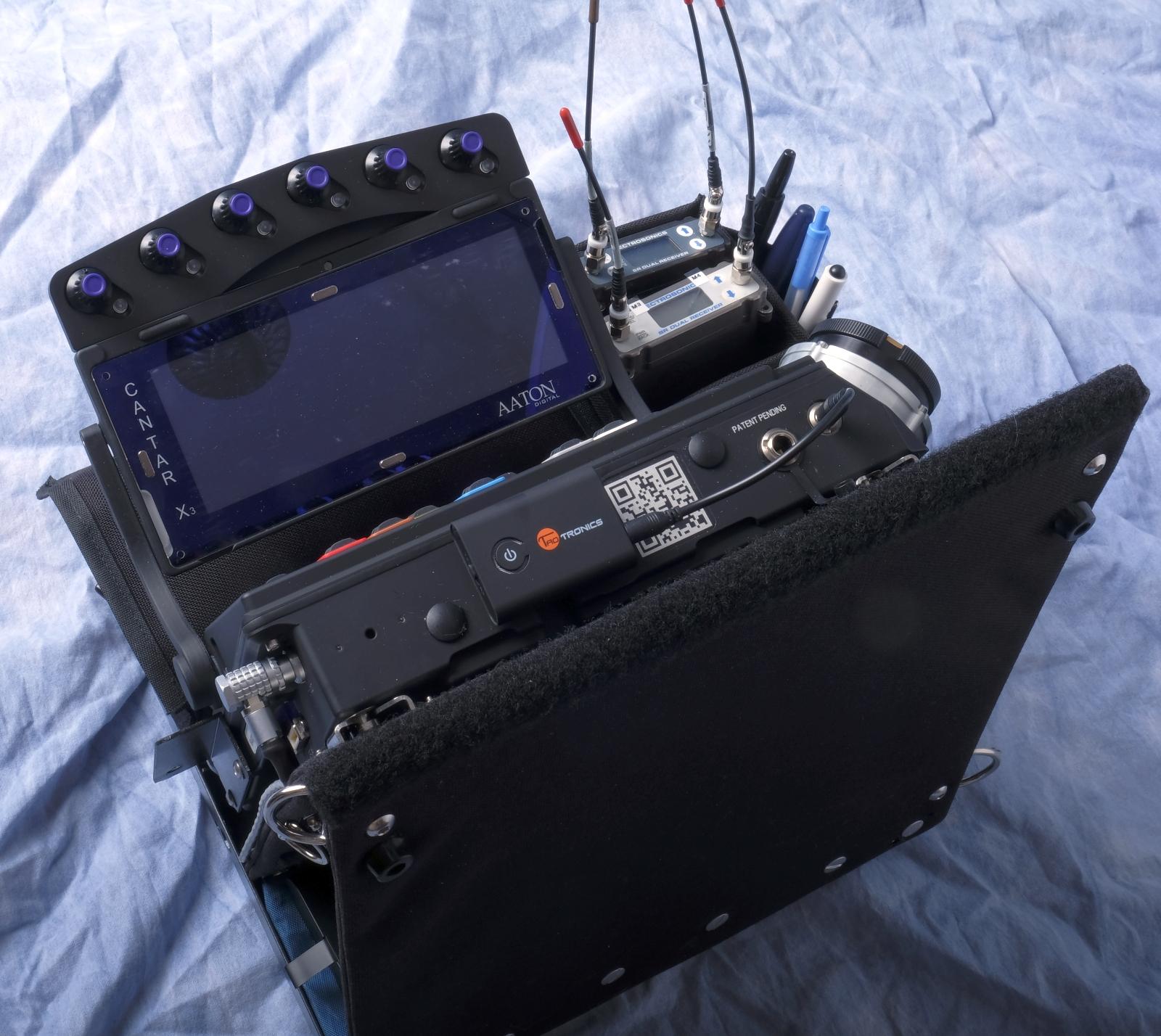

drpro Posted December 4, 2019 Author Report Share Posted December 4, 2019 Version 3 of my quest for a Cantar Mini bag. This one weighs 2.4lbs/1.1kg. The fabric is Dyneema. Only weighs 5oz/145g per square yard. The space between the operator and the back of the Mini will house three Hydra sockets for Lectro SR receivers. Out of sight as the Cantar/Hydra controls each receiver. Antenna distro is my own version of pieces cobbled together. It has adjustable gain and a bandwidth covering A1 and B1. Hopefully this will help with desense of the receivers from transmitters outside of that range. If need be I have a couple of passband filters I can add. More photos to come. Quote Link to comment Share on other sites More sharing options...
Mattias Larsen Posted December 16, 2019 Report Share Posted December 16, 2019 Is that a petrol/sachtler clip on the side? Can you find them separate somewhere, or did you harness it from another bag? Quote Link to comment Share on other sites More sharing options...
drpro Posted December 17, 2019 Author Report Share Posted December 17, 2019 Mattias those clips are available for other vendors. The trade name is Mod-U-Lox. Here in the US, a pair cost less than 4usd. Misspelled the name Mattias, it is "Mod-U-Lok" Quote Link to comment Share on other sites More sharing options...
Mattias Larsen Posted December 22, 2019 Report Share Posted December 22, 2019 Thanks a lot! Quote Link to comment Share on other sites More sharing options...
Tales Manfrinato Posted August 2, 2020 Report Share Posted August 2, 2020 Anyone had new and innovative ideas for a relatively practical and comfortable bag for the Mini ? About Protogear bags.. i find them really cool but they are mainly constructed with the receivers between the operator and the recorder. Considering bag-work and counting with all that awkward front surface with the headphone output, I feel that this arrangement makes it harder to manipulate the faders and see the display. And what do you guys think about the use of hydra making Mini's bags even more compact and almost turning the visualisation of the receivers unnecessary ? Quote Link to comment Share on other sites More sharing options...
drpro Posted August 2, 2020 Author Report Share Posted August 2, 2020 Tales, that has been one of my issues with the Mini. I liked the sloped surface bag I built which was version 2 for me. I have been using my version 3 for a while and it is ok. Been thinking about building another one, taking some of the ideas from the Aaton cheese plate design. What you don't see in my version 3 bag is the Hydra system. It is under the cover closest to the body. Three receivers. Two are in use, the third one I am waiting on the Melody preamp to allow the third receiver to work on the AES input. Included is two RF preamps and a RF distribution system. Once I have a Melody in hand I plan on seeing it I can reduce the size of the bag and lighten it some more. The Hydra system I believe can be made smaller, which will help. My RF system is cobbled together from various pieces. My thoughts are to only use one side with RF bits and the other would just be the antenna on each wireless receiver. David Quote Link to comment Share on other sites More sharing options...

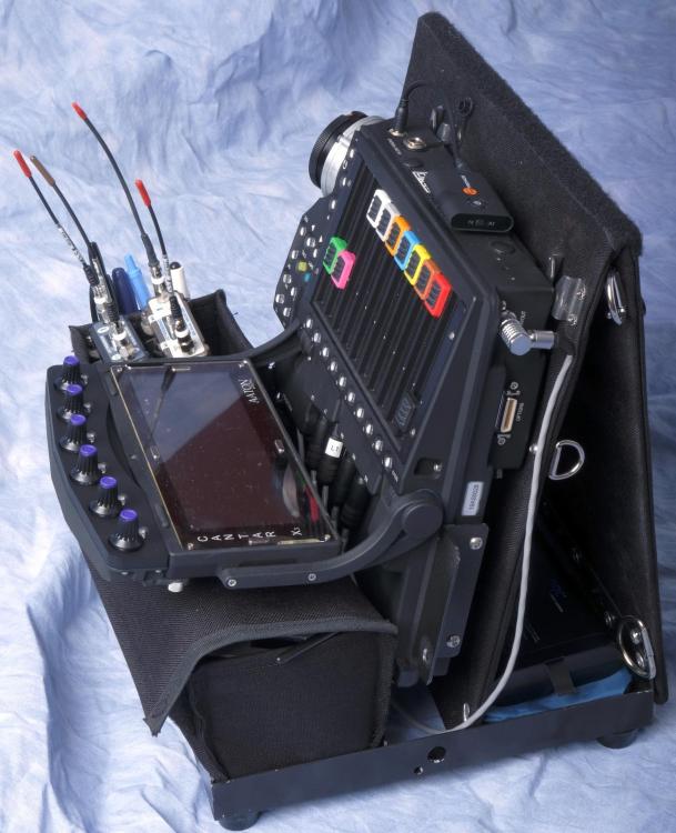

drpro Posted December 11, 2020 Author Report Share Posted December 11, 2020 So version four bag/holder has been up and running for a couple of months. Still waiting on the Melody II preamp from Aaton, so that I can add the third SRc in the empty space. I really like having the Mini on a slant. The display is viewable in both vertical and horizontal positions. Everything I need is inside of the wedge. Antenna distro, TC, Hydra system, power distro using an eSmart type of battery. Space on the the two smaller vertical panels to add pouches to hold hop transmitters and a space to clip a Comtek transmitter. Very thin birch plywood, laminated with carbon fiber, plus some aluminum for brackets. The carbon fiber may offer some RF shielding against stray emissions from the Mini. Total weight without gear installed is about 1kg (2.2lbs). Cost of materials including the Aaton clips was around 350usd. Labor well...... Quote Link to comment Share on other sites More sharing options...
Neil Bliss Posted December 11, 2020 Report Share Posted December 11, 2020 very nice! Where did you source the mounting plates for the Mini's front feet? Quote Link to comment Share on other sites More sharing options...
drpro Posted December 11, 2020 Author Report Share Posted December 11, 2020 Contacted Aaton and bought a couple. Pierre handled the transaction. Quote Link to comment Share on other sites More sharing options...

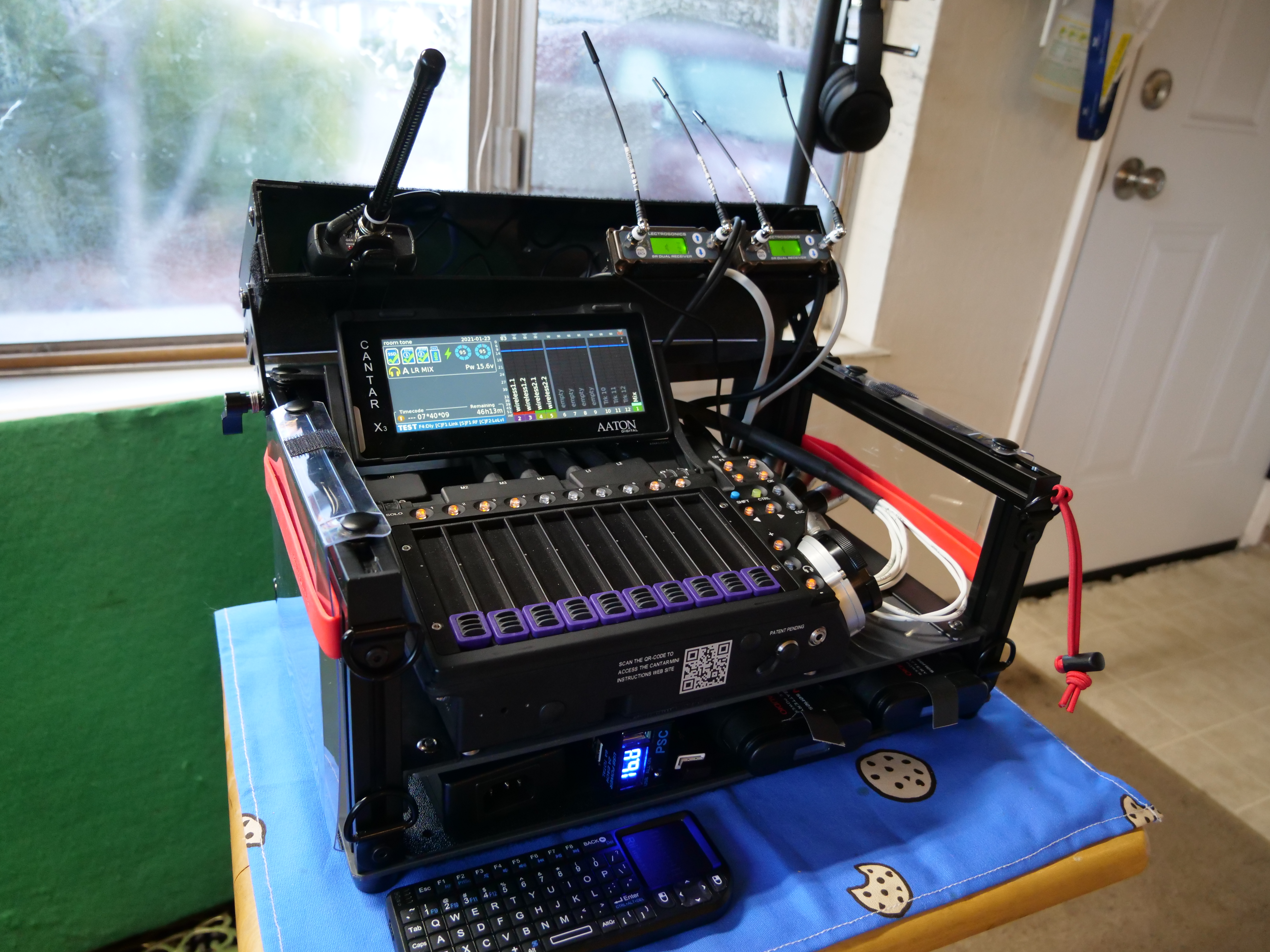

Neil Bliss Posted February 1, 2021 Report Share Posted February 1, 2021 Not quite as fully DIY as David's version, but here's a mod I've put on the still-in-development Mixercage for the Mini. The cleats are from Amazon, originally for mounting a dartboard to the wall. Quote Link to comment Share on other sites More sharing options...
drpro Posted February 1, 2021 Author Report Share Posted February 1, 2021 Liking that rig Neil. The Amazon ordered cleats are definitely less expensive than what Aaton sells. The 8020 or similar is a nice way to go. Makes it easy to modify the rig. Going the route I chose does lock me in. David Quote Link to comment Share on other sites More sharing options...
Neil Bliss Posted February 1, 2021 Report Share Posted February 1, 2021 I've gone through a couple iterations so far with Daniel at Mixercage on this setup, I think there's still a couple more iterations before it'll be a line item in his catalog. Quote Link to comment Share on other sites More sharing options...
Neil Bliss Posted February 2, 2021 Report Share Posted February 2, 2021 Just to show the overall installation with the Mini, extra batteries, and Hydra controlled SRcs. Quote Link to comment Share on other sites More sharing options...
