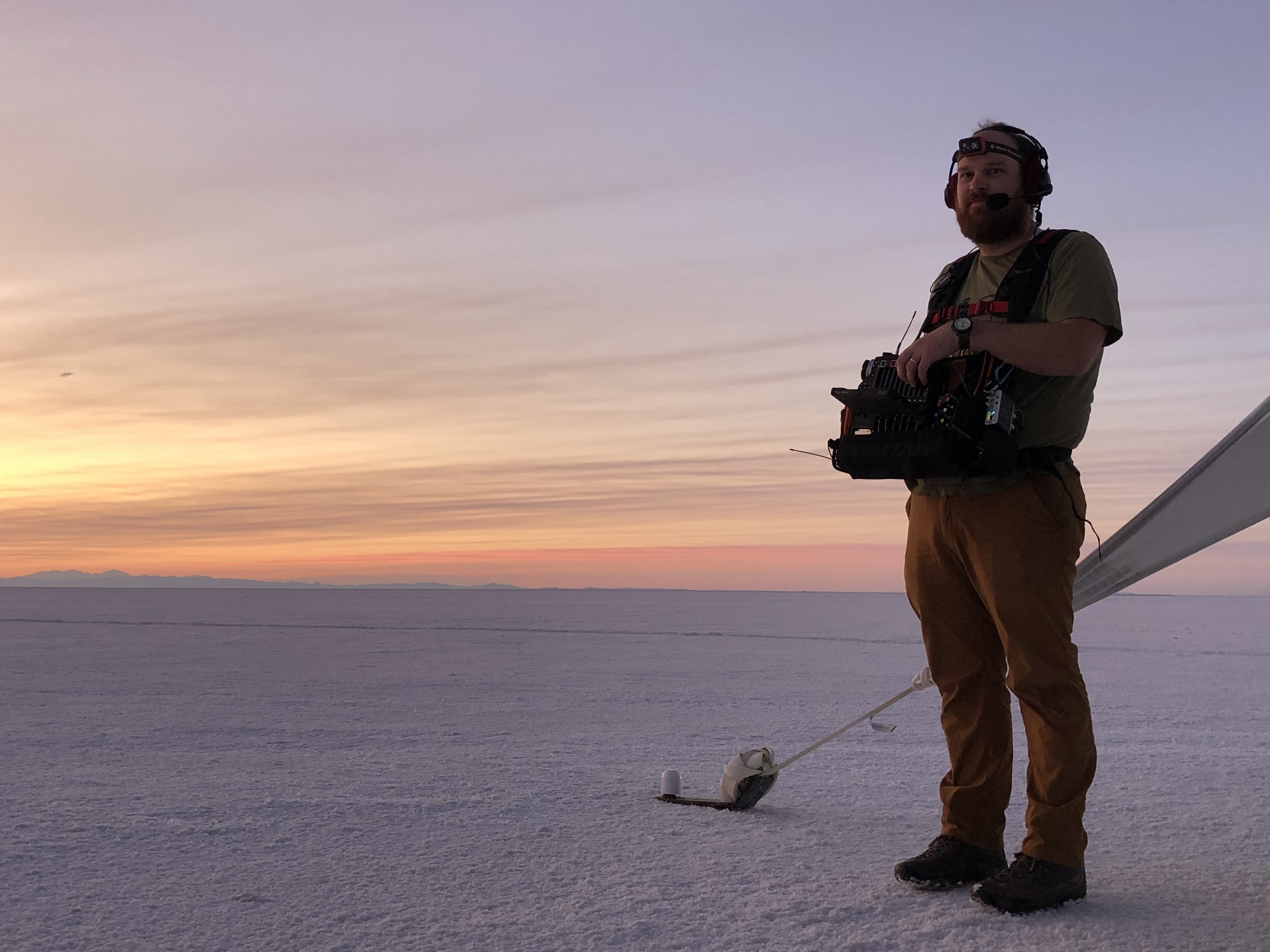

ryanpeds Posted April 9, 2021 Report Share Posted April 9, 2021 8 hours ago, johngooch said: Ah-- of course-- from the previous posts of this thread... should have just looked back a few months... Here is the bigger question-- with a wedge type rig-- can you do a bag job actually using mini over the shoulder.... 9 months into Cantar mini- and i am still wondering if using faders while using the recorder on the shoulder is a practical thing. Don't get me wrong-- i love my mini- and am thankful i've made the switch. I wouldn’t boom and use the Mini bag OTS, although I have done it. Much better deployed when you have a boom op and just need it OTS for portability. I’ve included 2 pics from a day I did on the Salt Flats. My bag is not wedge style but a flat Protogear bag. Quote Link to comment Share on other sites More sharing options...
