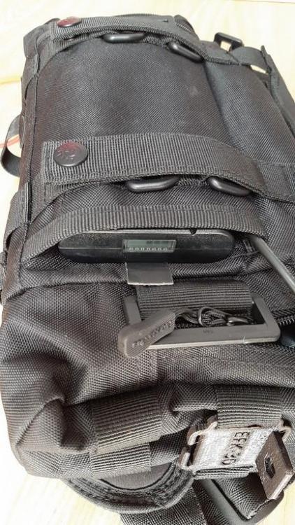

Thank you rado i am inspired... Front pouch for hi q batt works perfect
This below was my previous rig that i thought was compact Whoa what a difference

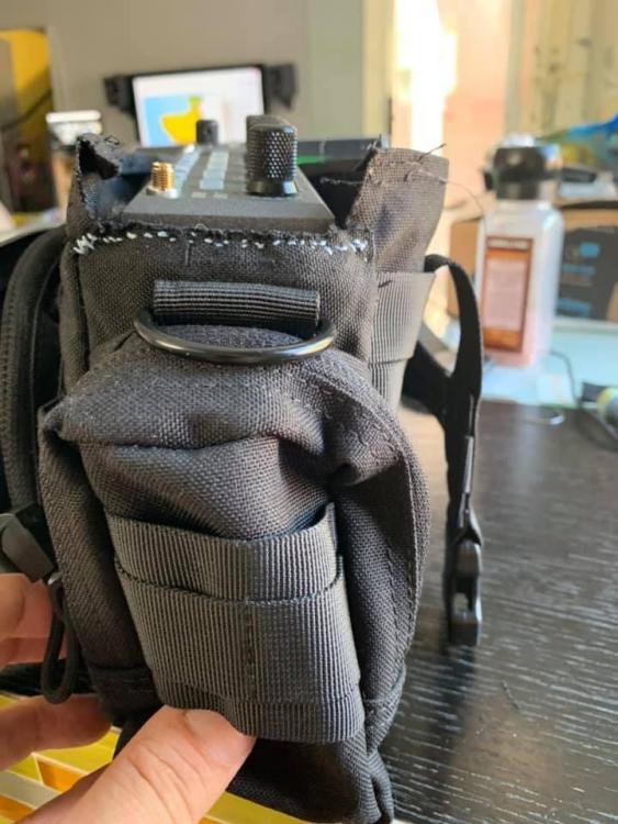

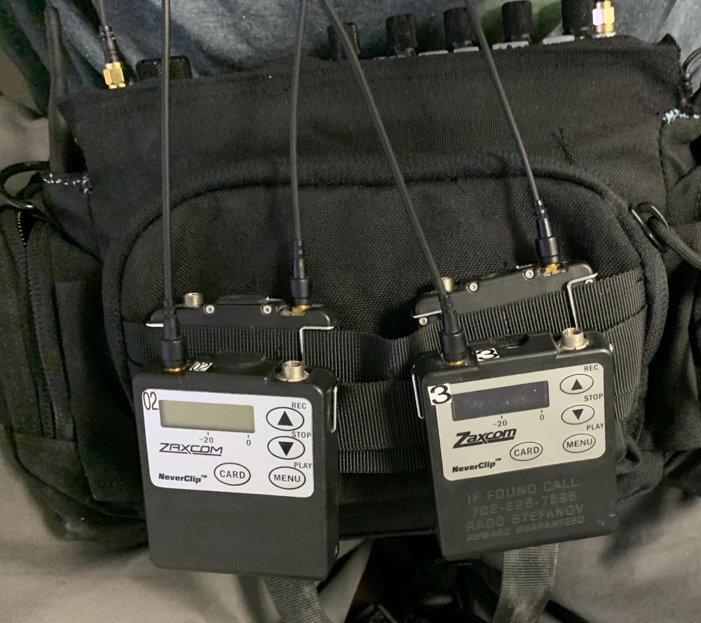

After a week of using my modified Condor bag, I'm happier with it the I expected. Honestly I thought it might be a bit of a stop gap bag but I think I have it to a point where it's the right compromise between super light weight and functional.thumbnail-9.jpeg
A few people have asked what mods I made so here goes. First off my wifes 20yo sewing machine died so I had to go out and buy a new one. Luckily a found a heavy duty Singer on sale for half price. I'm self taught at sewing so I'm sure I did most things the hard way and nothing is straight or perfect.
First off cut out the zipper and most of the top material, leaving enough to raise the side walls approx 5mm and sewed ribbon around the top.
I then cut out the mesh pocket from the back interior wall and used that mesh to make two small pockets to go inside the side pockets to hold a Zaxcom LTS on the right and a G3 on the left. For the G3 pocket there is a snap lock in order to open the mesh pocket and be able the door on the G3 and turn it on and off with out having to pull it out of the bag. Also burnt a small hole in the top of the side pocket for the antenna to stick out. On the interior of the pocket I added a small elastic loop to hold the cable out of the way.
Sewed 3mm Neoprene wrapped in felt into the interior base and rear wall of the bag to add a little padding and stability. Unfortunately velcro on the Nova didn't really hold to the felt so had to add soft velcro to rear wall. There is also soft velcro sewn into the top the front wall.
Cut out the wall between the side pockets and the main compartment in order to get to cards, connectors etc.
I like to have a pen and sharpie handy, so added a double elastic loop in the front pocket to hold them. While the front pocket is small it's still large enough to hold 3 or mr ZMT and a Countryman case with a few lavs and a small contingent of accessories.
At first it bugged me not having a secure way to hold the cans when not in use so i sewed a loop on the top left hand corner that has a Nite-eze locking carabiner (cut off the locking thingy) to hold the cans. could be used to hold tape or something else light.
The way I configured the bag, I found the D-rings/attachment points put a little more pressure on the Zaxnet antenna then I was comfortable with so I removed the D-rings and added smaller plastic D-rings (From an old Petrol LED strip) closer to the back wall but still on the side and at the same height. This had the added bonus of enabling me cut out another inch of the interior wall between compartments.  Also added D-rings at the bottom of the bag as I found the bag bounced around to much if you needed to run. That could also have a bit to do with my over forties belly. thumbnail-1.jpegthumbnail.jpeg
Weather/dust cover. Needs a little redesigning.
Lastly the material O-rings/attachment points on my Orca harness so as to have top and bottom clips with out the need of the waist section. I leave the harness attached to the bag and put the whole thing on at once kind of like putting on a shirt or how I used to do it with my old petrol harness. To be honest its not quite right. The bottom straps dig into my ribs slightly and the top straps could be a little higher.
Going to have a go at building my own harness. Between the local scrap material store and all the straps and buckles I've built up over the years I reckon I could probably do it for under $10.  This may be pushing my sewing limits but hey it will be an adventure.

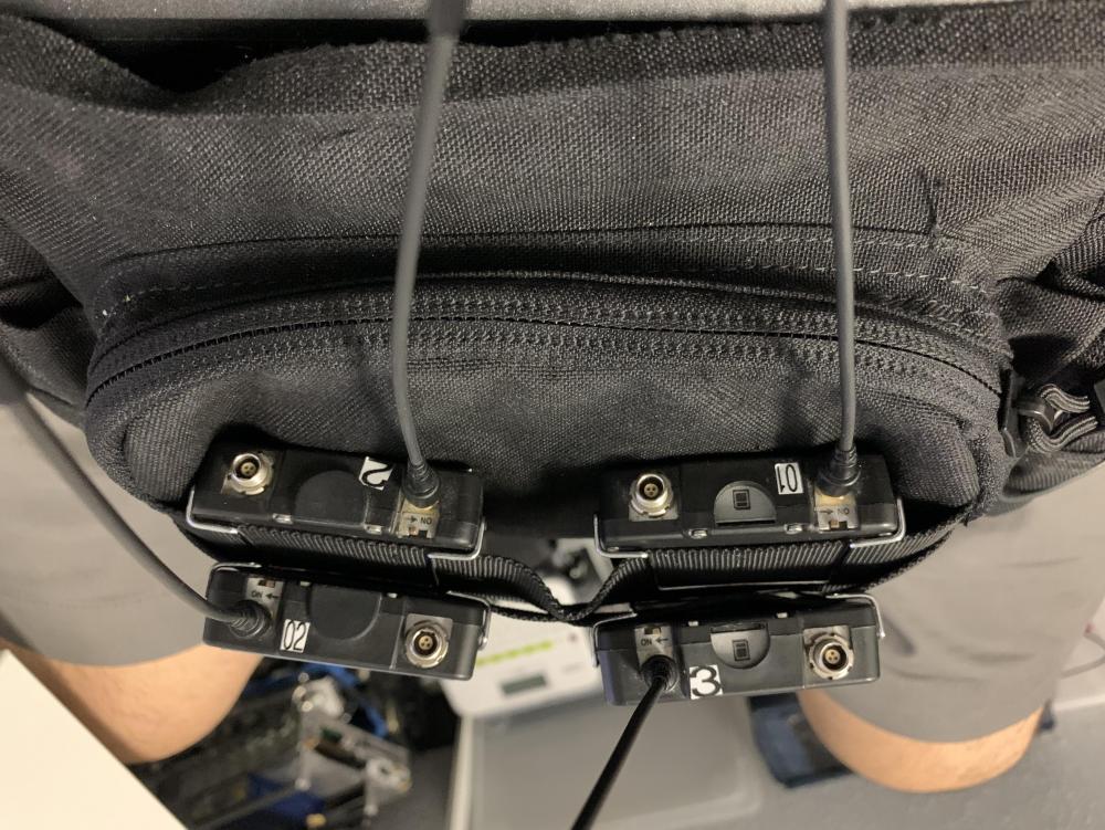

nate that is amazing. Beautiful work. I am completely sold on this condor mod as it is forcing me to rethink everything as light as possible. After using it for weeks even my harness is too heavy. I can never go back to k-tek n orca now i am all in
i dont have your sewing skills but my mod i just completed in my hotel room while traveling of all things - i went to a fabric store and got 2” black elastic and trimmed to fit folded around the top opening. I used black rivets and black rubber washers to secure it. 1) it trims where i cut the zipper out from the top a lot nicer and 2) it gives elastic stretch around the top to add extra tx rx bits

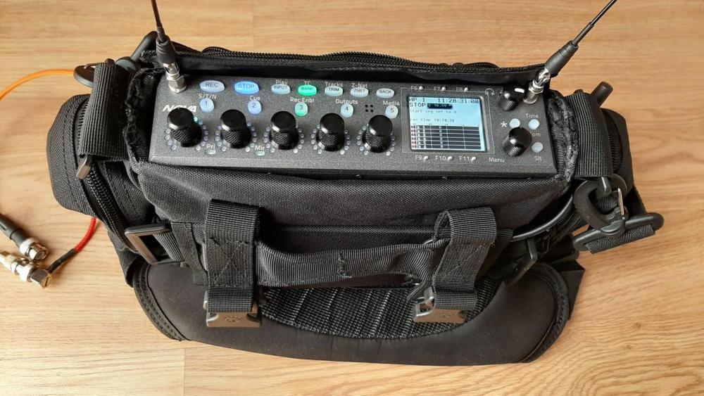

Got a similar Condor bag from Amazon , since the Condor is a bit more difficult to buy in Europe
Had to do the described mods as well , it seems maybe a bit smaller don't know than the original Condor, but found out that it has this useful flap at the back that can hold an esmart battery perfectly :-)

Being in Germany I see both this and the original condor bag listed. Both looks slick to be honest. I might be looking to create something similar for a Mixpre 10, been looking closely at the bag sizes and it looks like this should be about 1 cm taller in the main compartment. I also like how you have done with the smart battery here, how does it feel to wear? And how are you with the original condor bag dealing with the battery? Front pocket?
I think I saw that someone else ended up putting a battery behind the Nova to get the faders a bit more accessible in the other bag.
The original condor looks like it might have more water resistant zippers, but maybe the difference is minimal?
Any of you don't happen to have a Mixpre to put in the bag to see what it looks like? It should be about 2 cm taller than the Nova so might not be as snug fit, but maybe one could raise the edges with excess fabric and sewing on thicker edge band in a similar way as Nate did.
