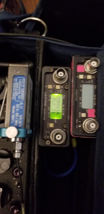

I am somewhat new to lectrosonics but I bought these used and I cannot get them to pair. I have scanned frequencies with the receiver and I know they're both on the correct frequency.
Compatibility is on 400
Is there something I am doing wrong?

Ah, I'm joking with yah.  Your pic isn't giving us too much information to work with.  Show us the sides or a pic of the units on the same frequency.  There's people in this forum who could tell you absolutely everything about these units with just a serial number.

Since you reference SMV L, not a specific block, please ensure both are listed as the same block.  If one unit is block 470 and the other is block 19, there is a possibility that they are set to the same frequency (for example, 487.000 is available in both block 470 and block 19) but will have different pilot tones and therefore not pair properly.  If this is the case, you can make them work together by turning off the pilot tone.

Yeah so it was 400 on both and when I called lectrosonics they had me bypass the pilot tone to try and get them to pair.  When we did this the receiver just. When sending whitenoise into the recorder.  I tried a few different channels and nothing changed.

Just making sure you have the transmitter all the way on to transmit (turn on by holding AUDIO and FREQ buttons for 3 seconds - you'll see the count-up). If in RF OFF mode, it should say that in the display.
Do you have access to any other Block 21 transmitters or receivers to isolate the problem to one or the other unit?
