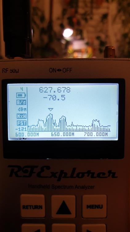

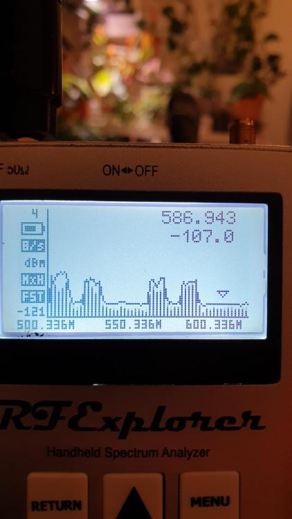

Mattias Larsen Posted December 6, 2020 Report Posted December 6, 2020 On 11/30/2020 at 6:04 AM, aksanaom said: Does anyone know what blocks are good in Berlin? Here is a scan from the other day close to Ostbahnhof. Quite typical, so I think there are quite a few gaps in any given block most of the time, but have a few to pick from or wideband to be safe. I run in the 600mhz range at the moment and can usually make space for a few channels, not sure if anything else is worse or better (well the free space in 800 is defenitely more dodgy, but that is to be expected) and some locations are just bad. Quote
