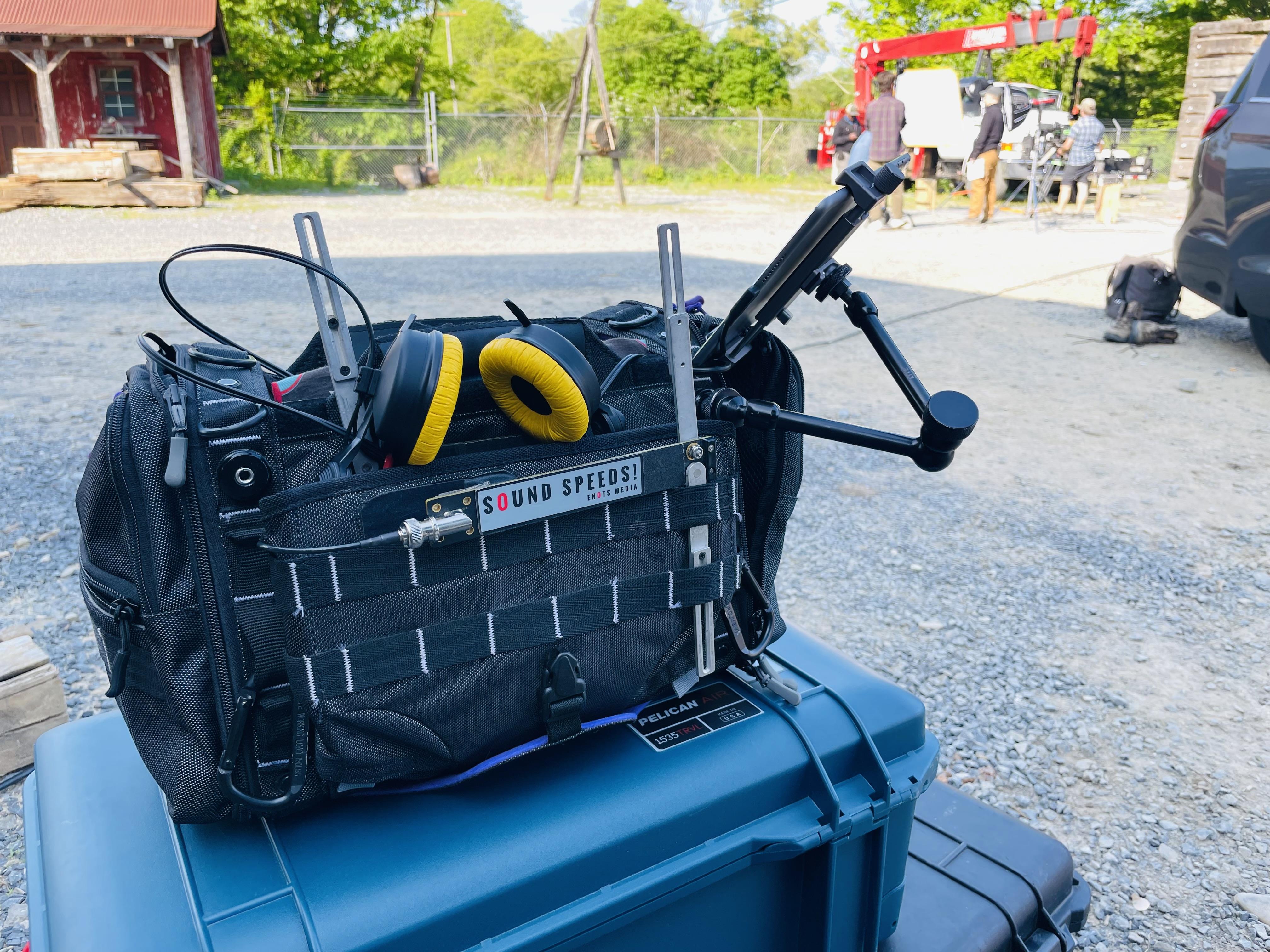

EnotsMedia Posted June 9, 2023 Report Posted June 9, 2023 I have not used the Bowties…but to me they seemed too large (shape wise) and clunky for my bag setup liking…I’ve been using the SNA600a’s for years in the bag and love them. Small, slim, fold up nice for travel. Here they are in my bag, - I know ideally they should be further apart but they work absolutely great in my bag..absolutely zeros issues. I also use one on my cart Comtek feed w/ the Remote Audio antenna upgrade and it’s just as awesome. 883/SL2/DSR4 (x2) Quote
