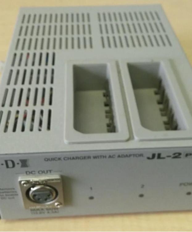

bcopenhagen Posted August 30, 2021 Report Share Posted August 30, 2021 On 8/25/2021 at 4:01 AM, EnotsMedia said: and that the old JL2 charger works to charge them. How old is your JL2 charger? There are two versions of the JL2Plus: 1) the newer is blue or dark grey with a plastic chassis 2) the older is light grey with a metal chassis (looks like a mini version of AL4 or KL4). See photos below. I’d love to know if charging is totally successful on the older one. Thanks! Quote Link to comment Share on other sites More sharing options...
John Blankenship Posted August 30, 2021 Report Share Posted August 30, 2021 8 hours ago, bcopenhagen said: How old is your JL2 charger? There are two versions of the JL2Plus: 1) the newer is blue or dark grey with a plastic chassis 2) the older is light grey with a metal chassis (looks like a mini version of AL4 or KL4). See photos below. I’d love to know if charging is totally successful on the older one. I use both chargers with the NP-L7S and not had any issues with either. Quote Link to comment Share on other sites More sharing options...
EnotsMedia Posted August 30, 2021 Report Share Posted August 30, 2021 I have two of the JL2-Plus chargers (Blue) and they work great and this was a big selling point for me when upgrading my batteries to the NP-9X. I know “of” the older grey style IDX NP1 chargers but thought it was NiCad only, I do not know if it’s compatible. My assumption would be if it’s has “JL2-Plus” on the chassis (Grey or Blue model) it should work. According to the note on IDX website… https://idxtek.com/products/np-9x “NP-9X is still compatible with all current accessories and chargers like the JL2-Plus” but when in doubt give’m a shout! Quote Link to comment Share on other sites More sharing options...
bcopenhagen Posted August 30, 2021 Report Share Posted August 30, 2021 As Mr Blankenship said, the original JL-2+ is perfectly capable of charging the lithium chemistry NPs (I also use the metal-chassis version for my 68Wh batts). So it follows that the Np-9x can be charged on any version of the JL2-Plus. I had actually called IDX before I posted, but I was hoping for real-world feedback on an older JL-2+. Coincidentally, so was IDX. They wanted to know how it goes if I tried to charge on the older JL because there was a concern that a timing circuit in the metal-chassis version would cut off charging before higher capacity of the NP-9X can be reached. The update from today (from the headquarters in Japan) is that all versions of the JL-2+ should work, ie, no timing cutoff. Pretty important on the road BUT … (“everybody has a big but”) … some versions of the KL4 may have this “inconvenience”. The NP-9X won’t reach full capacity in a single charge cycle. In THEORY (I’ll know in a couple days if it was actually tested at the mothership), the LED on the charger bank will blink when the timer cuts off charging before full capacity of the NP-9X is reached. The battery needs to be removed and re-inserted to kick in another charging cycle. That would kinda be a dealbreaker for me if that were the case on my old JL-2Plus: if I was on the road, and had to re-plug the batteries in the middle of the night. Though I also have the KL4, I usually use it in a “supervised” environment (on set or at home). With a 2-week road job coming up, I think I’ll take the plunge. The 888/SL2 combo is real slick, but it’s definitely hungrier than a 633! Quote Link to comment Share on other sites More sharing options...

Peter Mega Posted February 13 Report Share Posted February 13 On 8/31/2021 at 4:03 AM, EnotsMedia said: I have two of the JL2-Plus chargers (Blue) and they work great and this was a big selling point for me when upgrading my batteries to the NP-9X. I know “of” the older grey style IDX NP1 chargers but thought it was NiCad only, I do not know if it’s compatible. My assumption would be if it’s has “JL2-Plus” on the chassis (Grey or Blue model) it should work. According to the note on IDX website… https://idxtek.com/products/np-9x “NP-9X is still compatible with all current accessories and chargers like the JL2-Plus” but when in doubt give’m a shout! I have both the older grey and newer blue JL2 Plus chargers and 6 of the new NP9X batteries. I can confirm the older grey JL2 Plus chargers are compatible and fully charge the NP9X batteries as well as the newer blue JL2 Plus chargers. If it has JL2 Plus written on it, then it works. Cheers Quote Link to comment Share on other sites More sharing options...
